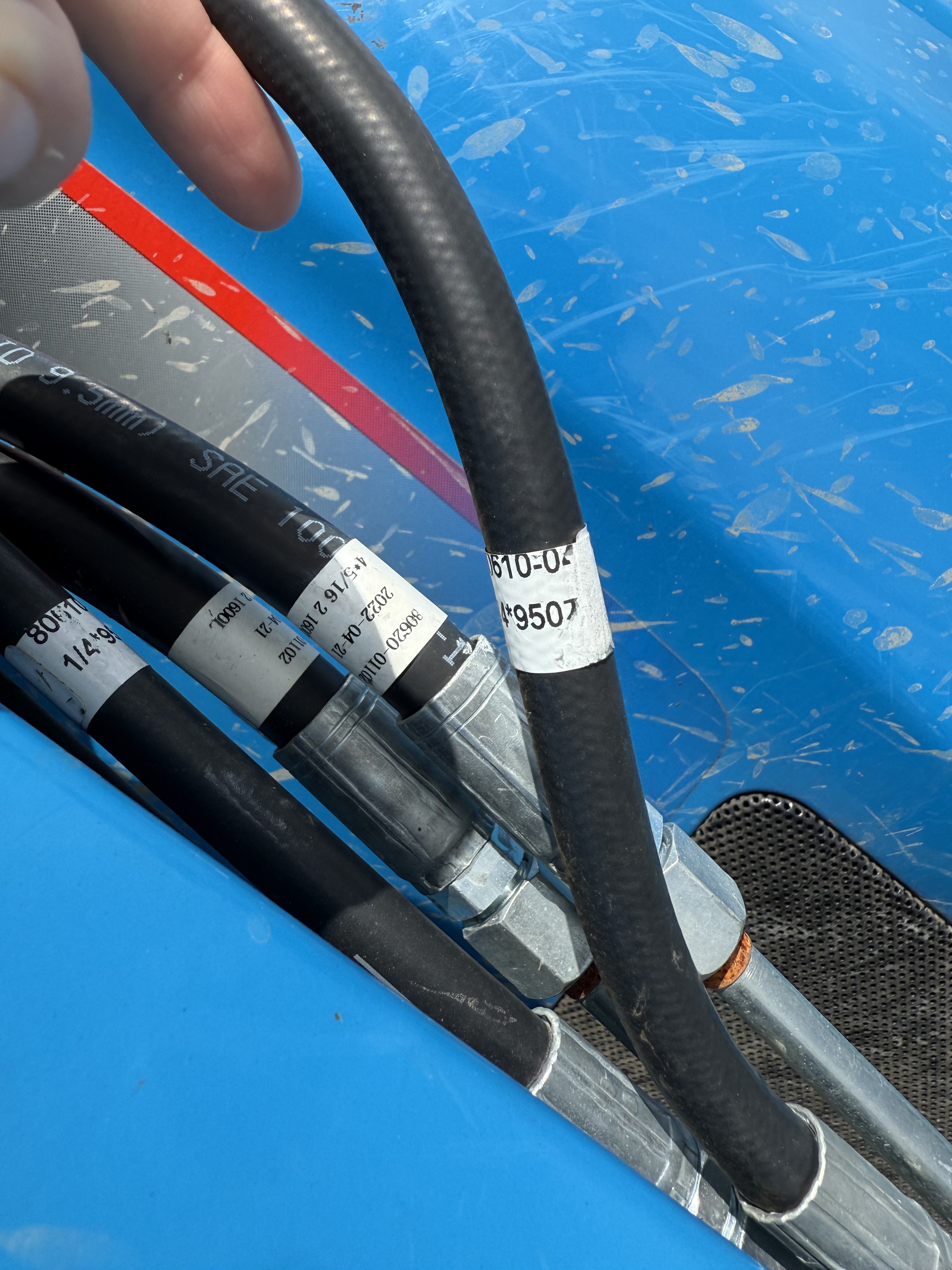

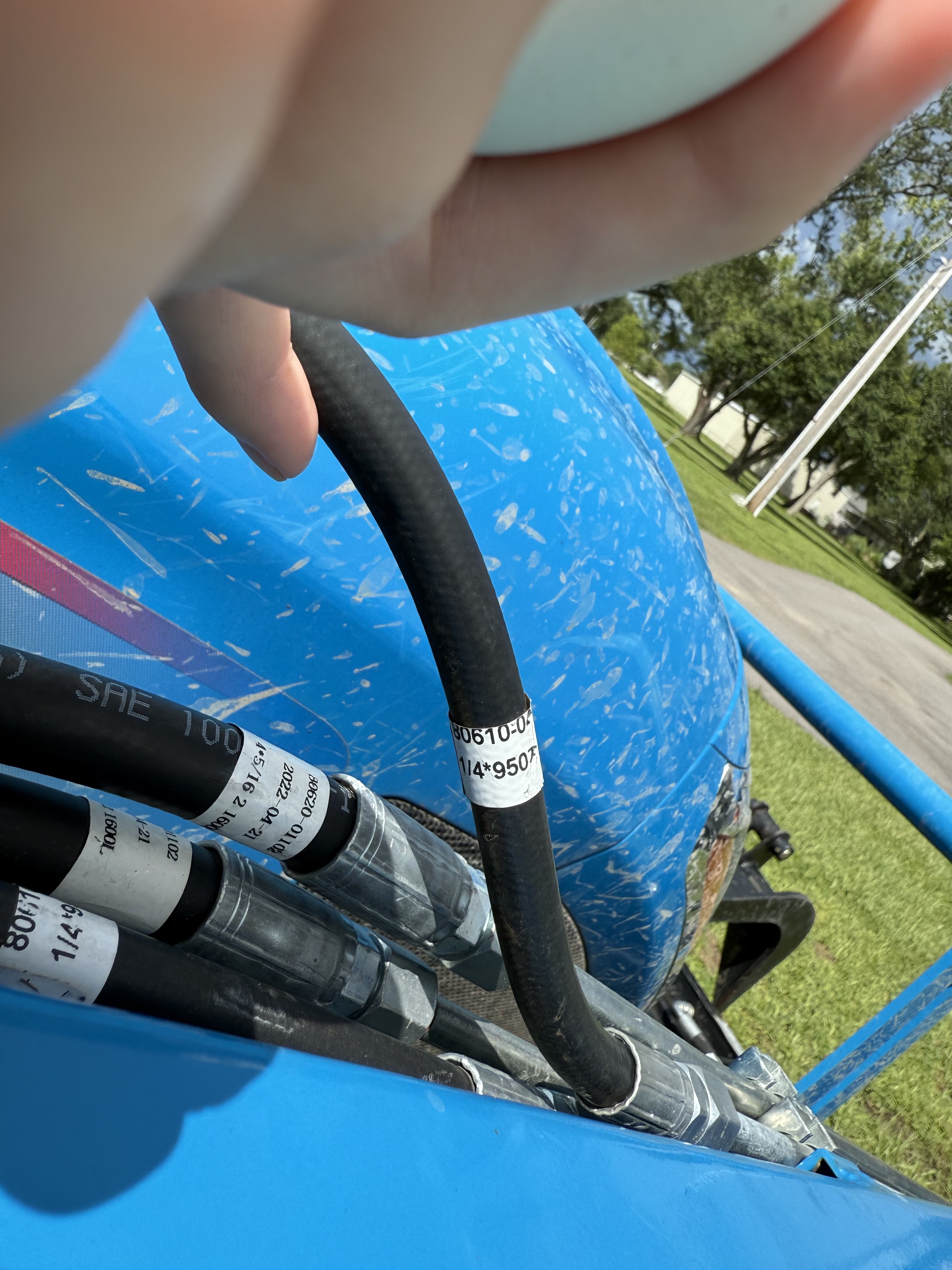

I need to replace this hydraulic hose that has a split and is leaking. Can someone tell me or provide a link for exactly what I need? Google image search isn’t helping. IMG_3229.jpegIMG_3228.jpeg

Or go to Parts - LS Tractor USA
click on Look Up Your Part
Then navigate to you loader model (looks like a loader hose) and find the part you need and pay dealer price.
Note is you had MT to the front of the LS part number it becomes the New Holland part number and any NH dealer can get it often better prices than LS Dealers.
/ Hose ID #4
Does it have markings on the hose like the one behind it that says 9.5 mm?

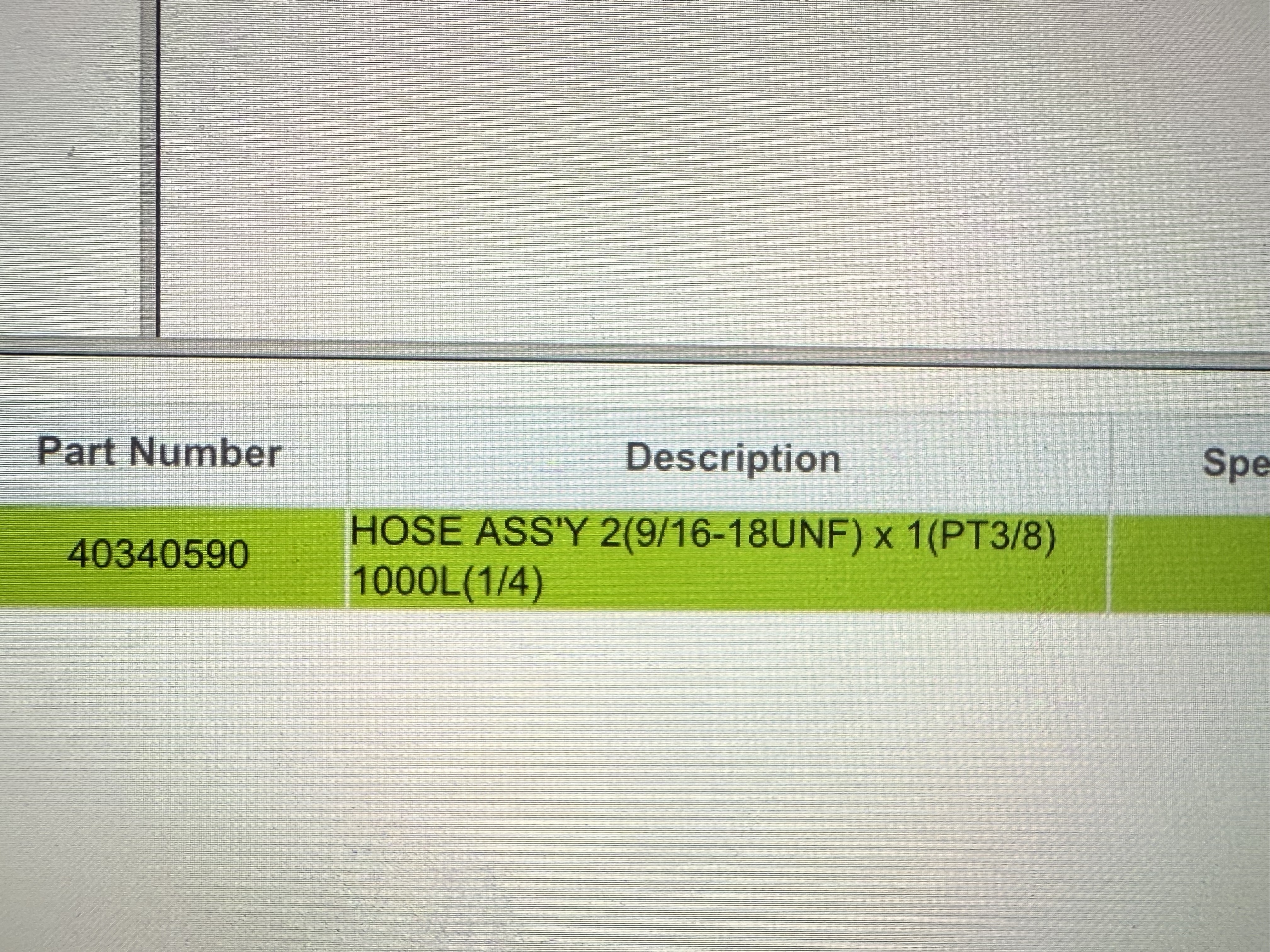

Pretty sure this is the part. Was hoping to find it online or an equivalent to have some extras on hand. IMG_3231.jpeg
/ Hose ID #7
Some of the auto parts stores in my area will make a hydraulic hose while I wait. I just bring in the bad hose, and they make a non-leaky one just like it.
I have found the prices to be similar to ordering from the tractor site, with no waiting.
