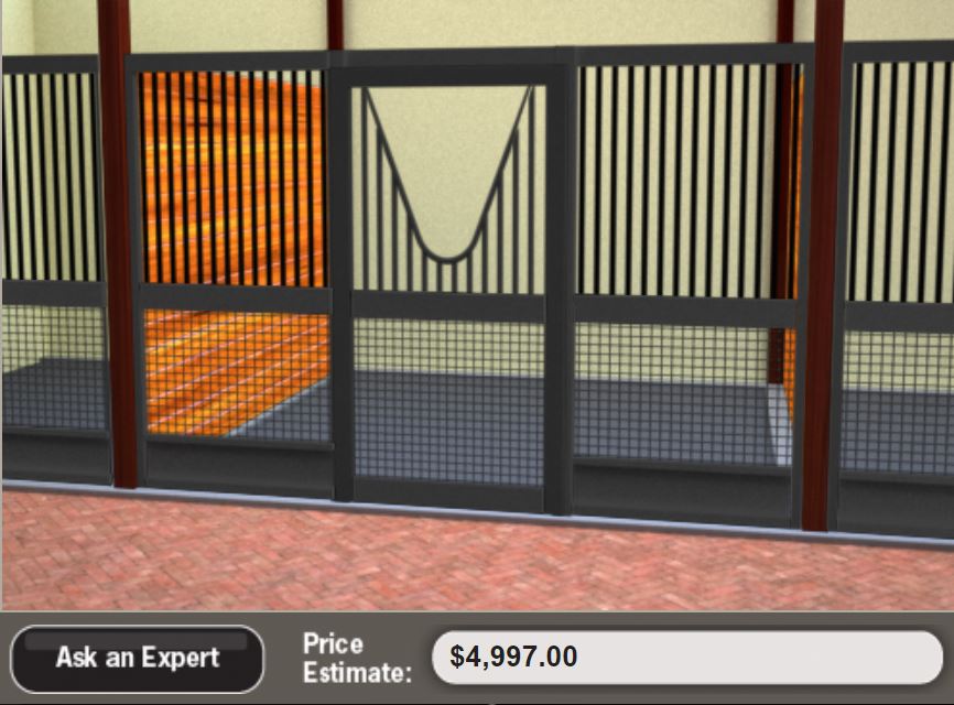

We are building a barn, and a large portion of the cost is the stalls. And on this barn, I'm looking at 14 stalls.
I've done some looking, and they are all over the map from relatively inexpensive but certainly functional wood to high end metal. We are more on the Metal side of the spectrum.
I am looking to put in 2 panels and a sliding door. Total dimensions of the front will be 14' with a centered 4' door on tracks. I like airflow and visual access to my horses, and most of the barns we have been seeing have been a variant on what I have pictured below. It just seems that they are VERY EXPENSIVE for what I am getting. I'm not a welding expert by the least sense of the word (I aspire to be a novice) but after getting quotes from $3500 to $6000 per stall front, I began thinking that perhaps this is a job which I could take on myself. I've looked at many MANY doors and fronts, and when I think about it, they just don't appear to be that involved. That could certainly be the novice in me talking, which is why I am here asking you.
Each panel would be about 5' wide. The panel structure would be 2x3" rectangular tubing around the periphery 2x6" center cross member. The mesh is 5/16" bar on 2" squares, welded at each crossing. It is welded to the inside center of the frame, not just stuck to one side or the other and welded, so the fit obviously has to be perfect. The door would be basically the same but only 4' wide. There would be a roller/slide along the top to move the door.
I know there would be material costs. I know there would be paint costs. But I just have a hard time believing they would approach $5-6K per stall front. I was thinking I could use the difference and invest in a big welding table and build a jig. Buy a good coldcut saw, etc etc etc and by the time I was through, I would have some really nice equipment and a much better welding skill, and still come out $$$ ahead. But... I don't know, hence I am here.
This might be far more than I can handle, and I am just testing the waters at this point. But, I'd like your thoughts.

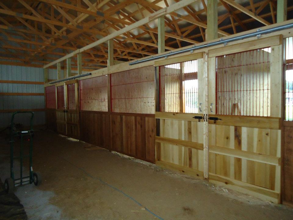

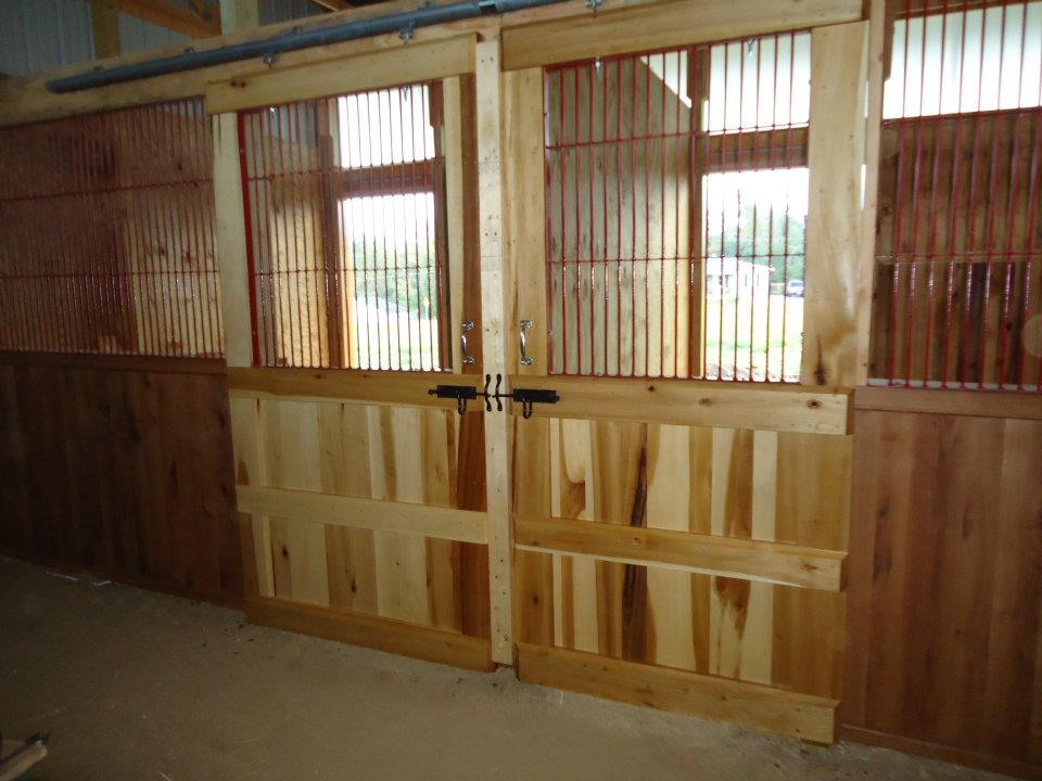

I built these back in 2012. Copies of the same stalls I built in my other barn built in 2000. Sold that place, and moved back to the home place, after my parents passed.
The top portion of the stalls are made from 1/16" X 1-1/2" flat strap, and rods are 3/8", 2" OC. I built the wooden portion first, then measured open spaces, and built to fit. I simply stacked the strap, tacked on the ends, so they would not slip, then drilled the holes, with a drill press. I slipped the rods in, then ground the welds off the ends, then separated the flat strap, roughly to the distance I wanted them apart. I started at the top, then worked to the bottom, getting the heat set, and being it's a Lincoln 120V unit, wanted to see how many welds I'd get, before the duty cycle was up, and keep the crappy weld out of sight. I'd measure on the ends for the distance I wanted, then used a piece of 1-1/2" X 1/8" angle iron for a straight edge, to keep them straight, and clamp in place. I'd weld a while, then work on the next set of laterals for a while, letting the welder cool. I welded tabs on the top, to bolt into the door rail header, and just drilled holes in the rest of the frame, to lag screw into the posts, and top of the bottom half of the stalls.
I have to agree with the horses kicking the bottoms, and/or getting hurt on them thrashing around at times. But, mine are open to the outside, so they can come and go as they please, out into the paddock area. Was always afraid of a fire, so wanted it so they would not be trapped, if the needed to get out. In the Summer, both horses will be in one stall, swatting flies off each other. So, there can be some thrashing around at times.
The doors are made of #2 Poplar I got a deal in several years back. I planed them to 7/8". They are 3 layers thick on the frame, and a single thickness panel in the lower center, with a filler piece, and cap across, for strength, in case one of them kicked the door. I ship lapped the center panel pieces, with a 3/8" overlap, so there would never be a gap, with the humidity change, and also for extra strength. Walls lining the stalls are the same 7/8", ship lapped Poplar.
Doors are pretty heavy, and about all I wanted to set up there by myself. But, hung them on Cannonball track, and I can open & close them with 1 finger.
If I remember right, I had about $325.00 per stall in materials. But, as I said, I got a great deal on the Poplar, for .30 per BF several years back. And, it had been stacked & dried, ready to use for several years.
The bottom fronts are made of 3/8" White Oak, nailed to 2"X6" purlins laying flat, running horizontal. The Oak was from what they call "thins" at the sawmill. You could get these for .10 per BF. Anything less than 5/4 is called a thin. Many were 5/8 to 1/2" thick, and great for woodworking projects. So it wasn't that big of a deal to get them planed to 3/8". They are also ship lapped, and I used an air brad nailer to fasten them.
It was a lot of work, but like you, decided to build something myself. I'd do it again in a heartbeat...
