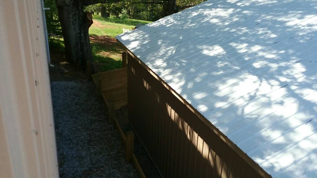

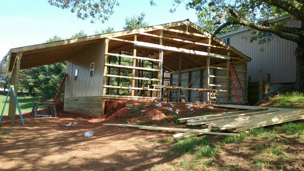

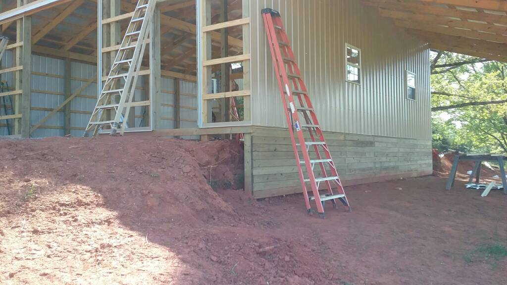

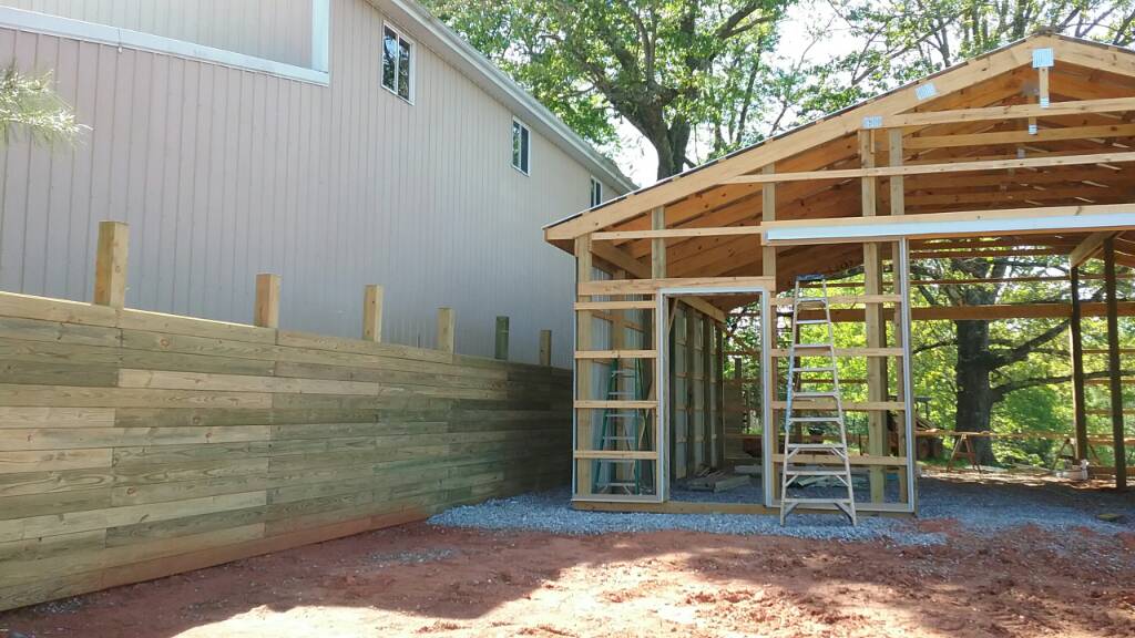

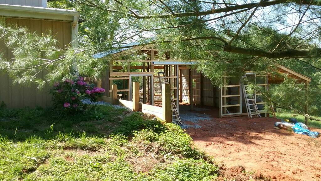

Here are few pictures so far...
It's going to be nice...but climbing price 20190501_154430.jpeg20190501_154338.jpeg20190501_154314.jpeg20190501_154231.jpeg20190501_150910.jpeg

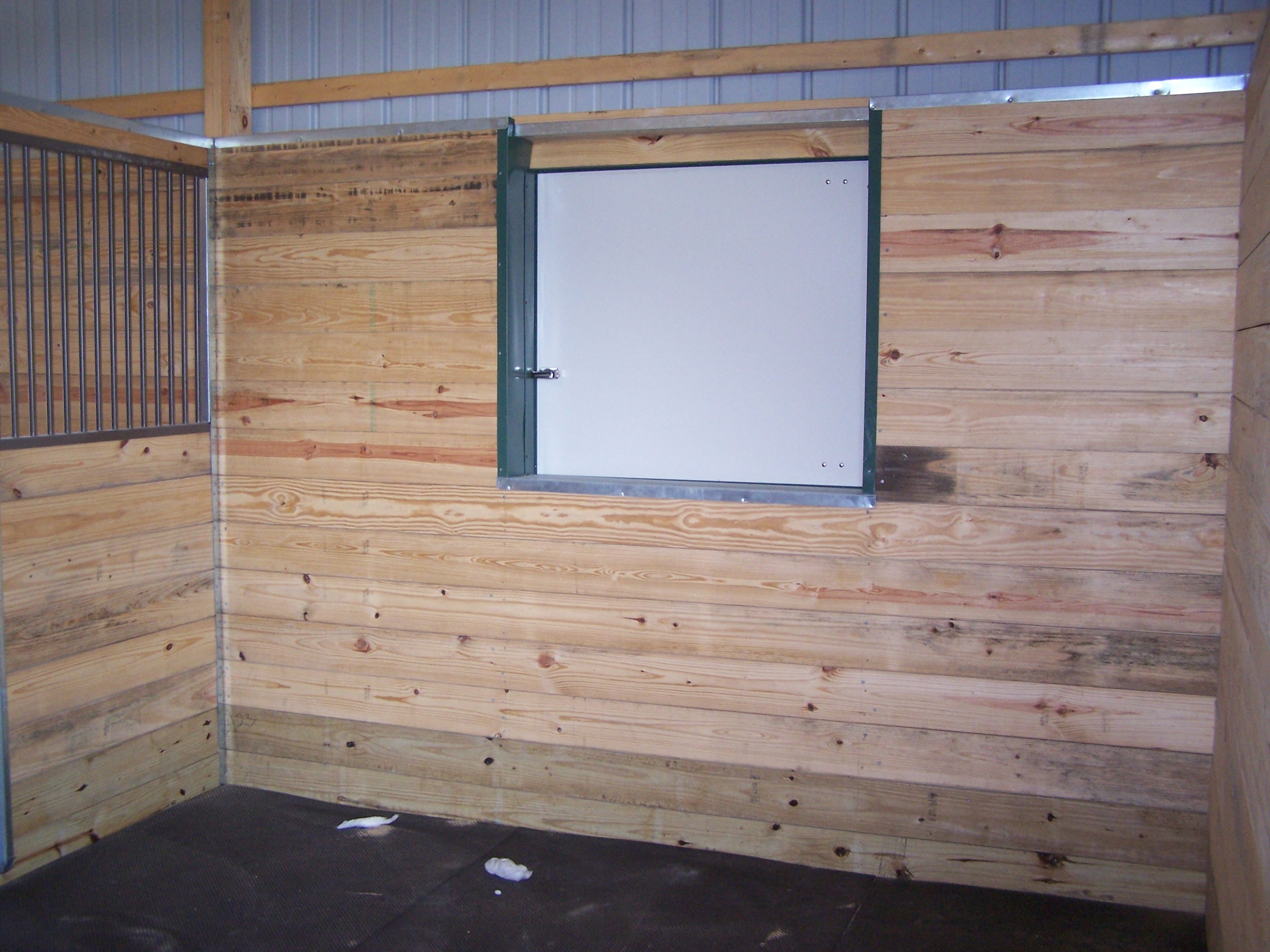

Concrete is bad for horses to stand on for any length of time, ruins their legs. Our barn was built by Morton so I trust how they said to build the stalls. Only the aisle and wash rack are concrete. The stalls have 6" of stone covered by 2" of sand, then mats. After the Morton mats wore out I replaced them with the 4'X6' mats from TSC. Two people can move them easy and I cut them with a utility knife & straight edge. They last 3-4 years before they start to tear. Our horses weigh 1400# to 1500# so they are rough on them. I use TSC fine shavings for bedding.
Before sand.
Finished stalls.
Center aisle with rubber mats for the crossties.
Our newest horse, 8 y/o 17.2 Oldenburg gelding, weighted in at 1300# here. He is up to 1400# now as he no longer jumps, just dressage.
