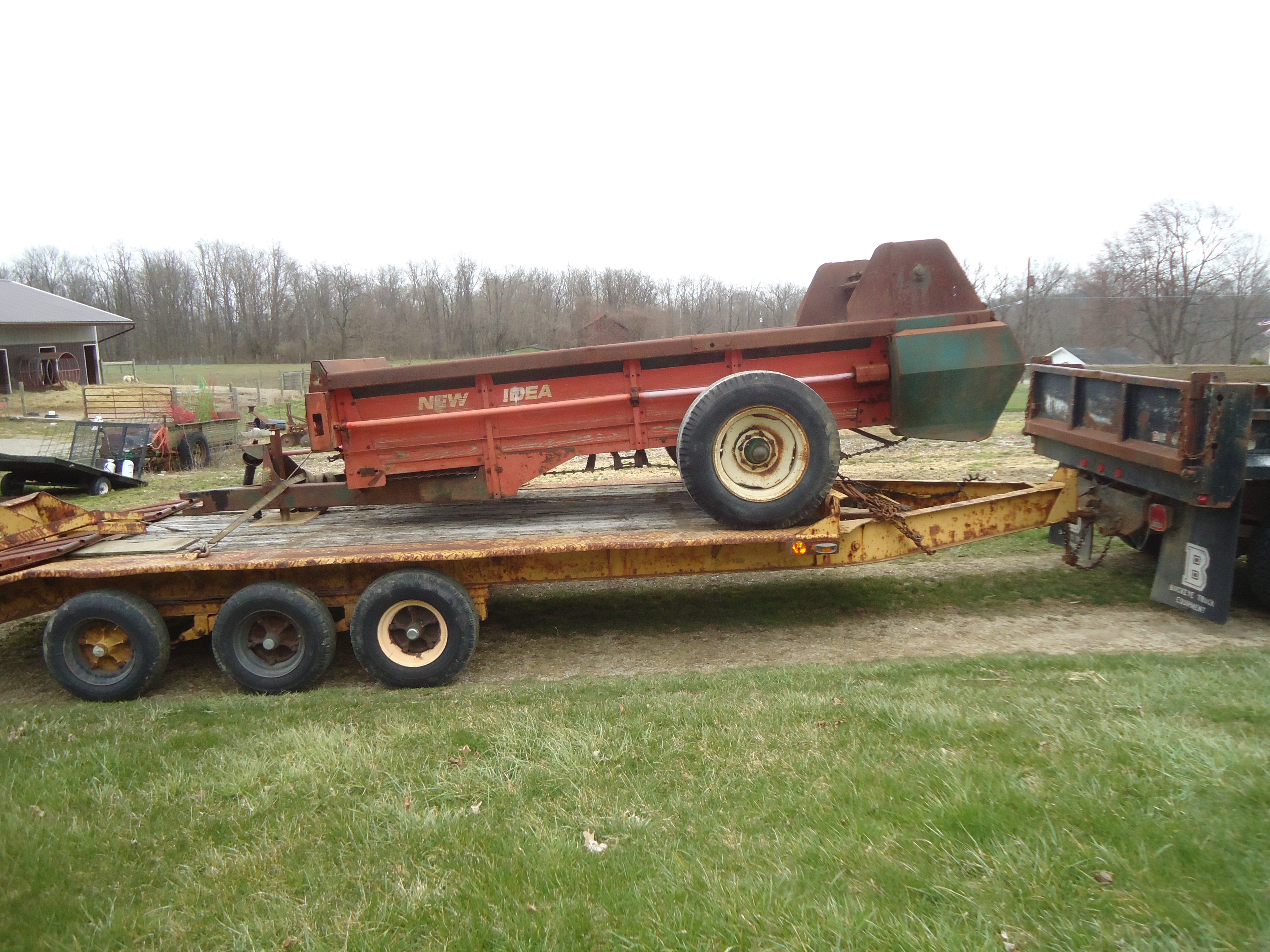

As far as a spreader, spend the money for a good spreader. More money well spent. Newspreaders usually only have 2 speeds. Fast, and real fast. If you compost the manure (I agree with that too) these newer lighter spreaders just aren't designed to spread that type of manure. I bought a new Pequea 80 bushle, single beater, pto spreader about 15 years ago. Nice little spreader if you're spreading fluff. Spreading composed, wet heavy manure, it would really make things hammer. And, I only loaded it level with the sides. It had 2 speeds as mentioned, fast, and real fast. Thesingle beater just didn't spread like what I was wanting.
I kept looking for a slightly larger spreader with at least 2 beater's, 3 would have been better. We had an old New Holland 3 beater years ago when we had cattle, and it di agreat job of tearing the clumps apart, and spreading evenly. 5 years ago, I found a New Idea 2 beater spreader, and it has I'm thinking 5apron chain speeds, and one more speed, that when tyou pull the rope for that last notch, it kicks the beaters out of gear, to do a final cleanout. I absolutely LOVE this spreader..!! I pull it with my Super C Farmall with ease, and load it as high as the bottom of the top beater, and it does a great job. It cost afew coins, but less than a new one, and was money well spent. I sold the 10 year old Pequea, and covered it's cost, so I flet pretty good about that, and got a heck of a deal on the Pequea when I bought it. Dealer's wife posted the price online, and I questioned the price before driving 1-1/2 hours to get there, I questioned the price again upon arrival, He had no idea what she'd put on it. Come to find out, it was $300 below his cost. I gave him the old "false advertising schpeel", and he did agree to sell it to me at his cost. He went to the office, and pulled the paperwork on it, and showed me his cost. I grumbled a bit, but bought it. It was right at $700 less than any other 80P's I'd priced, so it all worked out.
Here's a pic of the New Idea 217 I have now...
