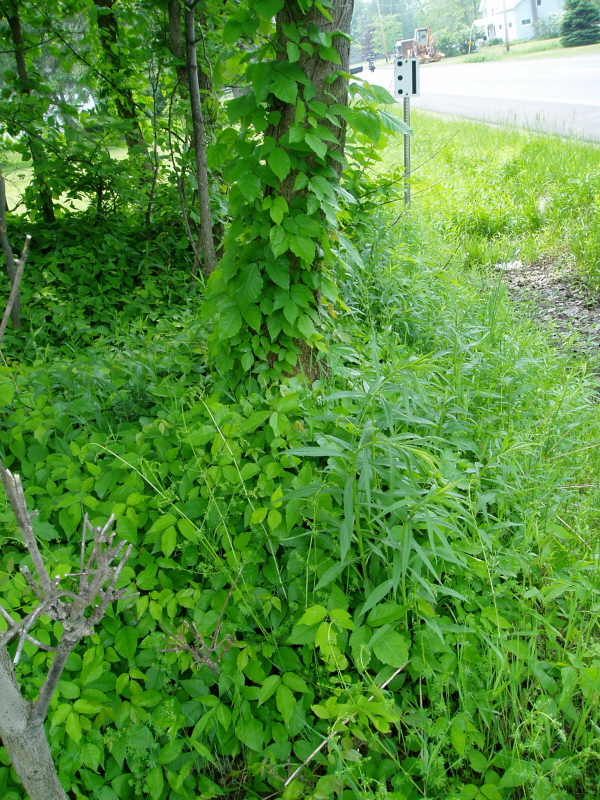

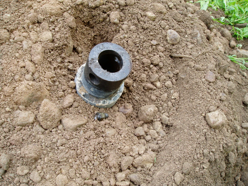

No project is without setbacks. I had some this afternoon. The first picture is poison ivy. It is very abundant along the treeline, and yes I think I got into it. Our new property is crawling with the stuff. The next picture is the 14" auger. I am setting corners and gate posts in ready mix, so I am using the big auger. There is a reason they have two bolt holes. I only had on in and new exactly what broke when I heard it go. The 3/4" pin supporting the gearbox took a beating too. The PHD is a little bit on the light duty side for this size bit. I end up making a new pin for there almost every time I use the 14" auger.

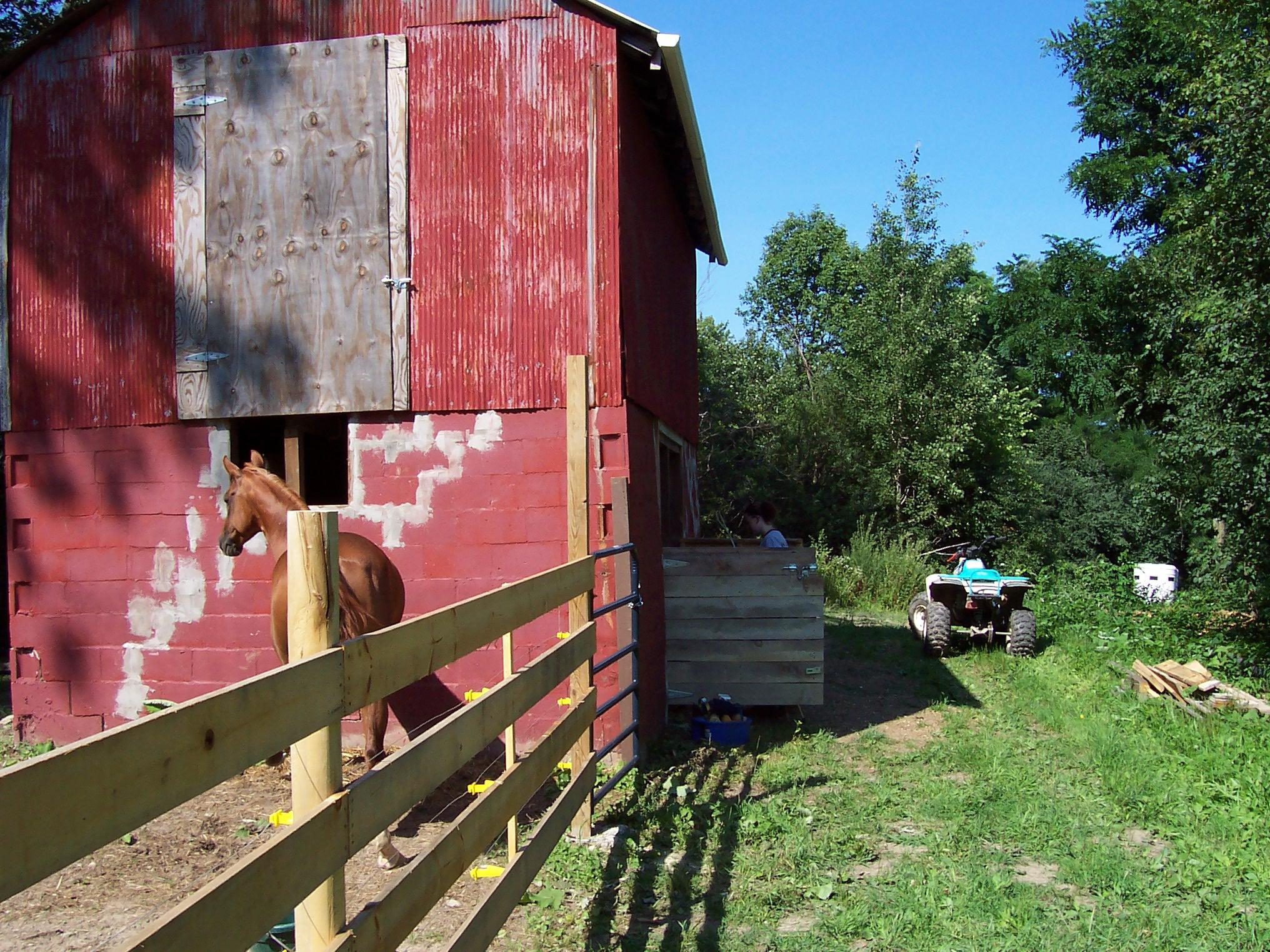

Nice project. When I built mine I installed electric on the inside so they don't eat the wood

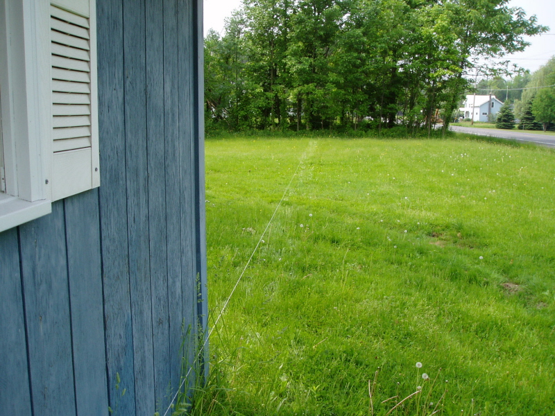

My thoughts exactly. You pictures appear to show very nice blue painted wood sideing on your buildings. If these buildings are part of your containment plan, Might I also suggest an electric line on standoffs(longer than their necks) along any building walls to help keep them from "cribbing" the sideing, particularly at corners and window/door frames.

That is a sharp looking fence. I have a fencer, I just haven't thought about wether or not I'll hook it up. The horse broke a window in last barn before I put the electric up.

I have a 4 yr old pony who gets mighty bored in the pen quickly. I didn't even allow them in until the electric was up. The rails on my fence are rough cut lumber, just a thought for money savings. I'm surprised you still don't have snow on the ground!!! :) How much did you actually get this winter?

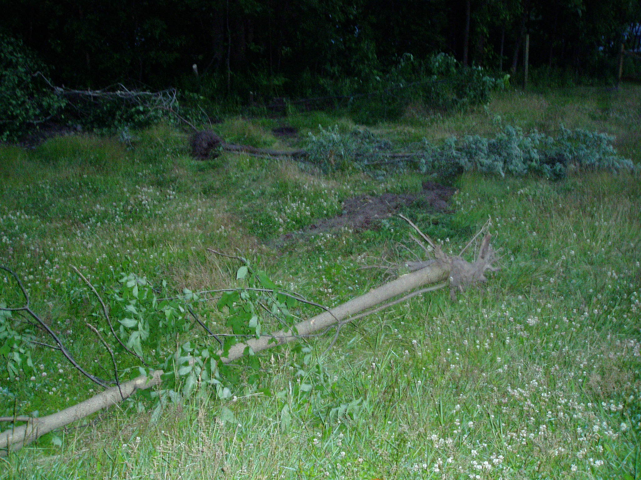

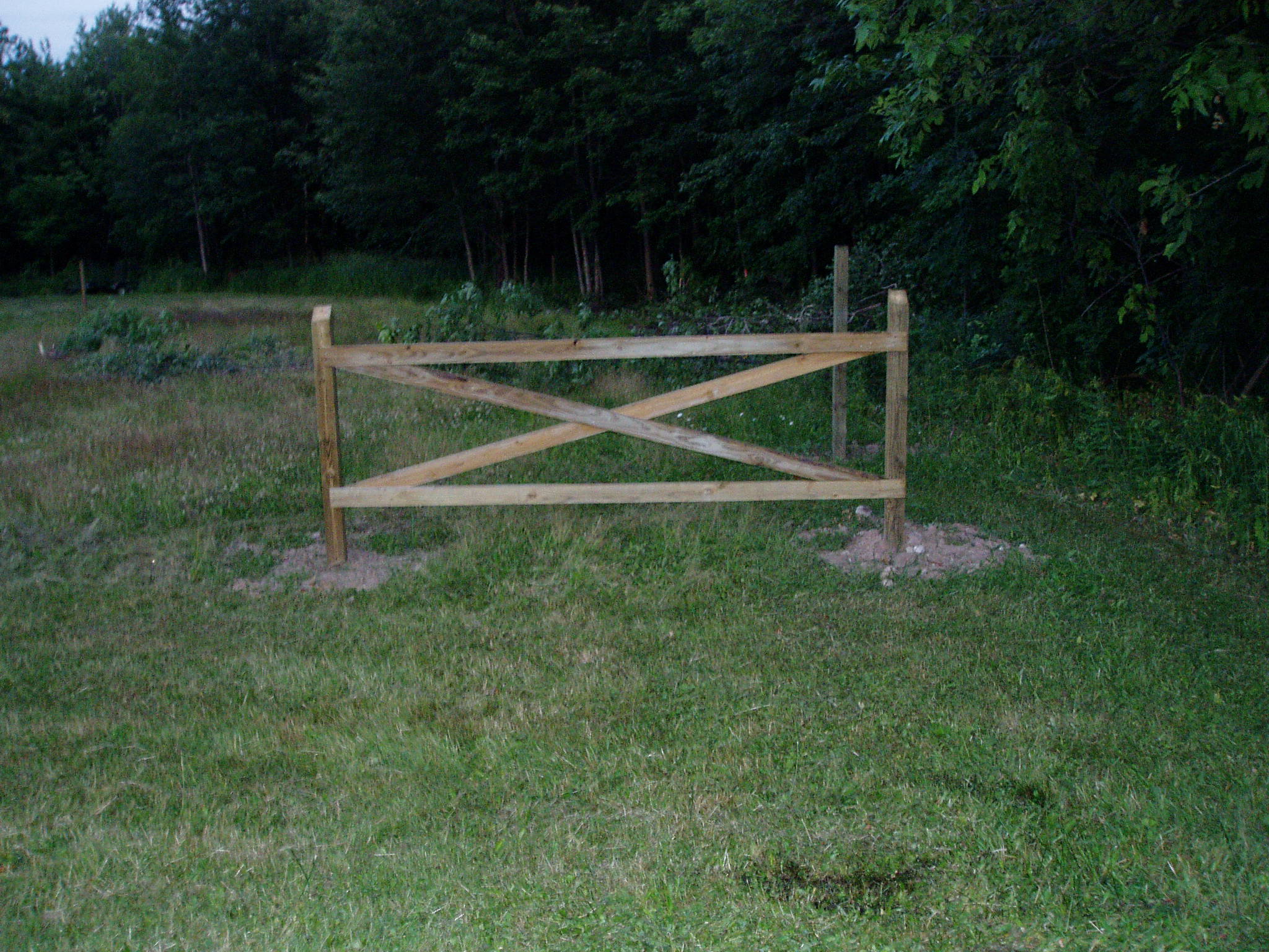

I think I've only gotten about 3 hrs to work on this project in the last couple weeks. We settled on an "x" pattern for the fence to be different than everyone within a mile or two on each side of us. I originally bought PT 2x4's to use as corner bracing, but decided to try it as rails and I like it. With the "x" pattern I won't need much for bracing in corners. Especially with 2 80# bags of ready mix in each hole on the corners.
I may try to talk the wife into a simpler 3 rail on the less visible sides (except near corners).

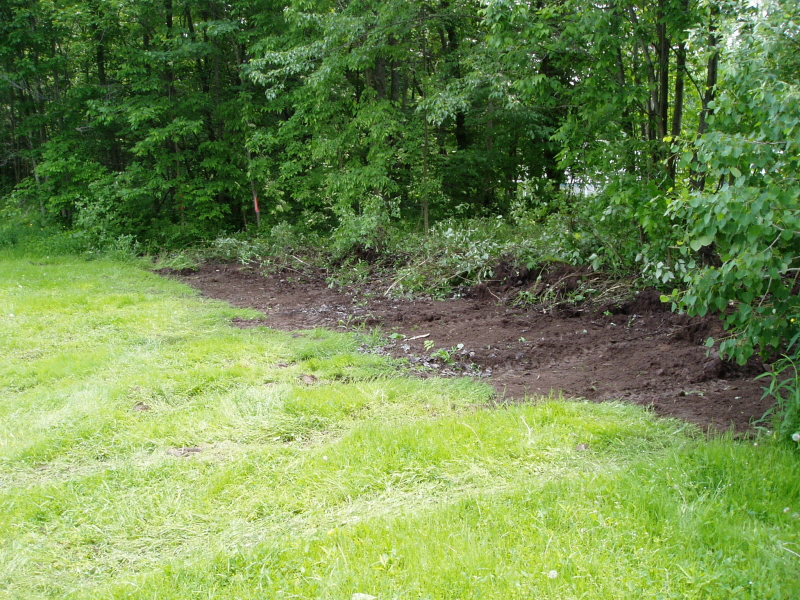

I had to clear some more of the hedgerow to get a straight line opened up for fence posts. I love ripping trees outta the ground roots and all!!
I have had trouble with several holes. One night I was 0 for 5. I couldn't get in the ground deeper than 6" with the 6" auger anywher I tried. The next night I was able to drill two of those holes after removing 3-4 stones each wieghing 10-20 lbs from the top 12" of soil at each hole location. I'd almost swear I put my fenceline right over an old stone wall or foundation.
PHD's may be the most frustrating implement in the world, If I was planning on doing a lot of fencing I would have to build a better mousetrap for sure!
