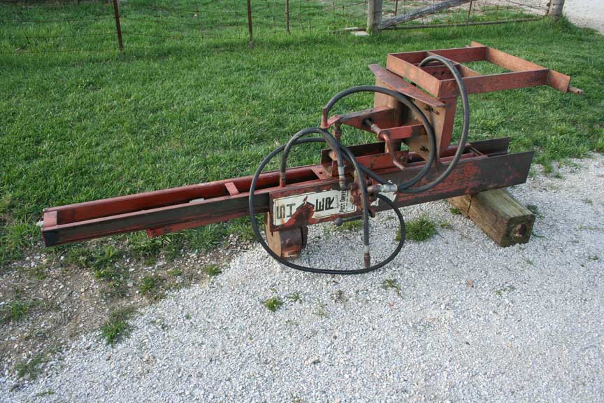

Wow! got any pictures?
/ horse fence going up #17
Here is the photo of my post driver. This photo was taken just after I purchased it. Before I could use it I actually had to buy springs as the previous owner broke the springs and never replaced them. Sorry I do not have any action photos I forgot to take the pictures. Later this summer or early fall as soon as we start getting lots of rain to soften the ground I'll be sure to take a few action pictures.
drrsg,
I almost killed myself trying to install the driver alone on my 3pt. Now it was lying on the ground as in the photo. I was so new to this I did not even have a road block on it and as you could imagine the whole driver portion would slide up and down depending on it's position. I emailed Shaver and they kindly sent me the owner's manual. I decided the best way to store it is lying down out of the way. To install it, I lifted the driver up with my loader and leaned it against a solid post and straped it there before unhooking the chain from my loader. Then backed up my tractor to the driver and hooked it up. Now I have only actually installed the driver once but I had no problems. Using the driver was a piece of cake.

wow, thanks for that video........I never saw a post driver in action, beside a huge pile driver. That thing looks like a beast. Kinda scary looking.

With the Worksaver post driver I have, the weight of the tractor is kind of irrelevant. The gpm of the hydraulic system is more important, but even then, the gpm determines how fast the ram rises. Dropping the ram is accomplished by dumping all the hydraulic fluid back into the sump which happens when you press down on the joystick.
I (just me, no helper :() drove 187 4" x 4" x 8' PT posts and 40 T posts with my NH TC25D. However, my post driver has legs the driver sits on both for storage as well as when driving, i..e, the legs support the driver not the lower arms of the 3ph which appears how the Shaver driver works. If so, it puts a lot more stress on the tractor. The Worksaver doesn't shake anywhere near as much as the one in the Shaver video.
BTW, I set about 6 posts using a post hole digger. No thanks. A driver turns a 2 step process into a one step process. I averaged about 15 - 20 minutes per post, which included tractor set up time. I also marked the ground where every post was going to go and laid a post at each mark. So all I had to do was drive to the mark, set up, drive the post and move to the next mark.
