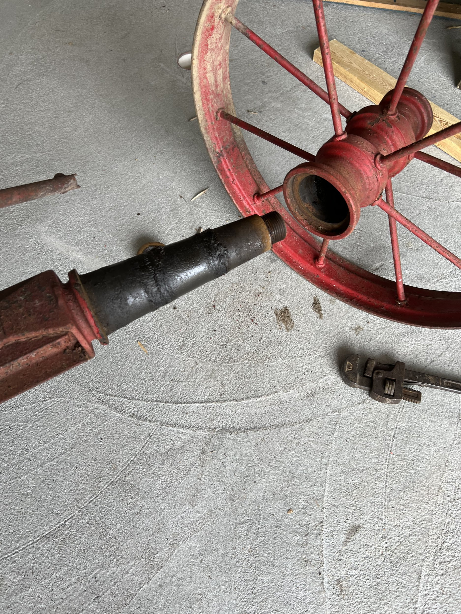

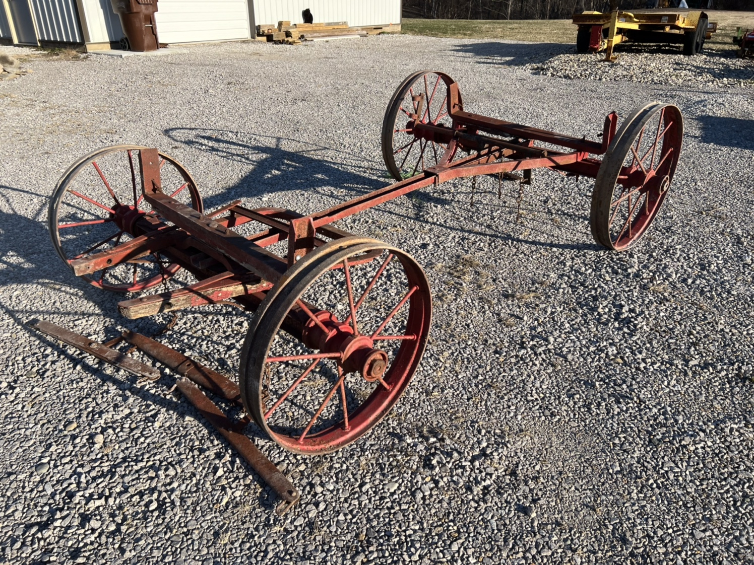

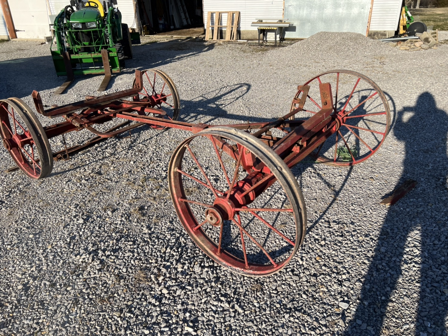

I purchased this wagon to use to place my chicken coop on to move around my property but would like to clean it up some and grease the bearings but not knowing anything about these how would I go about greasing them?
/ Horse drawn wagon
Are they wood bearings or some other type? I hate to get into one and it fall apart on me.
/ Horse drawn wagon #4
Check to see if the left side axle nut is left hand thread. Many of them were so the forward motion of the wheel would keep the nut tight.
/ Horse drawn wagon
That’s exactly what it was and they were just metal to metal and no bearing.

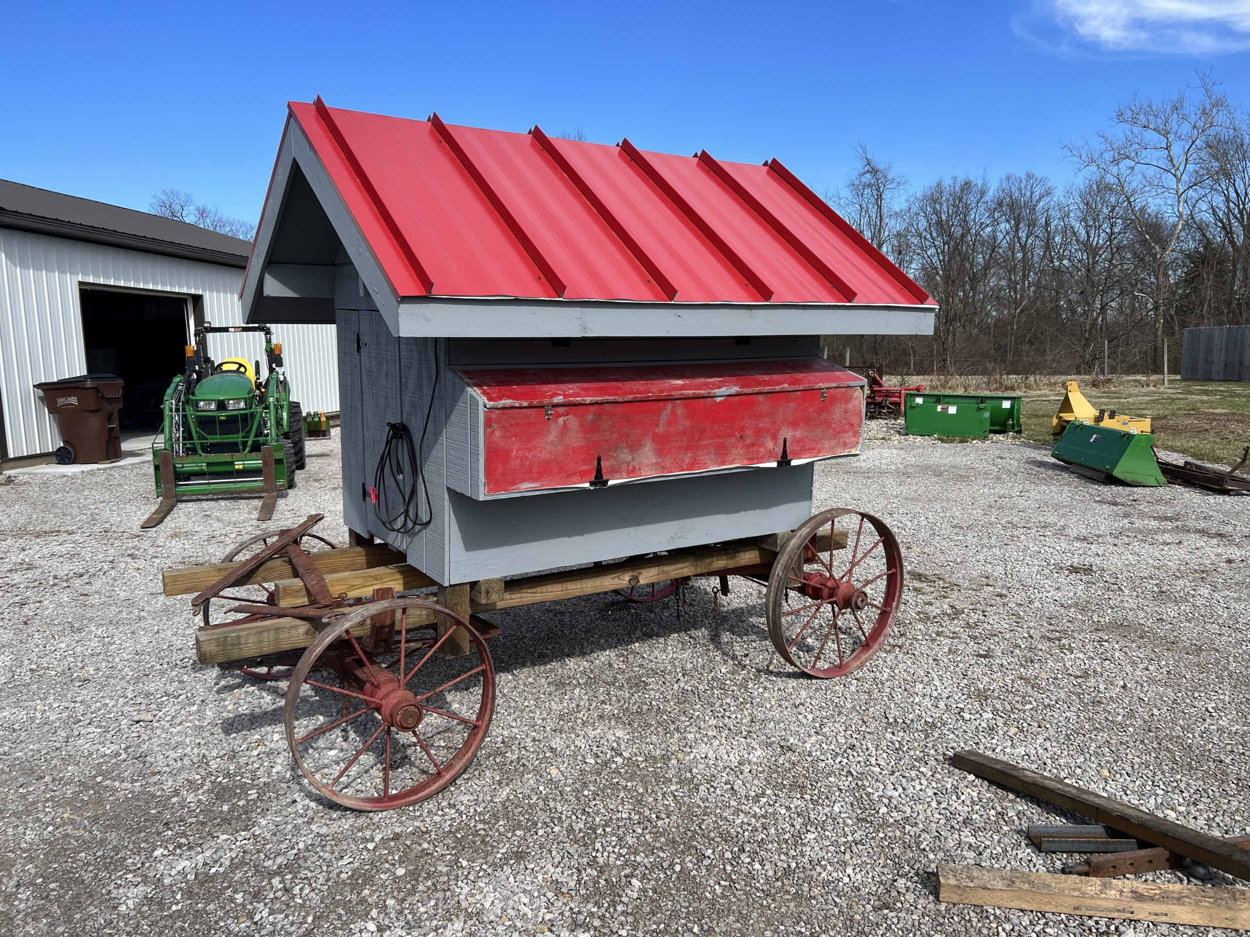

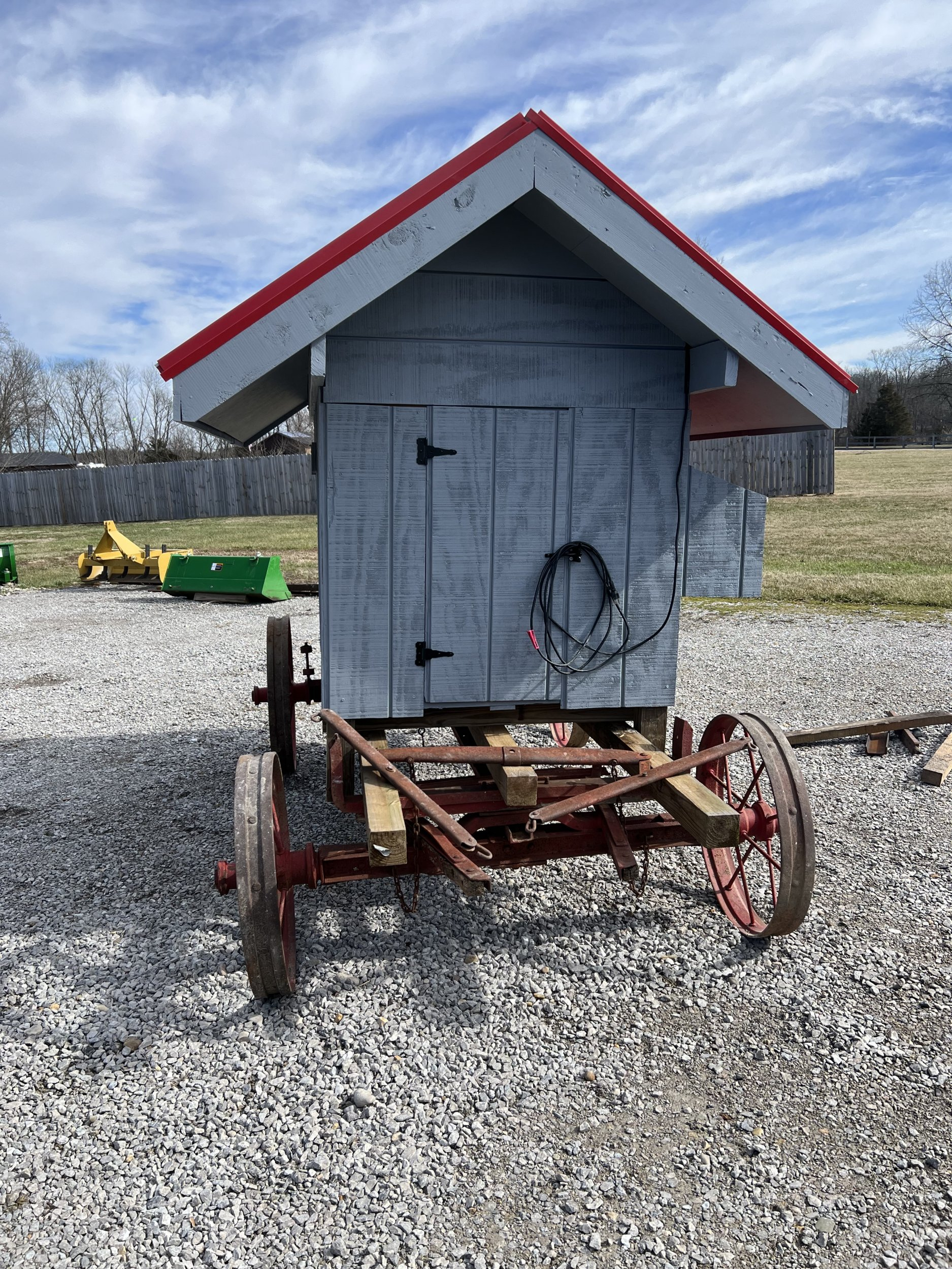

BTW this is what I’m doing with the wagon
