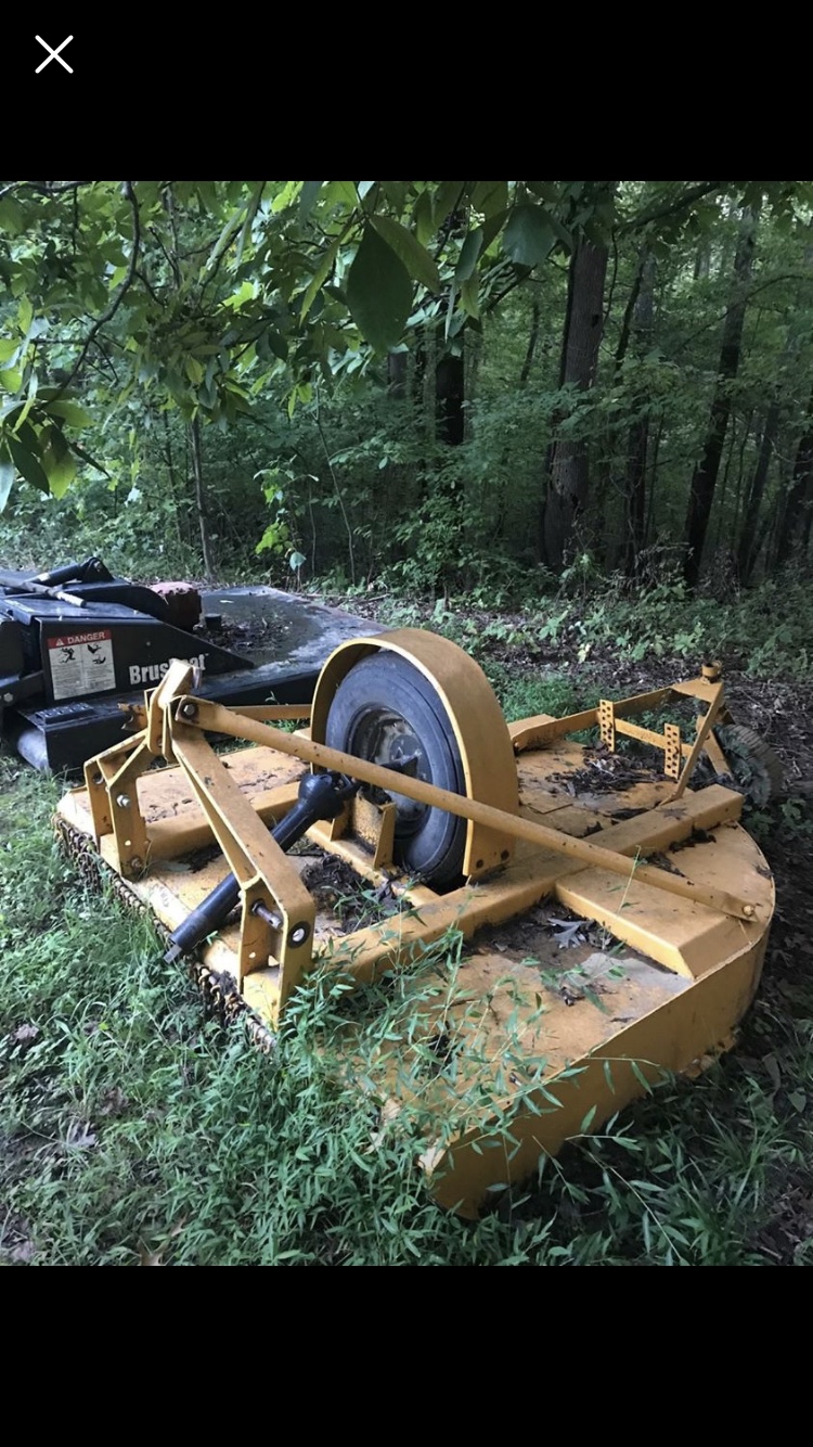

I like the price, BUT, notice another mower sitting beside it. I wonder whether it's the Sidewinder's replacement and why it's being replaced. If my Ranger had a big enough bed to haul it, I'd be tempted to buy it myself.
The mower sitting beside it is a skid steer front mount, hydraulic powered Bobcat Brushcat:

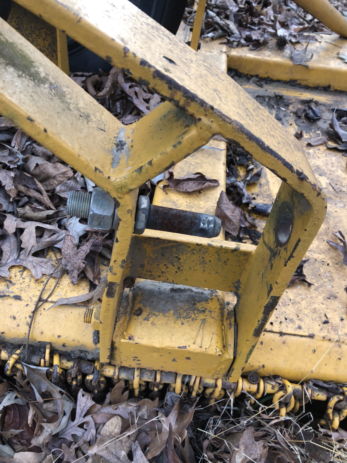

Went and looked at it. Would be too heavy and too wide for my 3130. But a dang heavy duty brush cutter though! IMG_0810.JPGIMG_0809.JPGIMG_0808.JPG

I have found a 6’ Sidewinder Brush hog for sale locally for $800. It is said to be in working order, no issues. I love the design. Simple yet effective. I have read great reviews of it eating anything the tractor can go over.... but from people pulling 7’ ones behind 70HP tractors. It’s said to be very heavy and well made.
I have a Kubota 3130 ( 30HP, 25HP at PTO) my concern is will my tractor be able to use the 6’ brush hog of this design and not be too much for the tractor.
I had planned on buying a new EA Brush hog this spring but if the Sidewinder will work, may be worth saving a little. No slip clutch/ Shearwater bolt, no gear box... hit something and the tire keeps going and he plate below stops. No gears or anything get damaged or risk damage.
Thoughts? Anyone have this and got feedback? View attachment 536830
