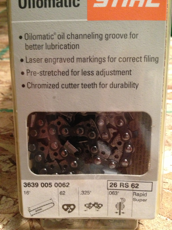

I was using Stihl's green low kick back safety chain for several years. I decided it was time to get a few new chains so I stepped up to the yellow chain which is more aggressive. I was surprised at the difference. Cuts like butter... I have a 16" bar saw and 20" bar pro saw.
Unless you are plunge cutting at the tip, the green and yellow chains of the same cutter type will cut the same along the length of the bar.
More likely, you changed from green semi-chisel (RM) to yellow full-chisel (RS). You can get both types in green or yellow, and they will cut the same along the length of the bar. All of Stihl's saws that run .325 would have shipped with green RM chain, but you're showing that the new chain is RS in the picture. So the change from RM to RS is the big factor here, and the green/yellow distinction only matters for plunge cuts and overall safety.
Full-chisel does cut better when sharp, but it dulls much more quickly so it's only appropriate for clean wood and when you can keep it sharpened. I file my full-chisel chain at least 3-4 times more than semi-chisel in a given day of cutting.
