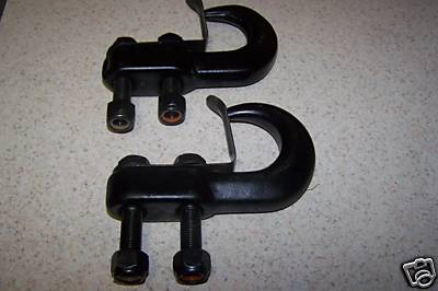

/ Hooks on FEL #7
I bolted a set of Jeep front tow hooks to my FEL and they work great. They are rated at 10K Lbs each and cost around $14.00

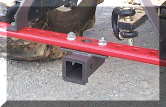

/ Hooks on FEL #9
what about bolting on a receiver and then you can install and remove several items like hooks, hitches, winches, etc. At $25 it's a bit more expensive (add the "hooks, hitches, winches, etc") but provides much more capability.
