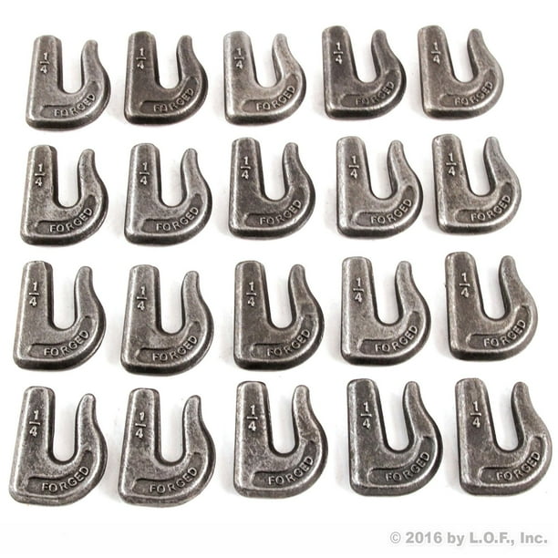

What size hooks are you guys welding onto your buckets? Is 3/8 big enough or should I go bigger? I just have a little massey scut, I'm not going to be doing anything crazy with it.

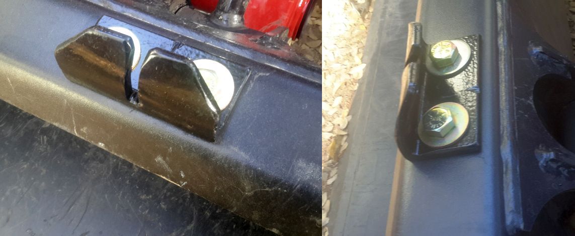

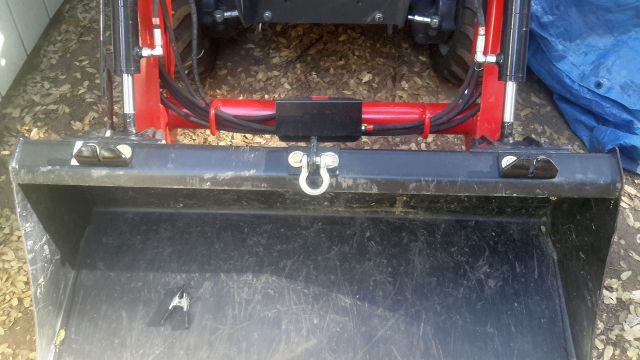

I went with home made for 1/4 inch chain.... Chain is 1200 lb test, have serious doubts tractor can exert enough energy to break it....
Parts just cut from 2 x 2 x 1/4 inch angle iron and grade 8 bolts...

I put 5/16" on mine, only because they apparently don't make 1/4" weld on hooks. Could have used regular hooks but prefer the weld on. The 5/16" will accommodate a 3/8" chain but doesn't get the full engagement like it should. Agree with DL about the capacity. No need for 3/8".

They do make 1/4 inch, but probably harder to find....

I rarely use anything other than 1/4" G70 chain any more. The WLL on it is 150% of what my loader will pick, and the breaking strength about 6X. Works in my 3/8" slots and is nice to handle too.

5/16... you can use 1/4 chain with it as well as 5/16. 3/8 is too large for anything under 40 horse.

Yep, 5/16 easy to find and cheap.

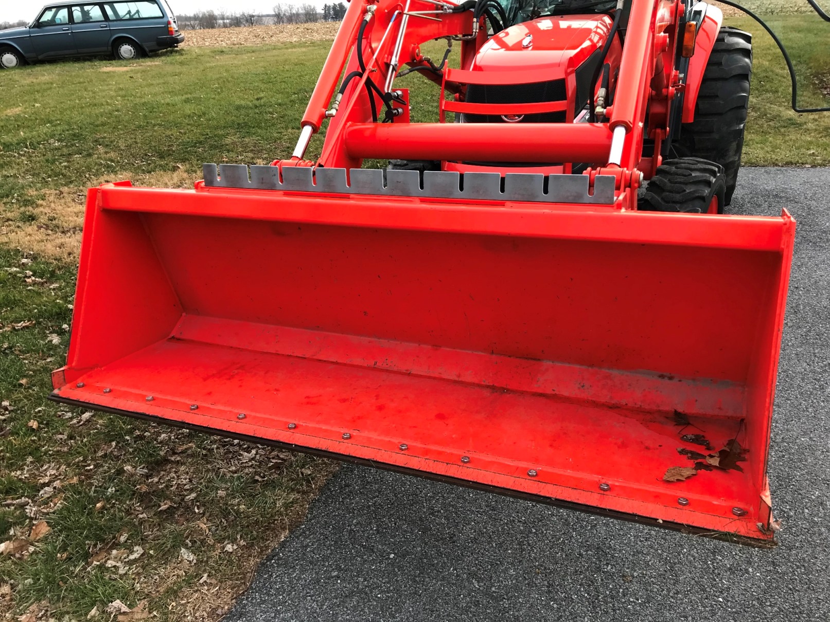

Instead of welding the hook to my bucket, I drilled a hole through the bottom of the bucket, a little bigger then the size of the chain. I then pass the bare end of the chain through the hole, and lock it with the hook so it will not go back through. The method seems to work a treat.
