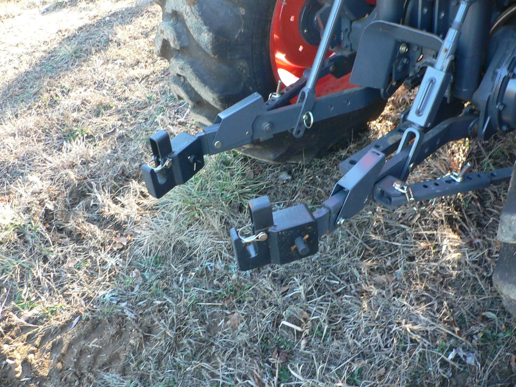

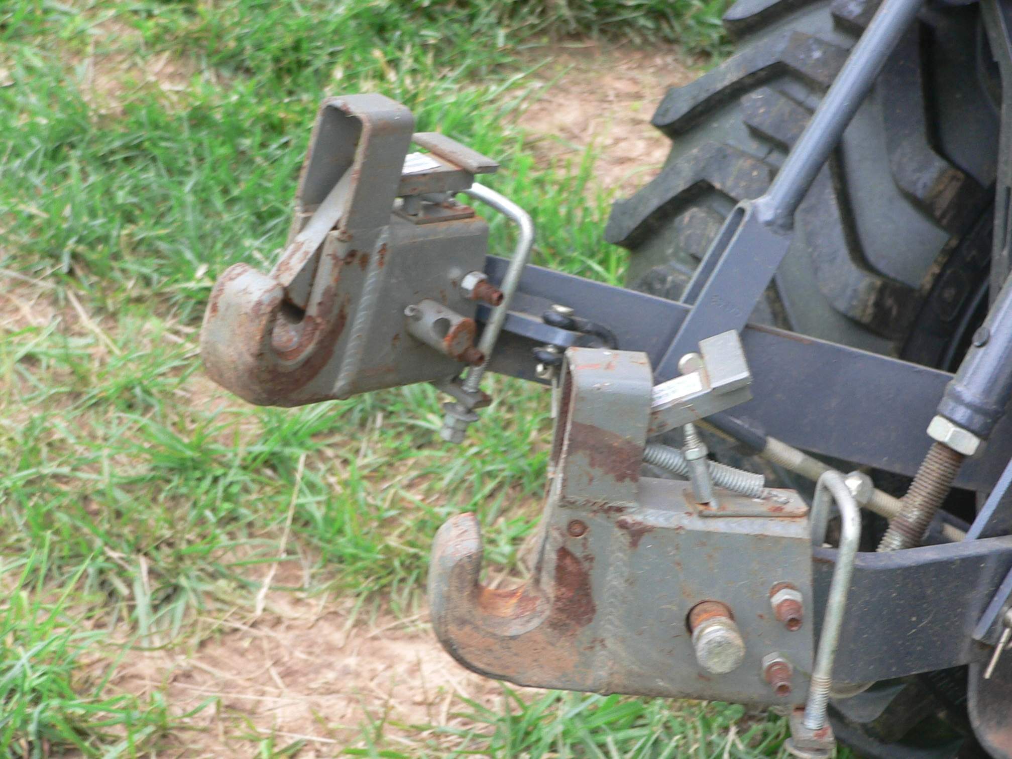

What you are seeing is normal. I wrestled with implements on my first tractor 6 years ago then bought a Pat's quick hitch system. Have since also bought a cheap set off ebay. Here are pictures of each set. The dollies sound/look like a great idea but I haven't done it yet but plan on it.

Thanks guys, I really wasn't sure if it was me or something was wrong.
That would be awesome if I could swap the pins - they are indeed pointing "out". But I bet they're welded in place or something? I'lll check that first though.
I like the idea of the quick hitch set up but will try the leveling and pins out first since I won't be using it that much.

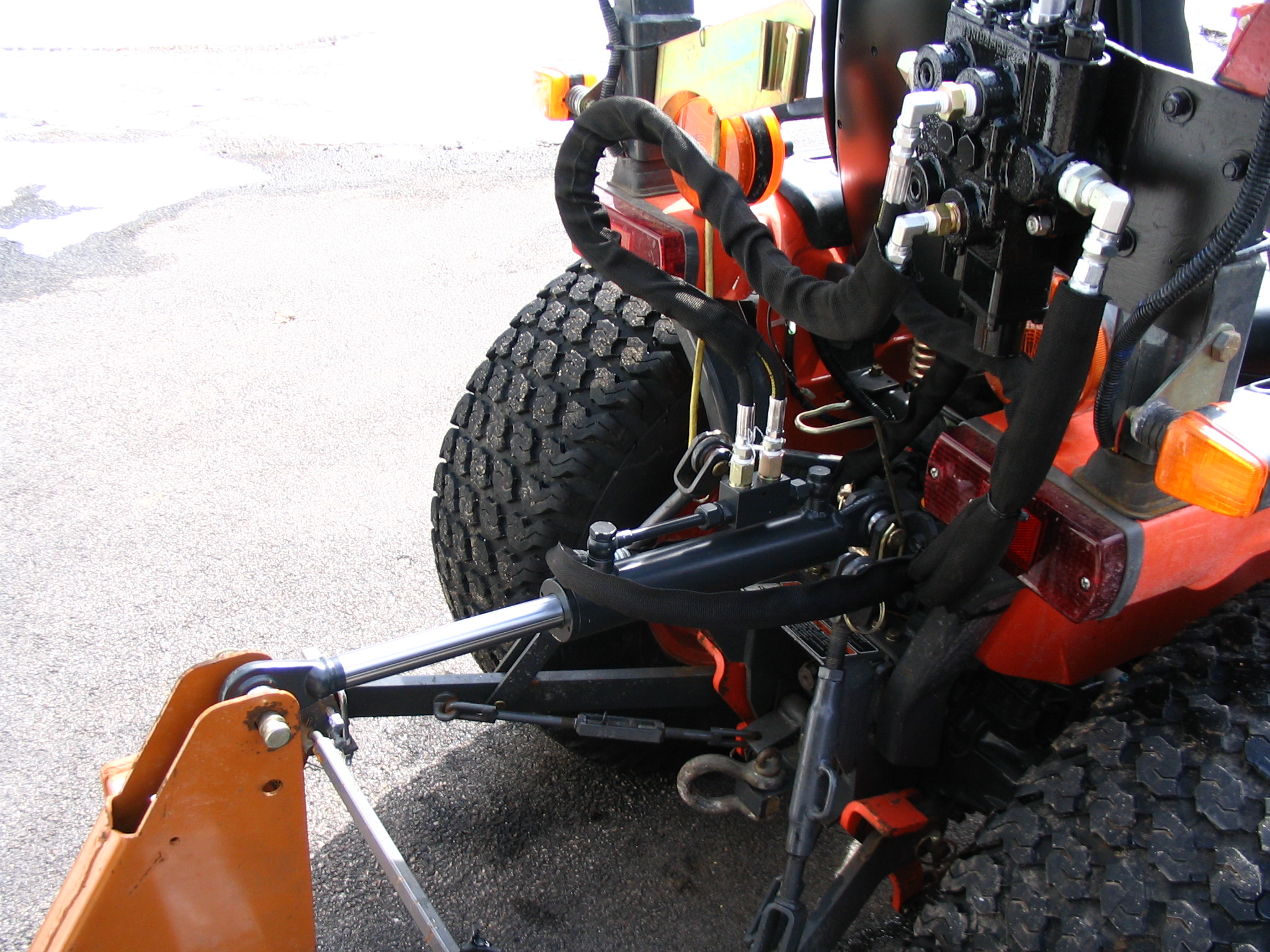

The basic use of a HTL is to be able to adjust the angle of attack for something like a box blade or rake or rear blade. You can adjust how aggressively the implement contacts the soil without leaving your seat. I do find it helpful for when I need to raise an implement a little higher to clear a rock or stone wall for example - just contract the HTL cylinder and up it goes.
They won't let you independently raise or lower your 3PH and MMM, but there is a way to do that on a BX and that is to rotate your mower height control knob to "TOP" which pins the deck up even when you lower the 3PH.
Here's a pic of my HTL
Edit: Oops I see you have a B so I'm not sure if you have the MMM control knob like the BX's
