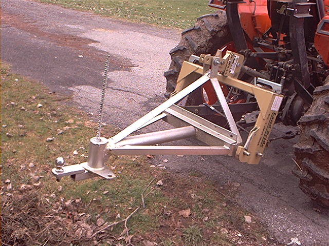

I have a quick hitch and while it makes hooking up a LOT easier, it does make access to the PTO shaft even more restricted. I have the pin type but it does take a little contortioning to get in and hook up the shaft. I'm very happy with the quick hitch though as it makes hooking things up a lot easier since you don't have to line things up so perfectly when on uneven ground. (I noticed bigger tractors all have the open three point arms which accomplishes the same thing as the quick hitch. Seems like a much better design. Wonder why the cuts don't use that style too. Be a hell of a selling point with me........) /w3tcompact/icons/smile.gif

Re: Hookin\' Up That Rotary Cutter
Do you have a picture of your quick hitch and of the 'open' 3pt arms you are referring to on the bigger tractors? I am not getting a mental image of the differences. Thanks

I don't know how well the detail will show up but if you can open the file in a photo program you can blow it up and look at the link arm ends. They are basically an open "C" with the cup facing straight up. All you do is lower the three point below the pins, drive under and lift the three point. There are two latches you then release that extends two bars and kind of closes the cup. If you're on uneven ground it doesn't matter as one side will contact first, then the other will slip in. Not like a conventional one where you have to get two sides perfectly lined up. Not quite as good as the "triangle" design but for $199 I can use it on all my implements and don't need a separate peice for each piece of equipment I own. Since I got it I haven't had it off. No reason I can think of they can't make the lower factory links the same way. Much easier to hook up.

How does the top connect between the implement and the QH? In particular, my RFM has a connection that requires a swinging connection, unlike a scraper blade. The QH looks like it simply has a hook on top. What would keep the swinging connection from flipping off? Thanks.............chim
