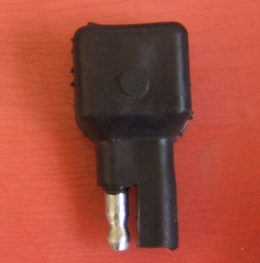

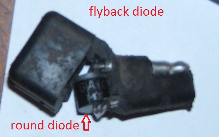

John Deere are well known for anticipating a reversed battery by owner and often provide special diodes to try and limit the damage.
However, should there be diode(s) as part of a safety design, these can fail shorted and this could be why even when the battery is properly connected you still have a short.
If you have a wiring diagram you could post I will review it and comment further.
I have attached photos of one example from another brand.
