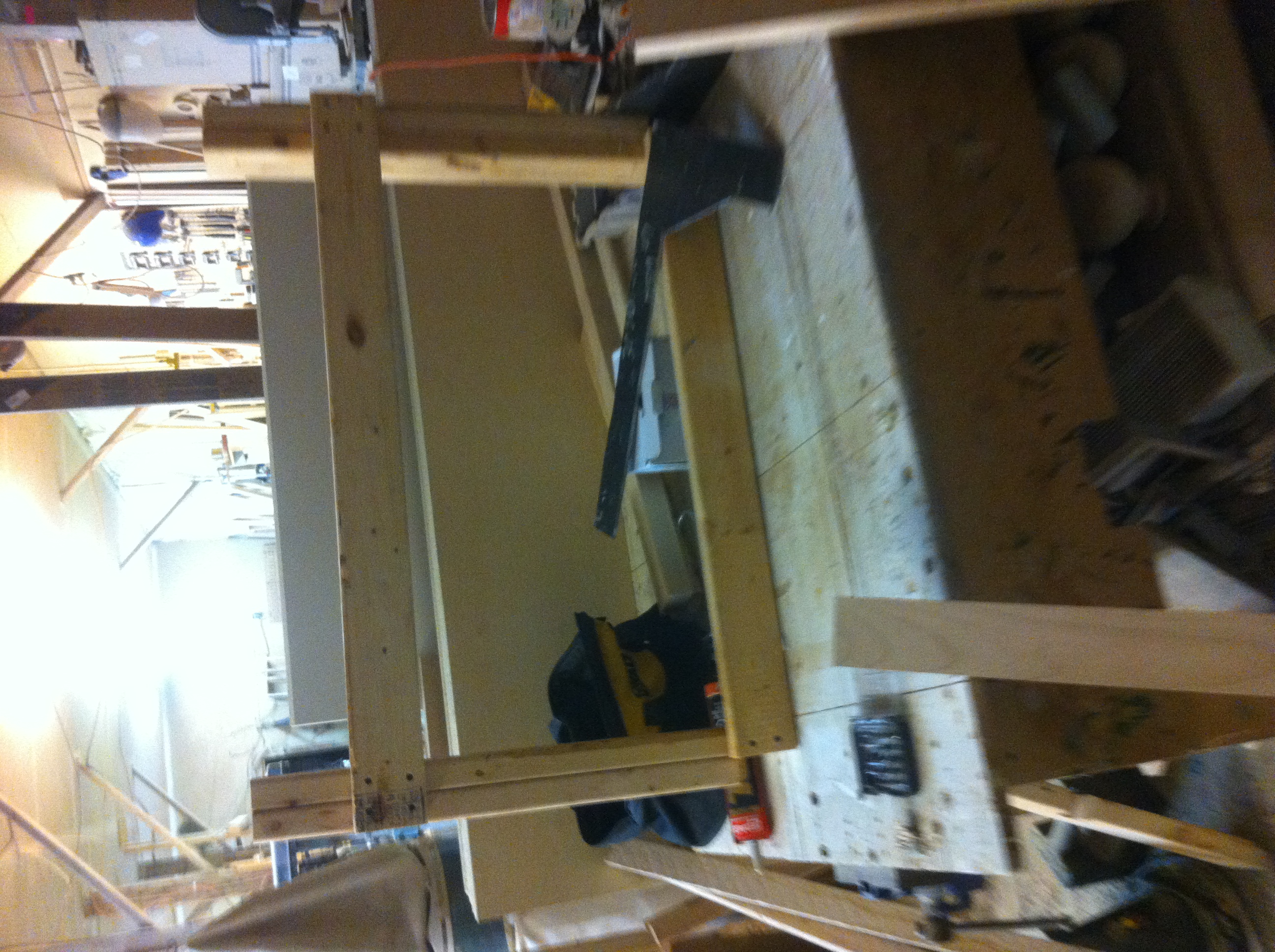

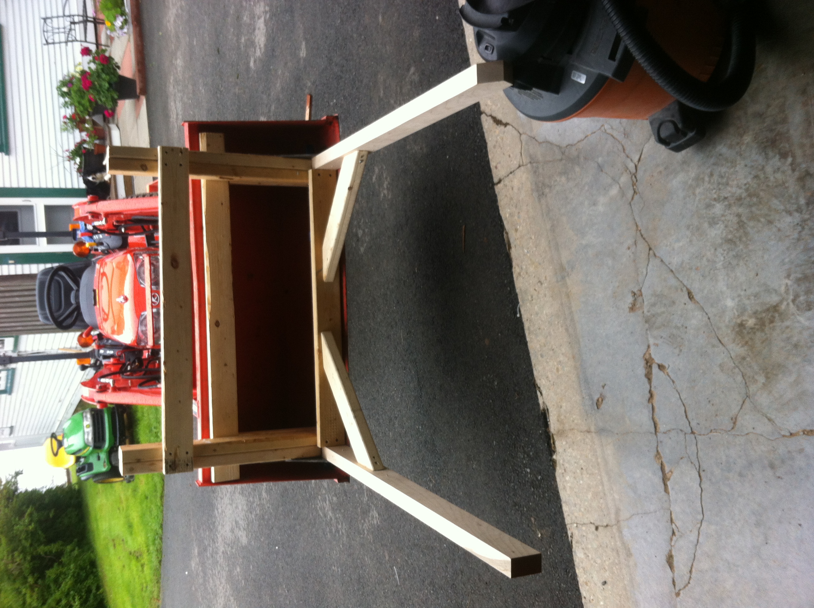

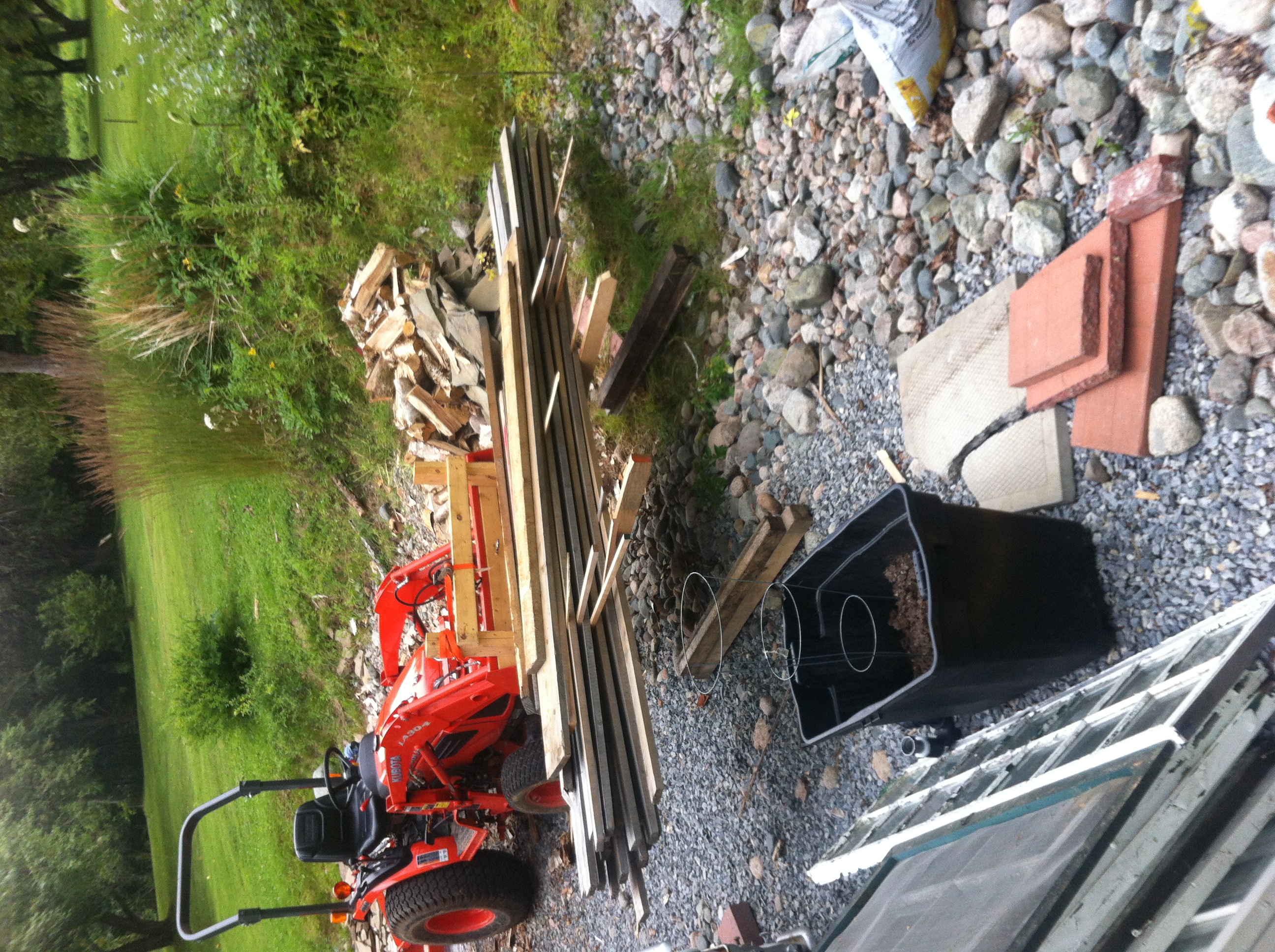

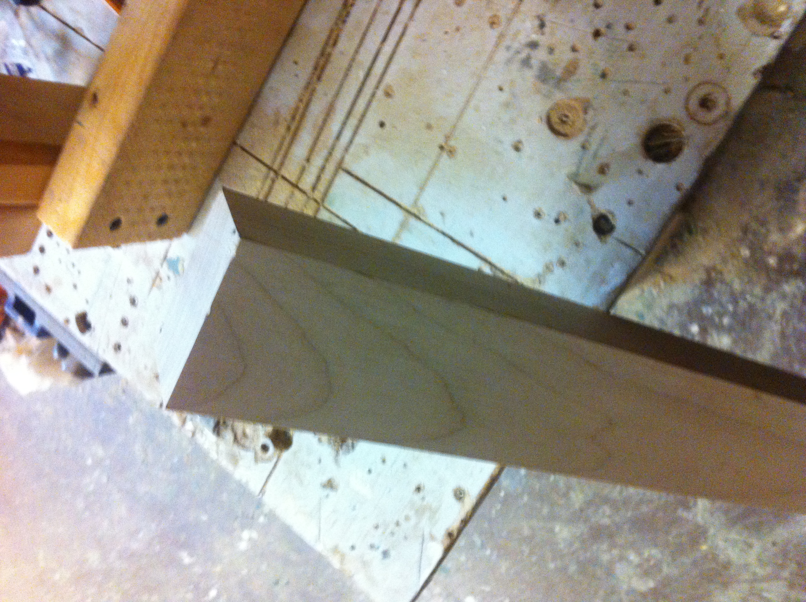

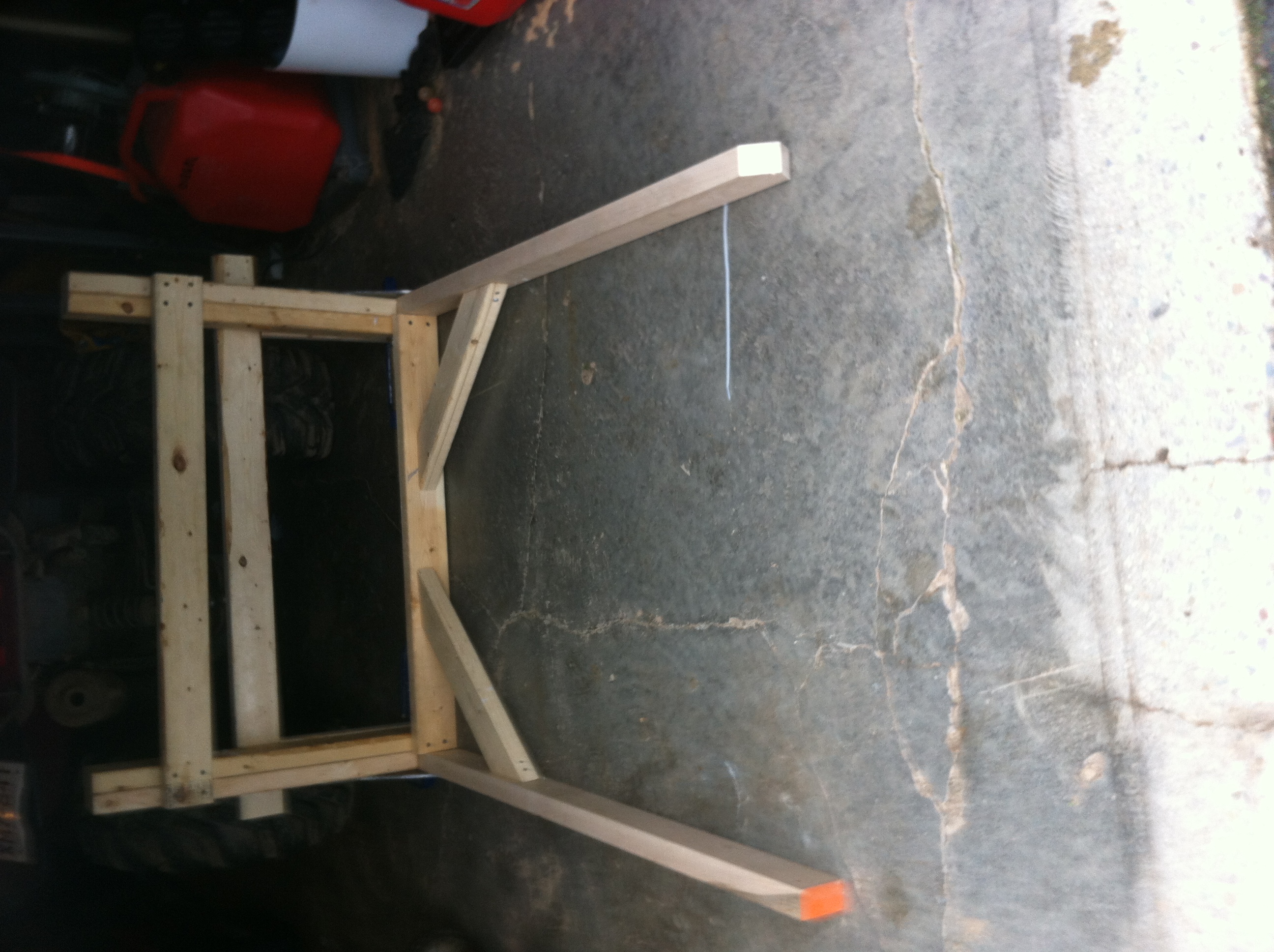

These four pictures are the only real pictures i have of assembling it, the frame itself is basically just a square with two pieces on the side to hold the forks down, i had intentionally left the sides about 18" higher than the bucket height so when your working with the forks you can see where the outside of your forks are instead of guessing.
I also didnt plan on adding cross bracing to help support the forks from moving side to side as i was only thinking about the forward and backward movement of the forks, after having it assembled i realised it was absolutely necessary to have cross pieces holding the forks in place or if you angle the tractor with the bucket low the forks will just snap off like a twig.
The last modification i had made before deeming them "ready" was adding a back support bar to avoid bending the bucket, its hard to explain but hopefully easy to see in the picture below that the bar in the back helps distribute the force over the entire top of the bucket when a load is put on the end of the forks, the forks will naturally want to go down, in turn pushing the frame of the forks up and this was an essential part to not having them come flying out of my bucket mid-load.

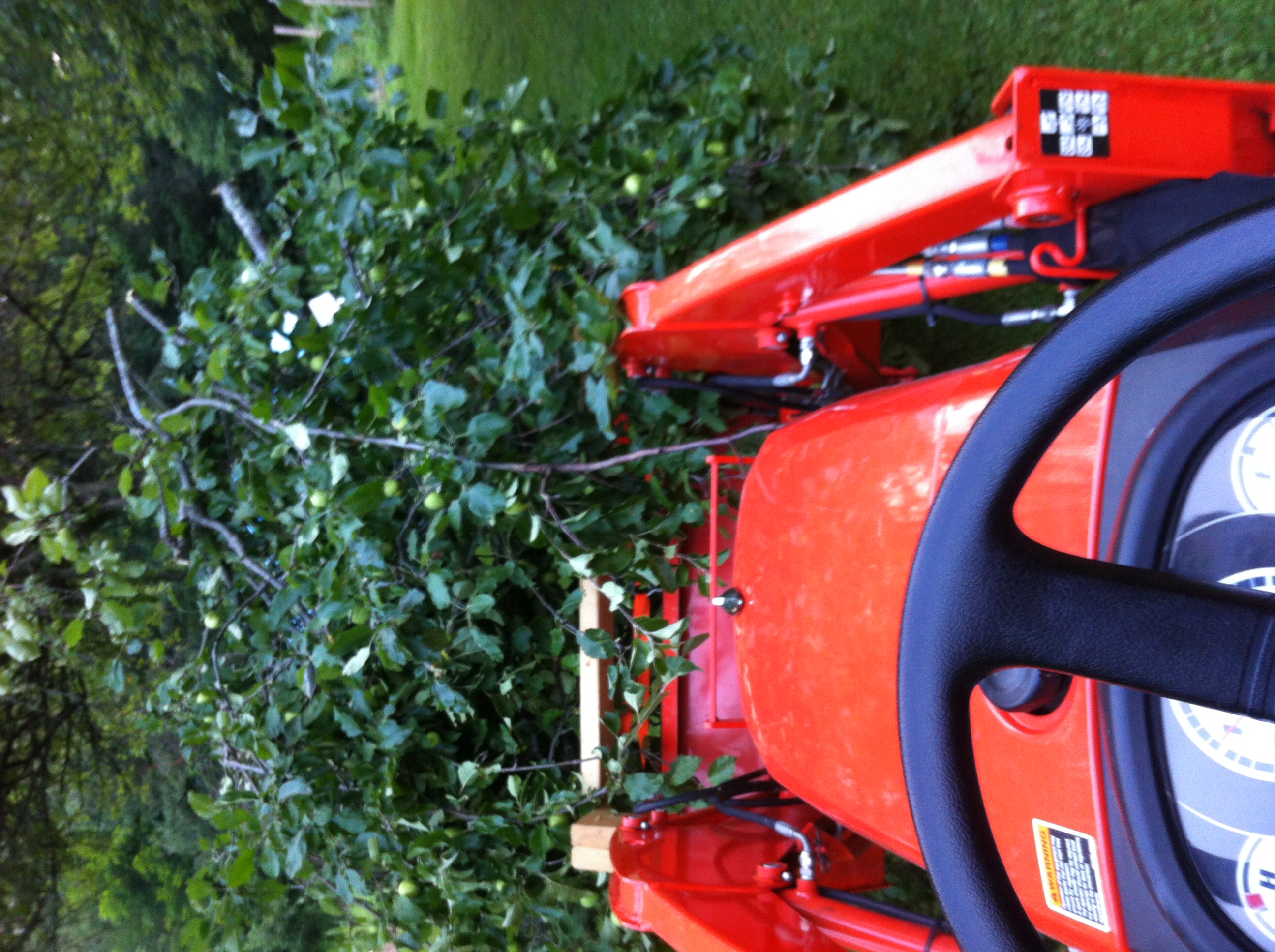

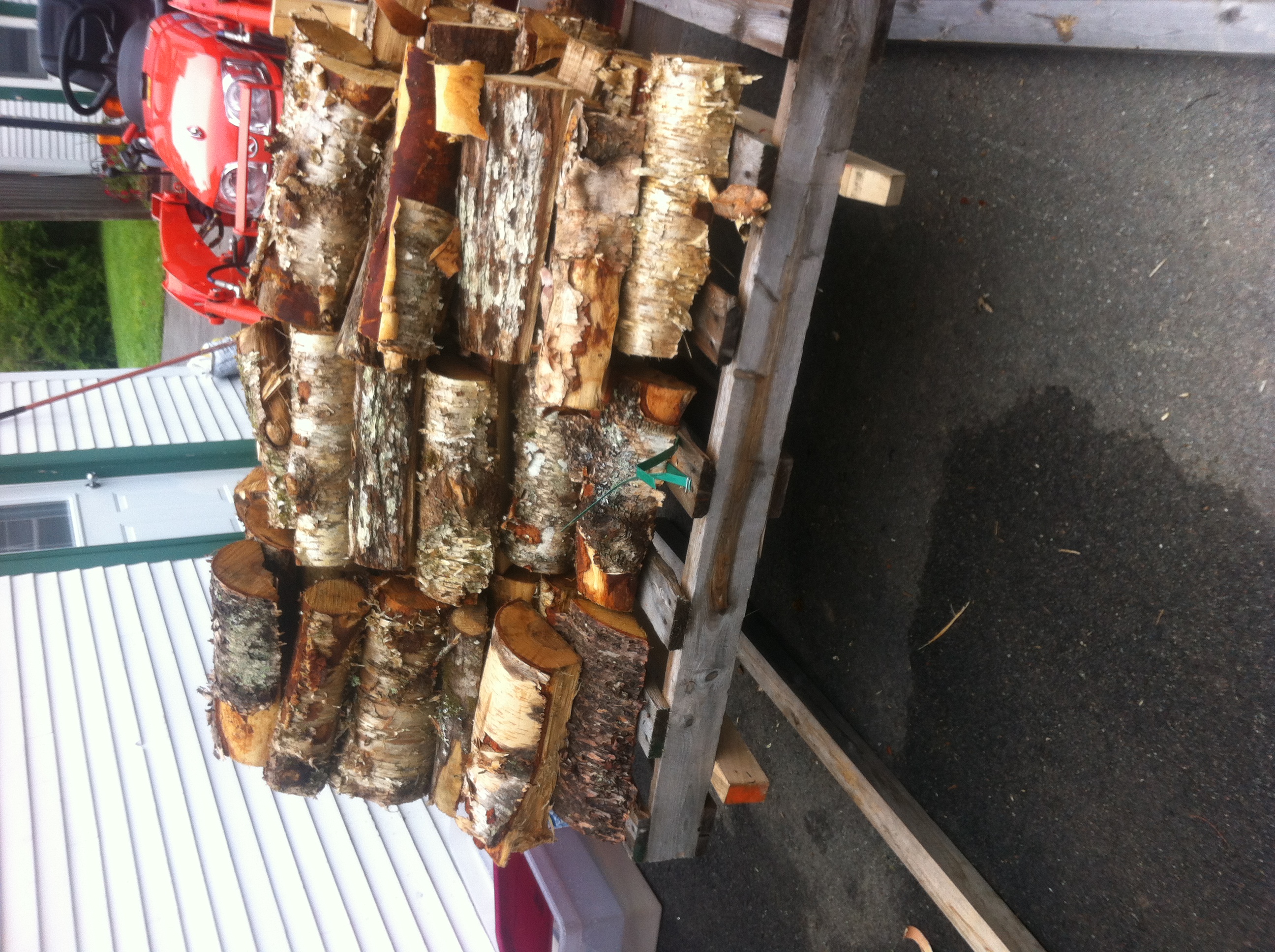

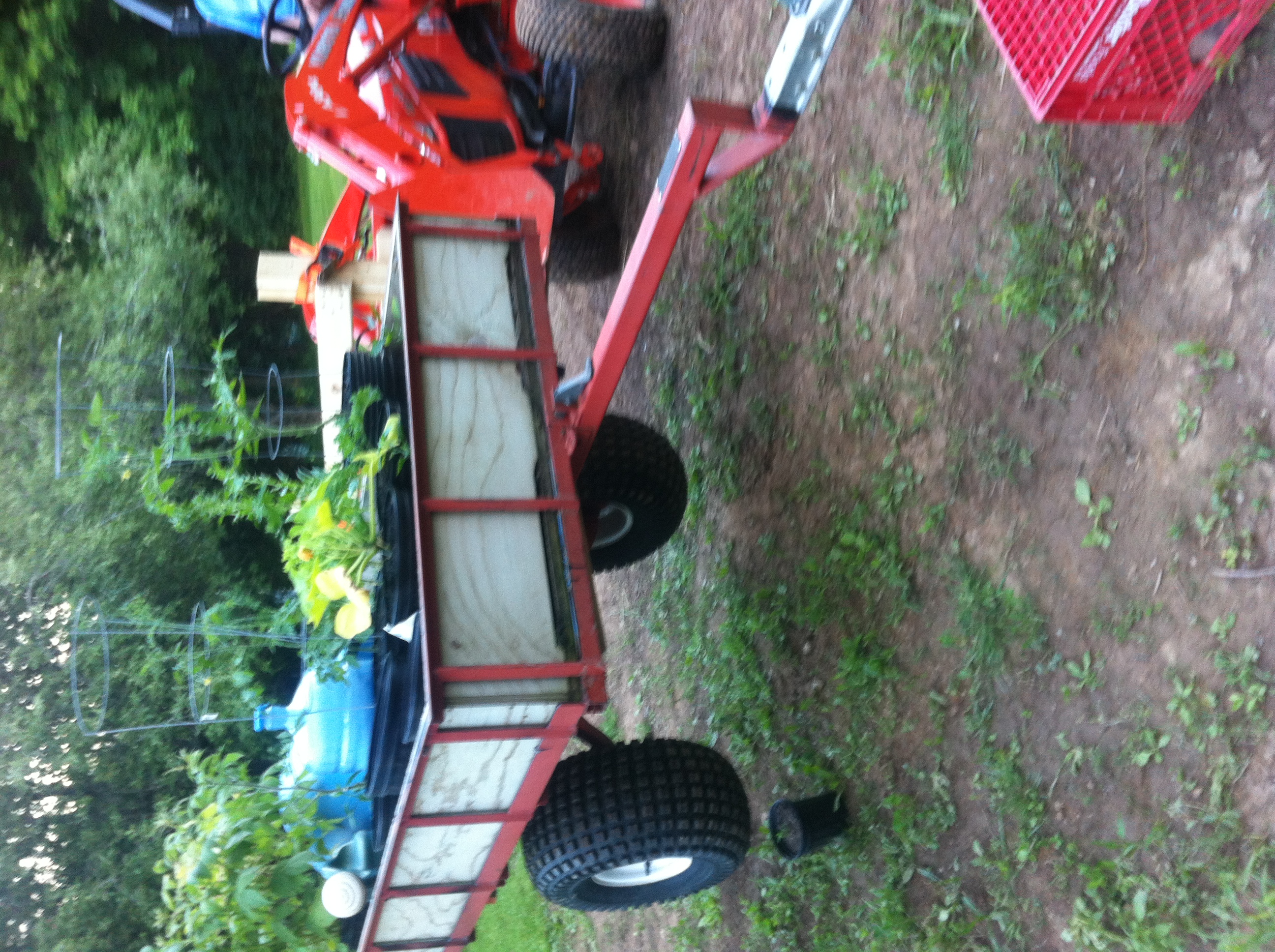

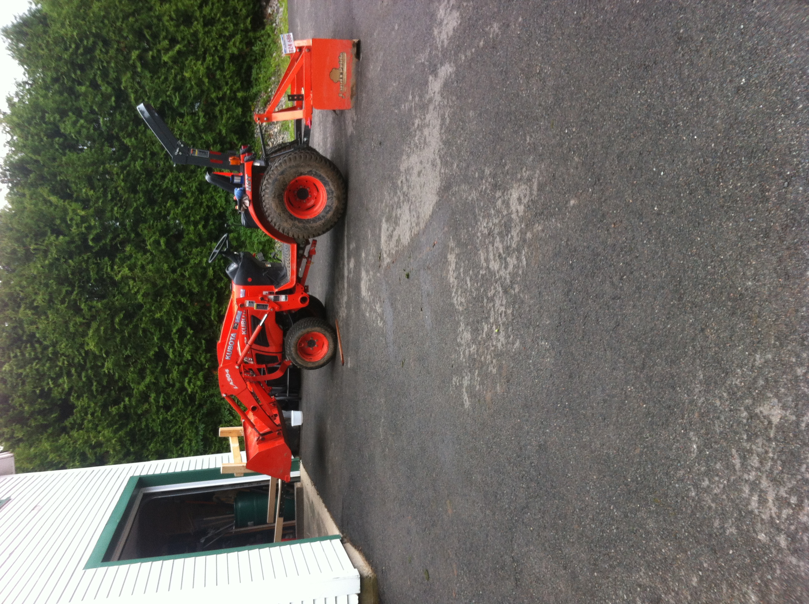

And without more babbling, some pictures of them actually lifting things - the pictures with the firewood pallets were overloading the tractor at one point so these forks can lift more than the tractor can lift. the trailer is just a little four wheeler trailer that i use to fill up plant pots with dirt and bring to the garden (can patch the tires by just lifting with the forks instead of jacks now) and the tree branches were from a 20 foot apple tree limb that rotted and collapsed on the lawn one night,

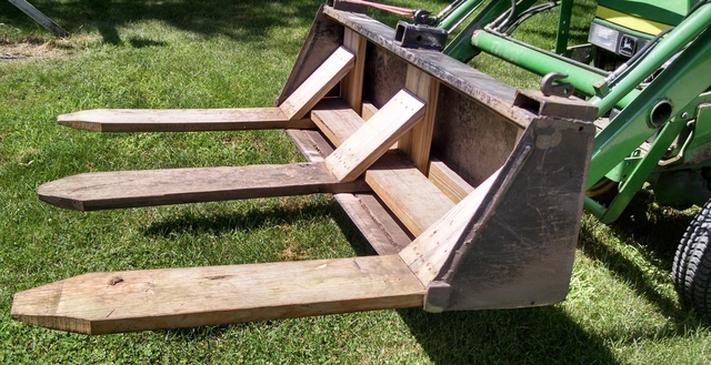

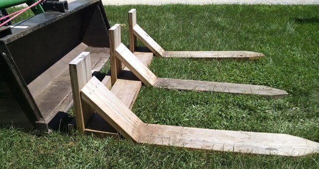

Good job... I like it! Goes to show that necessity is the mother of invention. Mine are a bit different in approach but the bottom line is that they are also wood! I do like your's because they appear to be a bit longer and there are only two forks rather than three like mine. The length will help with carrying more brush and the "two" forks will allow you to use a standard pallet.
Here's a couple of pictures of mine and you can see that I've used three (instead of two) forks for a bit more carrying capacity and the whole back end fits into the bucket so as to be self supporting once inside. To keep them from falling out should the bucket be tipped straight down, I just tie a rope or chain around the middle fork and then bring it back underneath the bucket and hook it back around to the top of the bucket - it's out of the way and doesn't get caught on anything.
I initially made them out of scrap wood and over the past 15 years I've had to rebuild them several times and I don't think I've ever spent a dime other than using new deck screws which I always have around. The basic design has remained constant but the size of the 2x has changed depending on what I have available. The s forks themselves have ranged from 2x6s to 2x10s and at times there might have been more than one size being used. I only repair / replace those boards that are in need although over time I'm sure that all have been replaced at one point or another.
While they've worked well over the years, I still dream about a set of "real forks" :D which of course will only be practical if I convert to some sort of quicktach loader. :licking:
