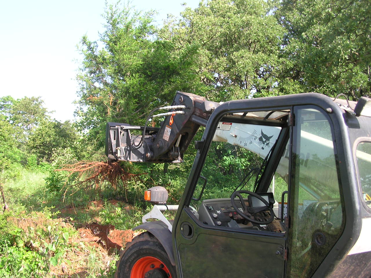

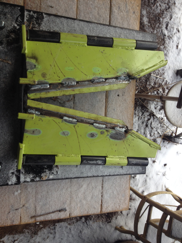

Here is a picture of my Brush Grubber now. The plates were moved closer and re-welded. It works better now but it needs serrated teeth -- or something to hold onto the tree better. I am still considering a hydraulic clamp type puller.
I am hesitant to buy, since nearly half of my FEL lift capacity will be used to lift the attachment.
Curious -- are there any 3-Point Hitch tree pullers with hydraulic clamp?

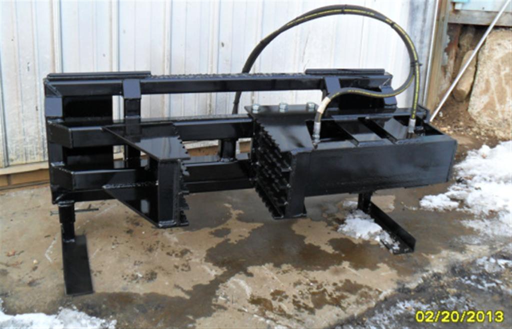

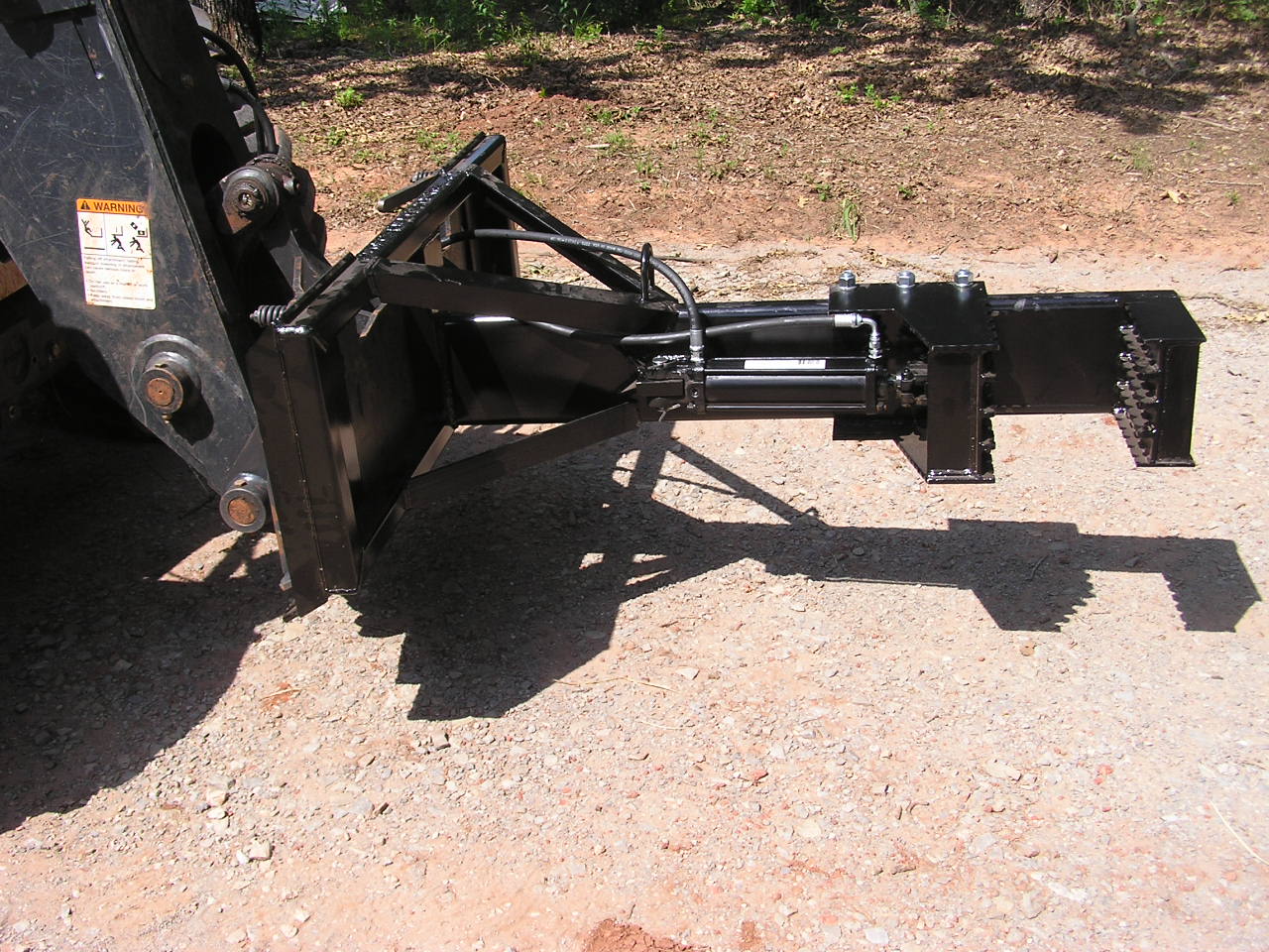

Yes, a few. "All pullers can be built to fit any machine, or even a 3 point hitch." , from their Website: Buckthorn Puller - Custom built Skid Steer attachments to fit almost any need you may have.
I have their SSQA Long Arm Puller, very well made.
