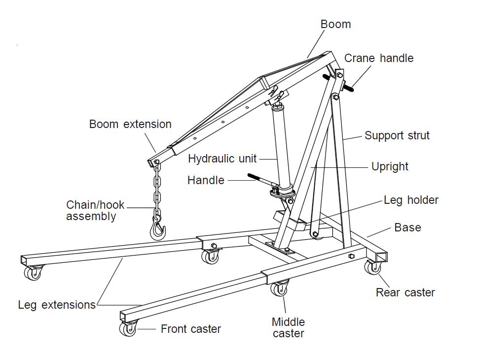

Looks handy! I would be careful relying on just the friction of the set screw to keep the inner telescoping member from sliding back into the outer. Most telescoping engine hoists have a cross-pin that goes through both members.
   / Homemade telescoping boom pole
Noted. The further out on the pole the less weight it will lift. My engine hoist does not have the pins like the one in your diagram. Mine has a set screw similar to my pole. I never have had an issue with that. I agree that a pin is a safer design and I will likely add one in the future. I will probably need it when it get my hydraulic claws/scoop attachment built for the end of the pole for picking up various things like down trees.

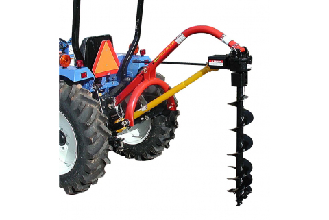

Same leverage design as post hole digger booms, without the common bent down end.
