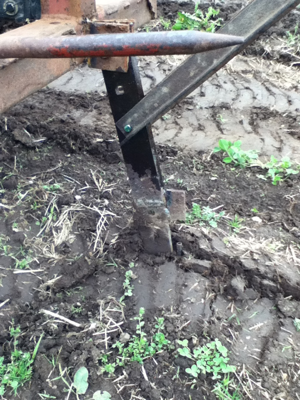

Here's my subsoiler I made. I really wanted one with a shear bolt, it seemed that prices we're outrageous around here. So here's my first one I built, but as you see, it didn't hold up to well, but then I made a second, I used an anhydrous knife attached to an old plow edge. Put over an hour of work on it. Using a grade 5 shear bolt, as I hit a large rock and worked perfect. Now I just need to attach a pipe to the back and start laying pipe!
