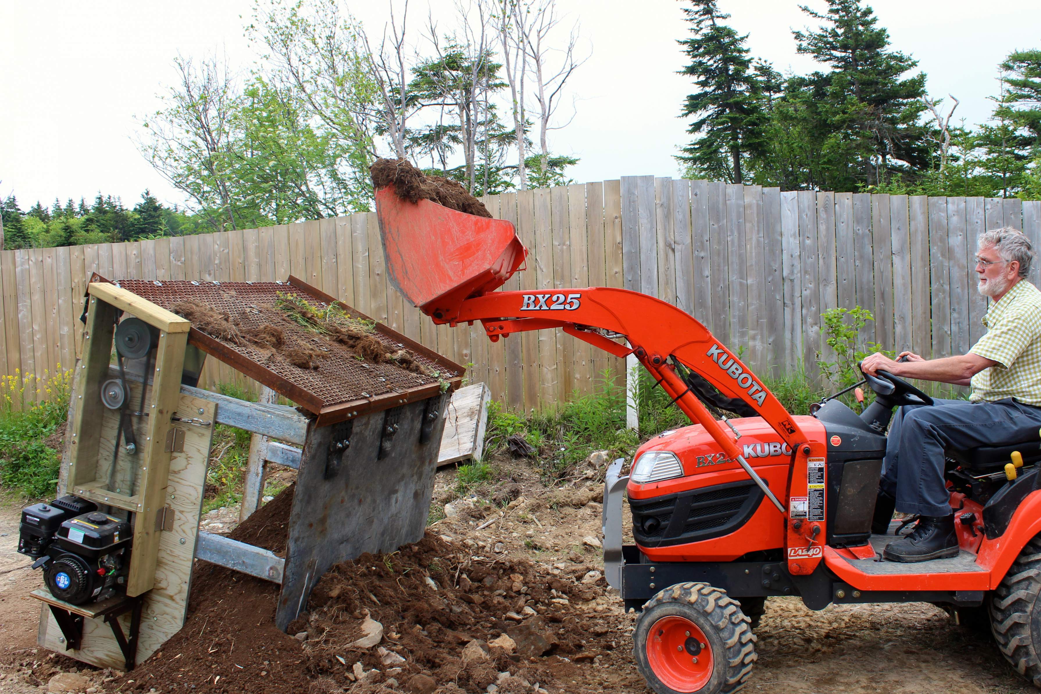

Sections of tires take the place of regular springs and hinges to suspend the screen on the main chassis. About 100 tons of material screened so far. Just posted a video on Youtube. I'm also working on
a video showing more details on the build. Found an old galvanized table at scrap metal yard that was just the right size for the chassis. 6-1/2 HP gas engine drives the screener.

Works well - would like to see the "shaker" mechanism closeup?

Wow... going to have to build one of those. Amazing how much easier screened soil is to work with in the beds.
I never thought the weight would be so easy to build... I thought you would drive a shaft on an eccentric to really get the bed going. With such a simple vibration you have going it seems pretty easy to do!

Had to do some experimenting to get the weight "right". Started with a much heavier weight first and things got pretty hairy vibration wise so just reduced it to what you see now. I'm considering increasing the weight a bit to handle wet soil better - but not sure about that yet.

You might be better off if you were to load from the other side. Looks like you might bust a headlight with a rock.
/ Homemade soil screener #9
Screens are usually loaded from the other side so any big lumps or rocks don't hit the loader and create a pile preventing you from dumping. I think the 100 tons is just a little exaggerated based on the video. 200,000 lbs. of loose soil like that would be well over 500 bucket fulls in your little loader. I think it would be better to mount the engine higher so you don't need such a long belt. The way the belt is slapping around, I don't think it will last too long.

The video shows just a sample of the material processed - your estimate of 500 buckets full would be somewhere in the ball park of what has been done so far. (I'm building a road and lawn and use both the sifted soil and the rough output for these jobs). The idea was to load from the other side but because I had an existing frame (chassis) and I didn't want to cut it down to suit my BX25. So I ended up burying the output side of the screen in the ground about 6 inches to make it comfortable to load from the output side. I've had a few heavy rock hits (as CNC Dan mentioned) but no damage. Loading from the output is much more fun as you can just sit and watch the screening action. I'm trying to get another video done showing more of these details. I will post it if it looks good enough.

Lots of interesting points to compliment here! Use of tire rubber means fewer rusty springs or brackets to machine or weld up, replace over time, etc. I particularly like the 'chaff-resistant' belt guard and combination hands-free inspection cover. Belts are quite forgiving of slap, more so than chains, and with vibration the worst possible result hardly out of line with using this obviously well thought out project. Great video, shows enough to imitate this with variations allowable for parts on hand. :thumbsup:
btw: Getting hairy with a heavier wight adjustment might be accommodated with a simple lowering of engine rpm or different pulley on either shaft. Admonitions may come from those of us who haven't built our own yet, but I'll bet back pats outnumber them several-fold. (take a bow, OP!)

Thanks old grind - Never thought about springs rusting etc. when I wanted to build a screener. My main concern was how to mount regular springs for this kind of project - so I was pretty excited when I came up with the rubber tire idea - lots of tires around and they're free :). I have lots of video footage on this project including the belt jumping off with the heavy weight, but all of that was part of the development process. Right now I'm trying to see what to include in the next video on the screener.

a idler pulley would tame that belt slap.

Thanks sparc... yes another idler pulley on the other side of the pulleys would fix that but the system overall is working well so no real need.
