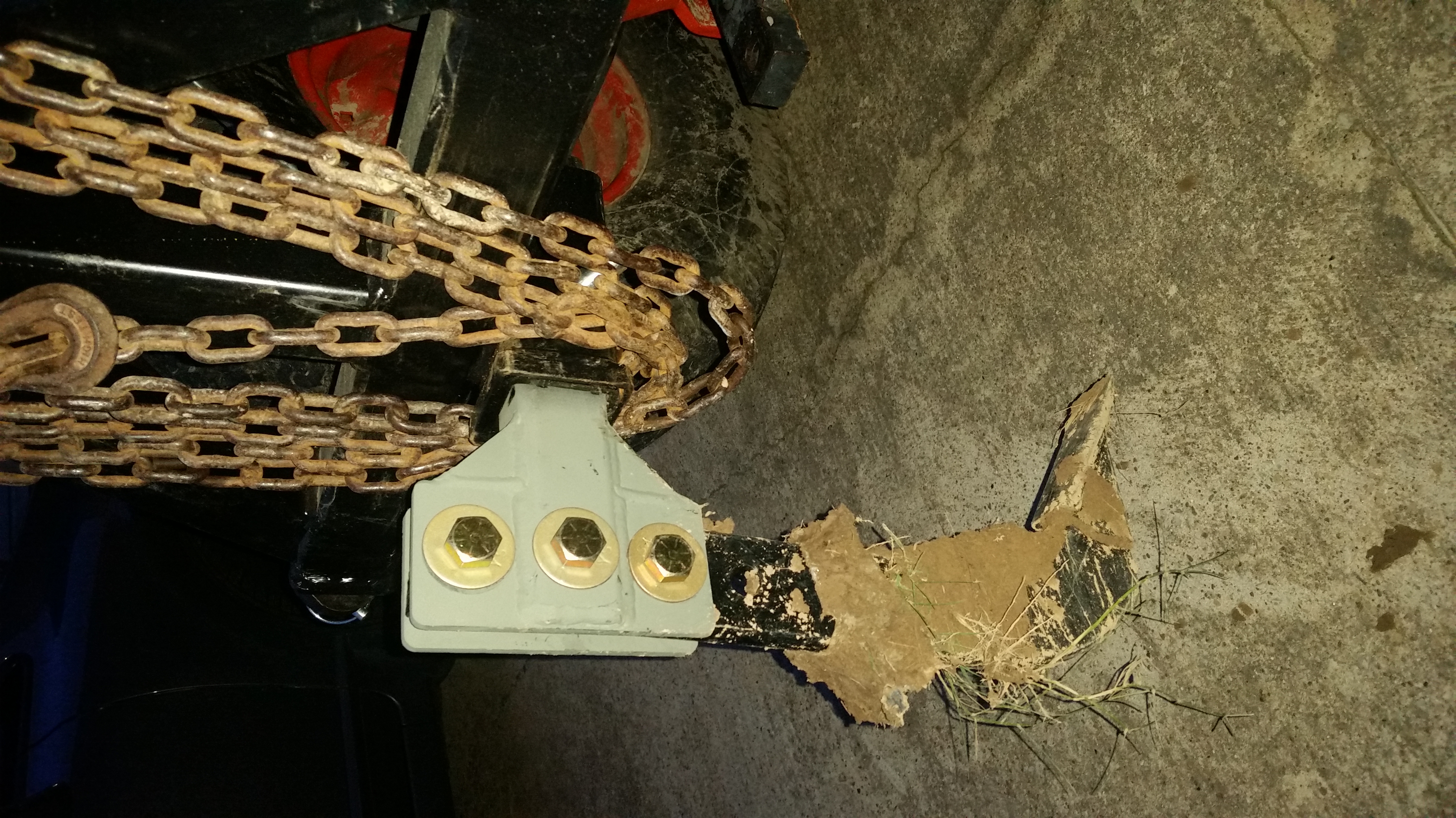

So, the need for a tool has struck again! Have to put a hot wire up around the house once I'm feeling up to it. But to do this job, I need a ripper to help bury the wire to the fence. Looked around and found a single option for a 2" hitch mount. So, I asked a friend to help me make one and vuala! A mean looking ripper was born. I just tried it out in the woods. 4 inches down and the high range bogs. Flip to low range and it just goes until I hit a root. That stopped me in my tracks. Great ripper and didn't break the pin!

Looks like it'll hold up. Can you go deeper by making successive passes in the same furrow?

Multiple passes and I can get it hitch deep. Bit on one pass I can get it about 10 inches in. The mud in the picture is from one pass.

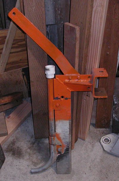

I made this one for the sleeve hitch on my garden tractor. It lays wire a foot deep if it doesn't hit rocks too big. I used a 3/4" 90 deg electrical conduit bend and a pipe nipple. I added the plastic pipe reducer on top to act as a funnel. There's an arm to hold a wire reel. I buried 300' of cat5 wire with it and it worked real well.

I would use metal myself and again wouldn't worry about it riding through a little metal, a long pull through EMT conduit and wires rub on metal a lot.

Looks good straightforward and effective. 👍

Looks good. Can not tell with the mud on the plow but if you don't have sharp edge on the shank get that done. Torch edge will be fine but that will help with roots a lot. Also when you hit a root keep pressure on the plow and slowly lift the plow, sometimes that will break a bigger root that you will expect.
My subsoiler is basically straight shanks also but wish they were tilted back for think that also helps.
