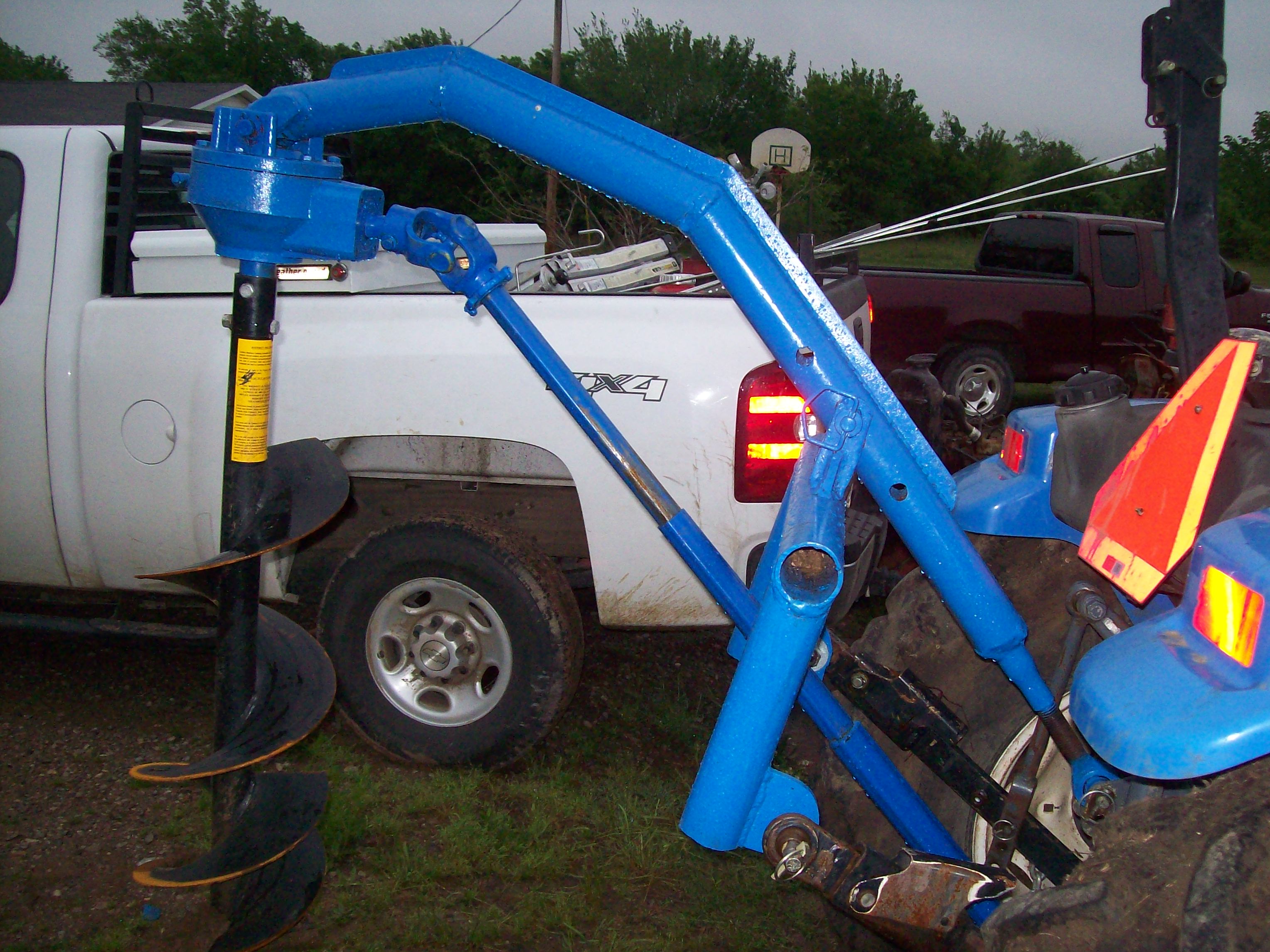

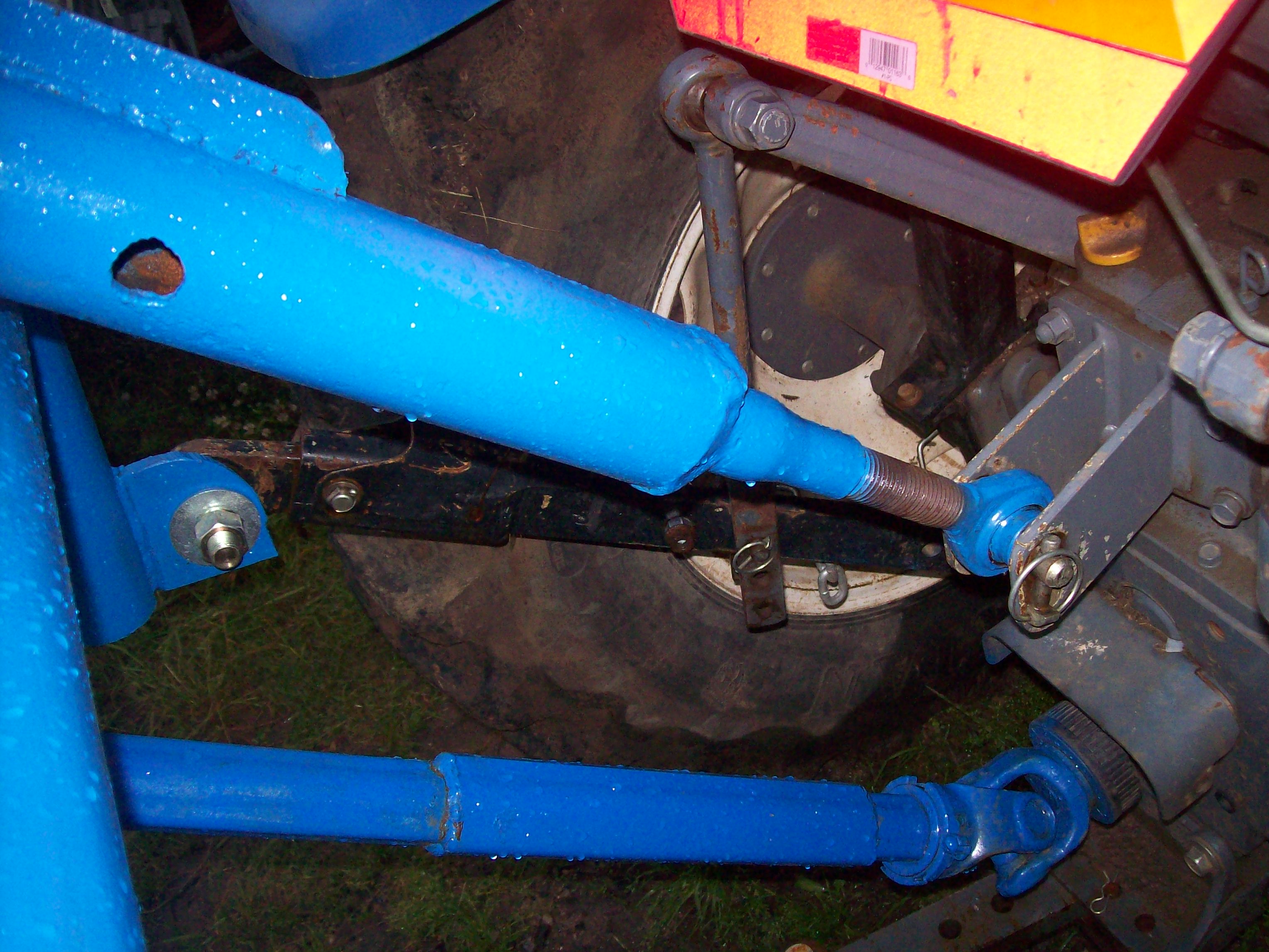

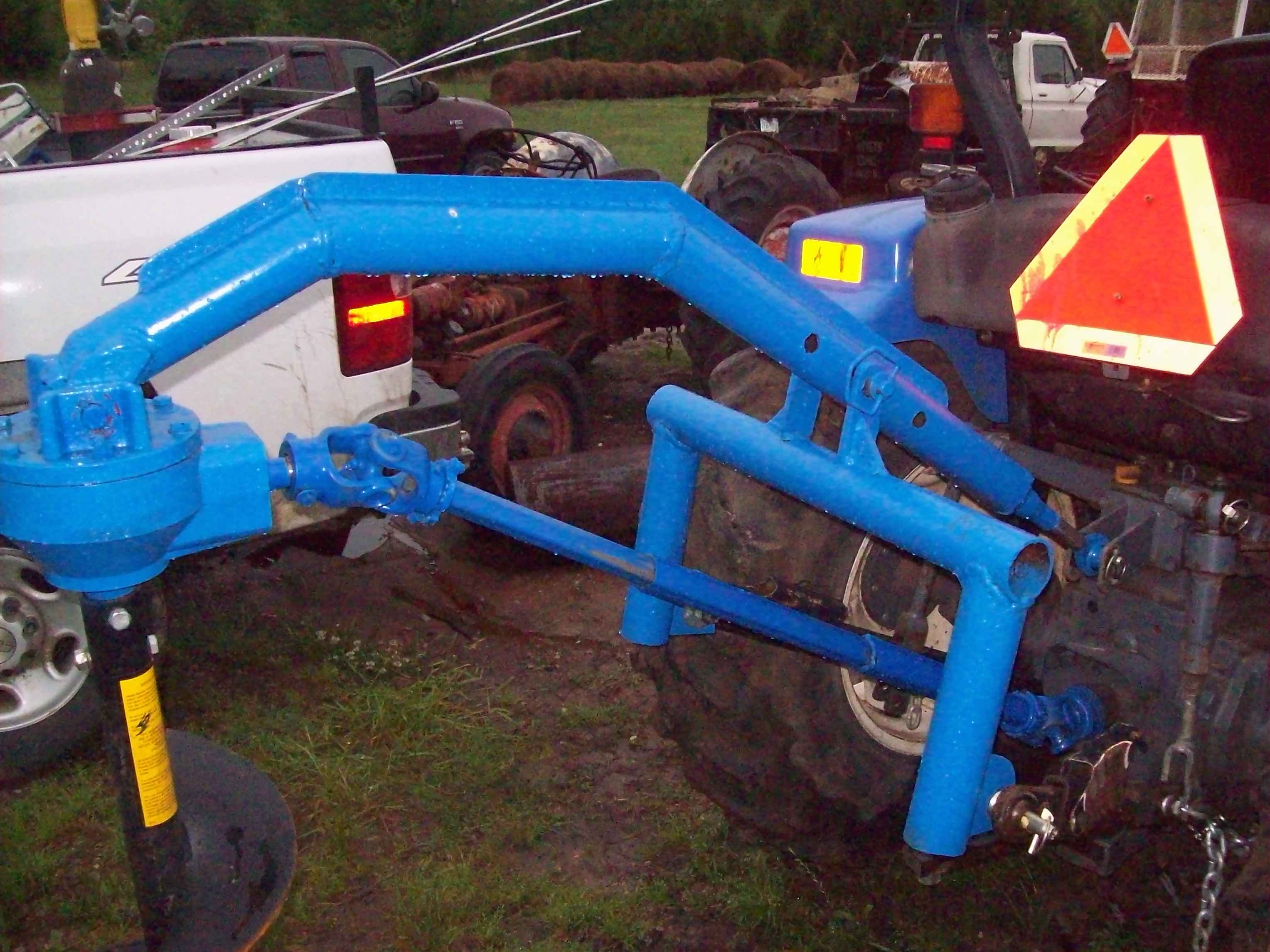

Heres a post hole auger I built, The tube is 2 7/8 pipe. I bought the gear box on e bay for 100 with shipping and also the auger for about a 100 with shipping. I had the driveline already I got about another 50 in odds and ends as well as gas and rods. 250 total. It works pretty good, although the tip on the auger is kinda cheap, I've alreay bought a heavier tip from TSC. The auger is a leinbach. If you count my labor I probably have way more in it but it was fun to build. I measured a buddy's speeco and made this pretty close demension wise. I had a heavy top link with a damaged end I added to the top for adjustment. Probably won't need to adjust it but the broke top link found a home anyway.

Nice work ! As long as I've been hanging out here on TBN...... this is the first home built PHD I can recall anyone making. :)

Nice work. Be careful around the unguarded shafts.

Excellent job. But really needs a freewheeling guard on the PTO shaft and a guard around the universal joint on the gearbox. Thanks for the pictures.
/ Homemade post hole digger #17
like a rubber bootty to keep the dirt out of the joint?possibly and old CV joint booty would do it.
