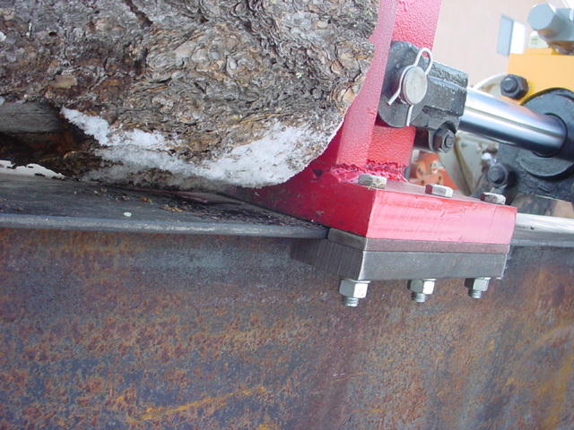

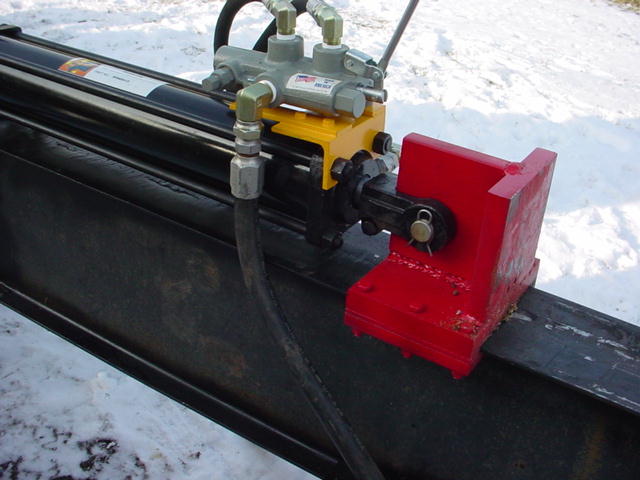

Attached are a couple of pictures of my home made splitter if you would like some design ideas. Most all the steel used is 1" thick. The I beam I used is actually 2 I beams from a mobile home trailer tongue welded together side by site to get me the 6" width I wanted. The hydraulic cylinder is 4-1/2" bore x 24" stroke x 1-1/2" rod (25 ton). The valve is from northern tool and is a detent return (auto return). I use the tractor hydraulics to run it with some quick connects. Not shown in the picture because I added later are some log catchers that catch the split wood off the wedge so I don’t have to bend over to pick it up.

The wedge is made from 1" x 16" cold rolled steel.
The knife edge was made by cutting two 45* on the band saw.

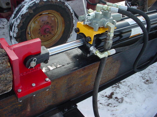

/ Homemade logsplitter design question #11
Here is a close up of them push ram plate.

Valve mounting to cylinder ends - this was (IMHO) a brilliant idea.
/ Homemade logsplitter design question #13
</font><font color="blue" class="small">( Valve mounting to cylinder ends - this was (IMHO) a brilliant idea. )</font>
Did you buy the valve mounting on the cylinder? Or is this something you bought/made seperately? John
/ Homemade logsplitter design question #14
</font><font color="blue" class="small">( Did you buy the valve mounting on the cylinder? Or is this something you bought/made seperately? John )</font>
Thank you for asking - the valve mount is home made. It's a piece of angle Iron cut out to fit around the end of the cylinder.

</font><font color="blue" class="small">( Thank you for asking - the valve mount is home made. It's a piece of angle Iron cut out to fit around the end of the cylinder. )</font>
Well, that's pretty work. I though for sure that was machine made. That's from angle? I never would have guessed it.
John
/ Homemade logsplitter design question #16
John -
That is the ultimate compliment - thank you.
look closely at the valve mounting bracket - I forgot to mention that I had to add 2 peices of 1/4" x 1-1/2" flat to extend the angle out to the full length of the valve. In a way it was machine made - I had to use the band saw, drill press & the jig saw to cut out the half round to clear the end of the cylinder. The Cylinder was purchased on e-Bay. The real tough part was drilling the 1" hole through 1" steel for the cylinder clevis. And OMG cutting all that 1" on the saw !!!!.
As you can also see I ran out of black paint and red paint. Yellow and Orange paint is all I had left - I used the yellow.
This thing exceeds all my expectations. I have since added another 6" tall blade on top of the one shown. But never took more pictures. Most all the material came from my "scrap" pile - what I like to call my"inventory" Well I thinks thats it for now - don't want to steal this post any more than I already have.

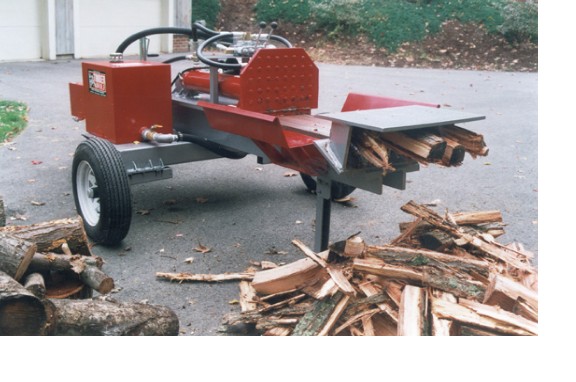

I found these splitters and thought the company had some really good designs www.timberwolfcorp.com I really liked the Tw-7 model, it splits the log in multiple pieces and leaves the piece to be resplit sitting on top of the wedge for a quick reload.
