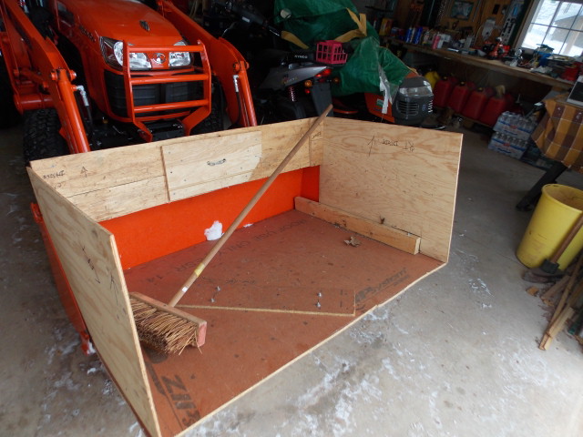

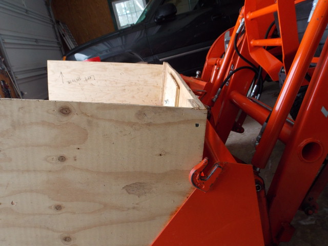

I had some scrap pieces of plywood hanging around. So this past fall, I constructed a leaf scoop to gather raked leaves. I also found the scoop gave me double or bettter bucket capacity to move firewood. The depth of the scoop is 42".

Good idea! I must have moved 300 FEL loads of leaves this past Nov, from the front yard to the back corner pile. Sure wish I'd seen this.

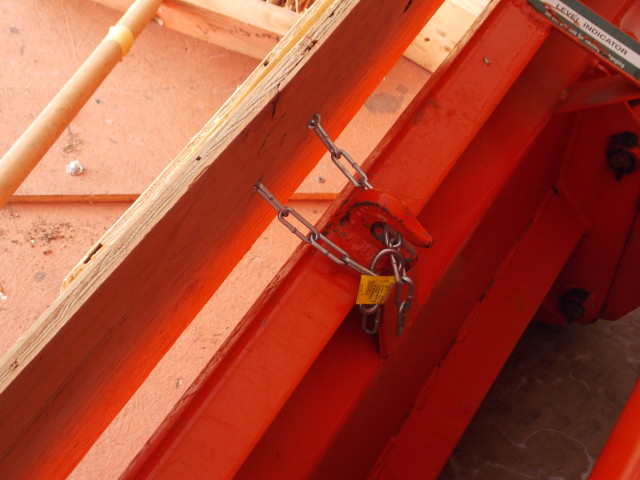

How do you keep the bottom from sliding out when you dump the bucket? Does that 1 chain hold it in? KW

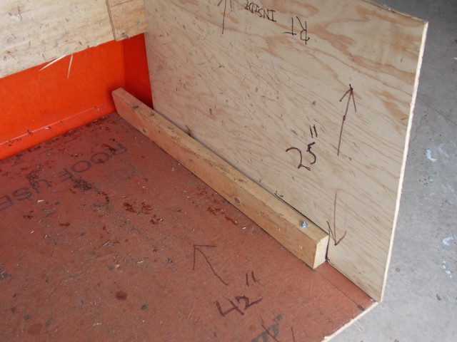

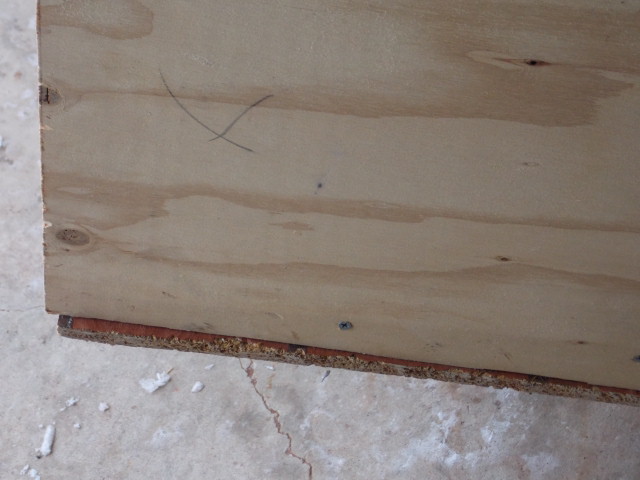

KW,
I attached a couple more pics for you of the scoop. There is no right or wrong way to do this thing. Just make sure you have about 1/2 inch of clearance on each end of the scoop between it and the bucket. I also used bolts to strengthen the 2X's attachment to the main piece.
Good luck.
