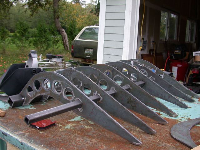

When I got my tractor one the projects that I knew I needed to work on was clearing all the blackberry brambles and other types of hard to pick up brush and debris.
I saw a really nifty grapple. But it was a bit higher priced than I was willing to spend.
So a bit of planning, plotting and computer time later here is the on going project.

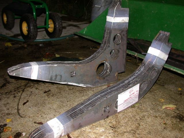

I designed the claws for the grapple with a drawing program and then exported the files as dxf files. I took the files down and had them plasma cut at a shop about 20 minutes from my house.
I decided on 5/16" - T1 for the teeth for the strength.
With all the parts cut I then tacked them with my wirefeed then used a dual shield process for welding the pieces together.
I am having my hinge pieces cut this week, the hydraulic rams were delivered this last week. So everything is coming together /forums/images/graemlins/smile.gif
I have a picture of the bottom part somewhere here, I will put it a little later.
In the mean time here are 3 shots.

Picture of Tacked Claw

This is in the welding booth in the welding class I am taking.

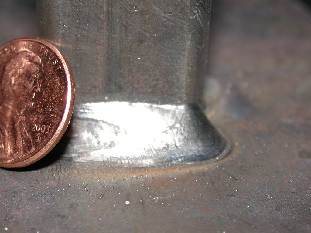

Here is a not too good picture of one of the welds on the one inch square tubing.
The evening classes at the Technical college let you work at your own pace.
I did oxy-fuel and stick welding (6010 and 7018 in all positions). This quarter I have spent most of my time on MIG welding. Solid wire, self shielded and dual shield.
I decided that dual shield was the best process to use here. I wanted good penetration and I could get a good weld with a single pass. The T-1 is 5/16 and the tubing is 1/4 wall on the 2 inch and .062 on the 1 inch.
I did this with the dual shield with .052 wire, I believe. I preheated the welding surface to 150 F before welding.
I have really enjoyed the welding classes. Since I have all the welders available at home (I swear my father collects tools like some people collect baseball cards) I wanted to know how to run all of the welders enough to do anything around the farm or auto work.
The classes are self paced and the instructors that I have both work in industry, one in the shipyards and one is a structural welder.
I will hopefully get some more pictures taken when I get ready to put the hinges together.
More pictures in a day or so.

You mentioned using T1 for strength. If T1 is like most alloys, you don't get any improvement until you harden it. Did you use prehardened plate and if so, how do you deal with localized annealing from welding and cutting? For example, where your small box tube penetrates each finger would probably be a bad place to have annealed. Or do you plan on heattreating the whole thing as an assembly?
