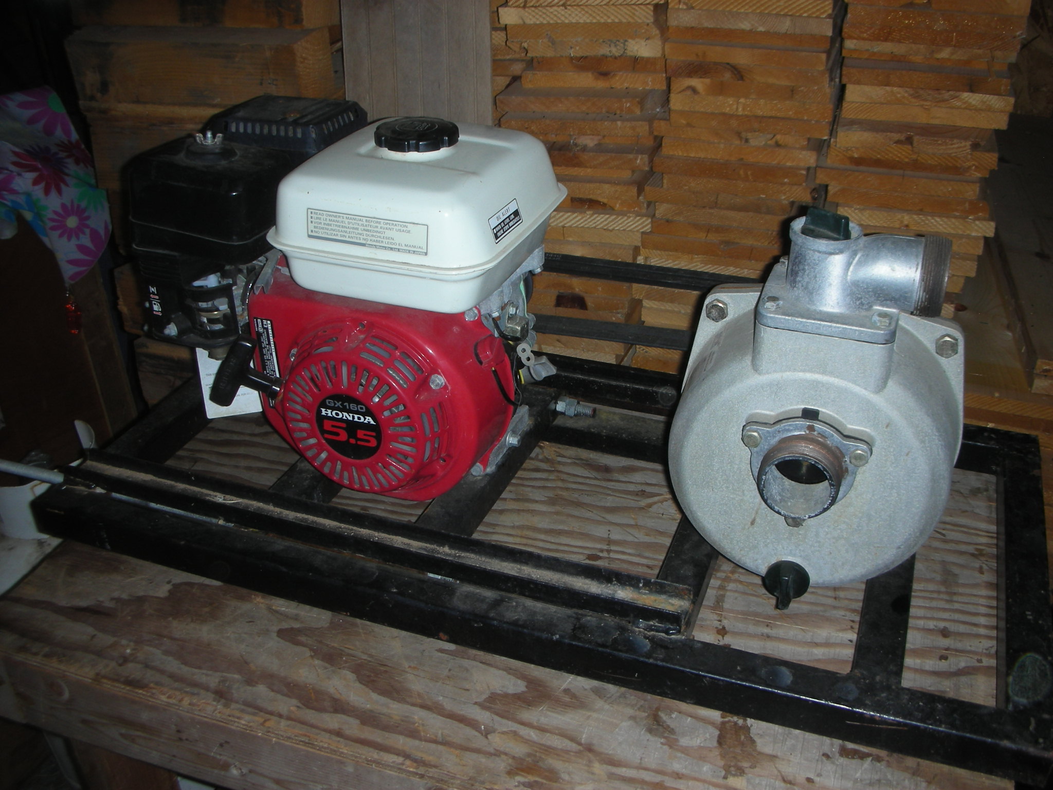

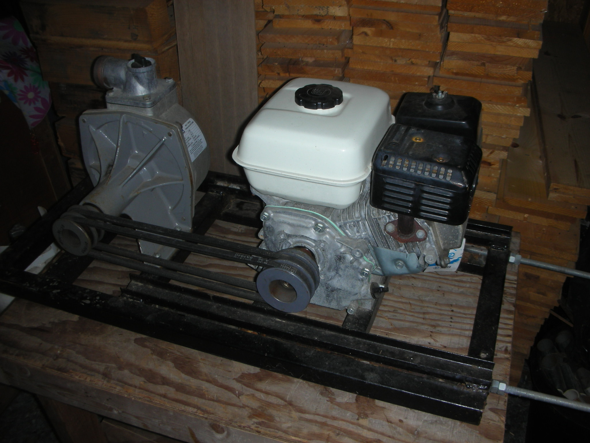

H. Saw your post. Had to reply cause it seems like I made the same thing you are looking to make several years ago. Works great. I got the pullys from Grainger. The engine slides in the frame to tighten the belts. 2 threaded bars and some nuts keep things tight. I bought used fire hoses from a place on the web.

Dear Geln, I got the hoses, nozzles, etc at: Allstar Fire Equipment, Inc. 12328 Lower Azuza Rd, Arcadia Ca 91006. Phone 626-652-0900. Used Single Rubber Jacket Forestry Hose 1" x 100' was $40.00 each (in 2003), 1 1/2" x 50' hose was $20.00 each. The Grainger items were: Split taper bushings 2L268 $5.66, and 3X572 $5.65, and Sheave- 3.35" OD Double 3X550 $40.50. These fit on the the 5.5 Hp Honda motor and the Northstar belt drive pump. For nozzles, etc, you also need reducers and adapters. The pump is 2" with different threads. Can get: Brass Reducer 14-155-7 2" NPTF X 1 1/2" NSTM, Red Poly Nozzle 10IPT-1" NPSH, Poly Red Fog Nozzle 10IPT 1" NPSH, Red Poly Nozzle 15NST 1 1/2"NST, Brass Hex Nipple 2" NPTF x 1 1/2" NSTM, Aluminum Reducer 1 1/2" NSF x 1"NPSHM. Their web site is: allstarfire.com. The hose I got was all retired hose used by various fire depts. Works fine for me. Still have it and use it occasionally. I did not see the hose on their web site, might need to call them. One thing to consider - practice using this stuff. 1 1/2" hose full of water is VERY HEAVY. You basically have to lay it out where you want to use it first, then turn the water on. 1" hose is easier to move and pull around. Also, if and when a fire starts, you have literally minutes to do something about it. Everything has to be ready to go when you need it. You don't want to look for hoses and nozzles etc. I have 4 stations (wood boxes) around the house each with a length of 1" hose, 1 1/2" hose, nozzles and adapters ready. I buried 2" pvc pipe to all the boxes. Each station can be turned on or off with a valve at the end of the pipe. I connect the 2" reducer to the PVC pipe so I can connect up the fire hoes. The start of the 2" pipe is near the pool. This way, if something happens, I fire up the enging, drop the suction hose into the pool, connect the pump to the pipe and I'm ready to go. This set up is easy to start as it is (no tension reliever, etc). The water does get hot if the motor is running and NOT pumping anything, so you can't leave it on all the time. Never had any problem starting the Honda engine, even after sitting for a year. The pump has capacity for 2 stations to spray water with the fog nozzles at the same time. Water shoots about 40' or more away. Lots of volume and good pressure. It dodes need priming and you want a foot valve at the suction end. Good luck!
