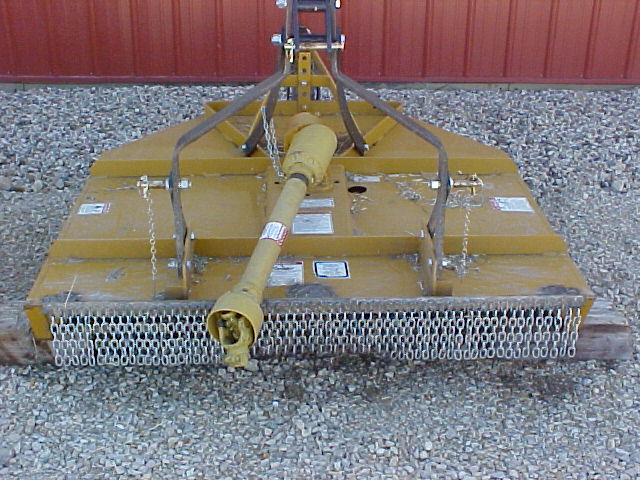

I finally took pics of my home made chain guard, works great!! Need 50' of 3/16 chain cut into 7 link sections. I had my boys cut mine with a bolt cutter, made it fun for them. I welded them to a piece of scrap angle iron and tacked it onto the mower

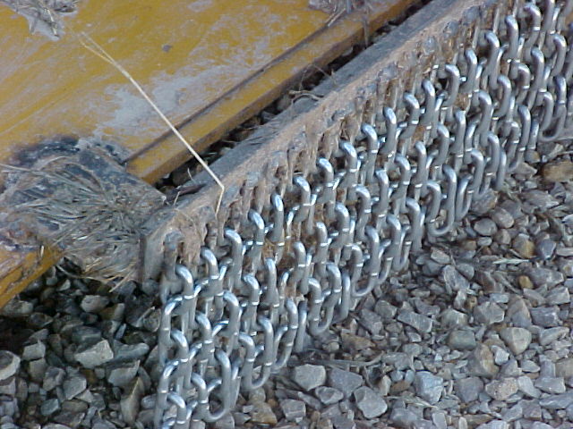

   / homemade chain guard for brush cutter
#2
a close up of the guard
Nick
   / homemade chain guard for brush cutter #3
Nice job Nick... /w3tcompact/icons/smile.gif
How did you make the middle spaced out further to prevent blade contact...?
John,
The center chains shortened themselves, oops
Worked out anyway, lessons learned
Nick
