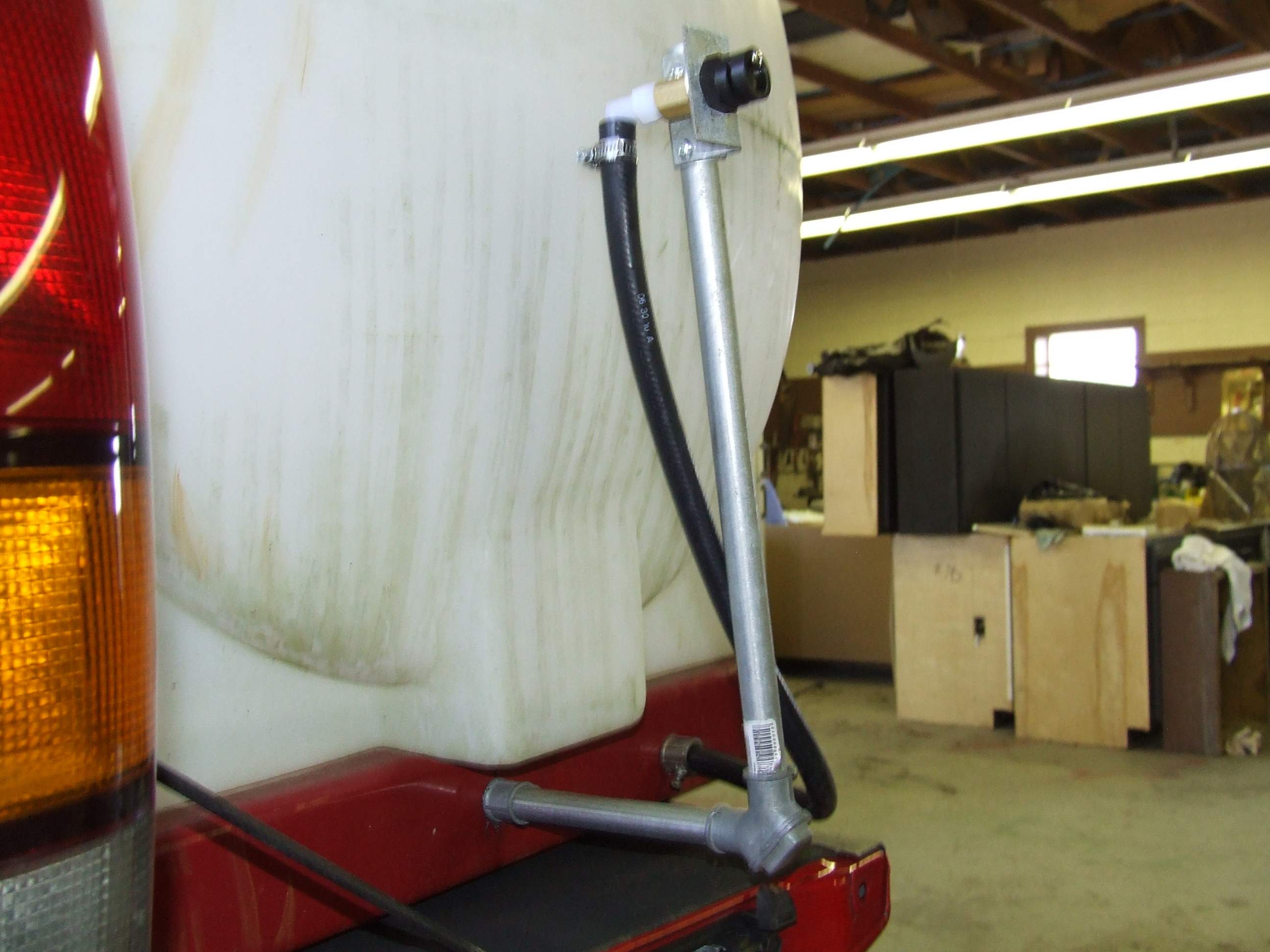

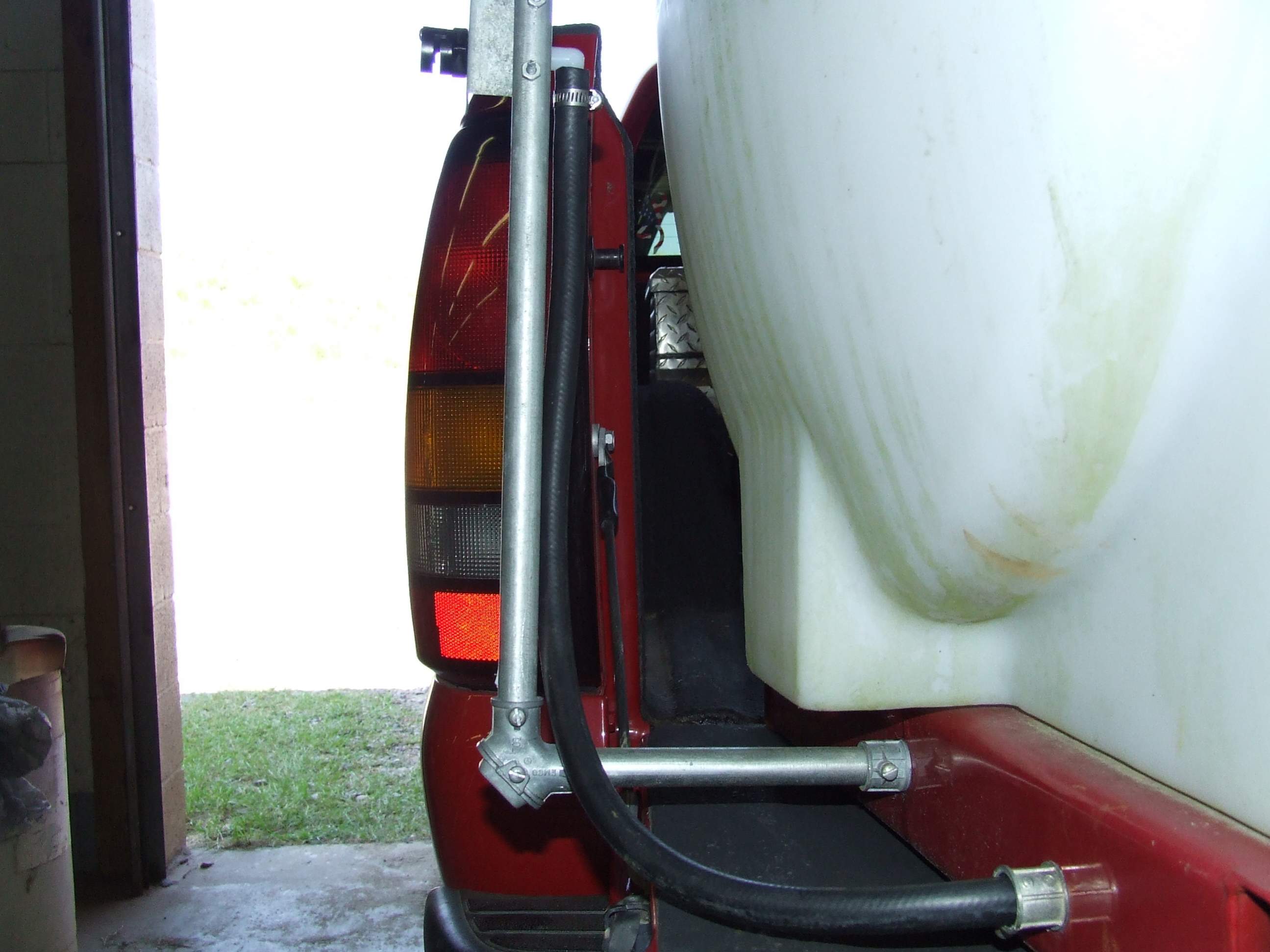

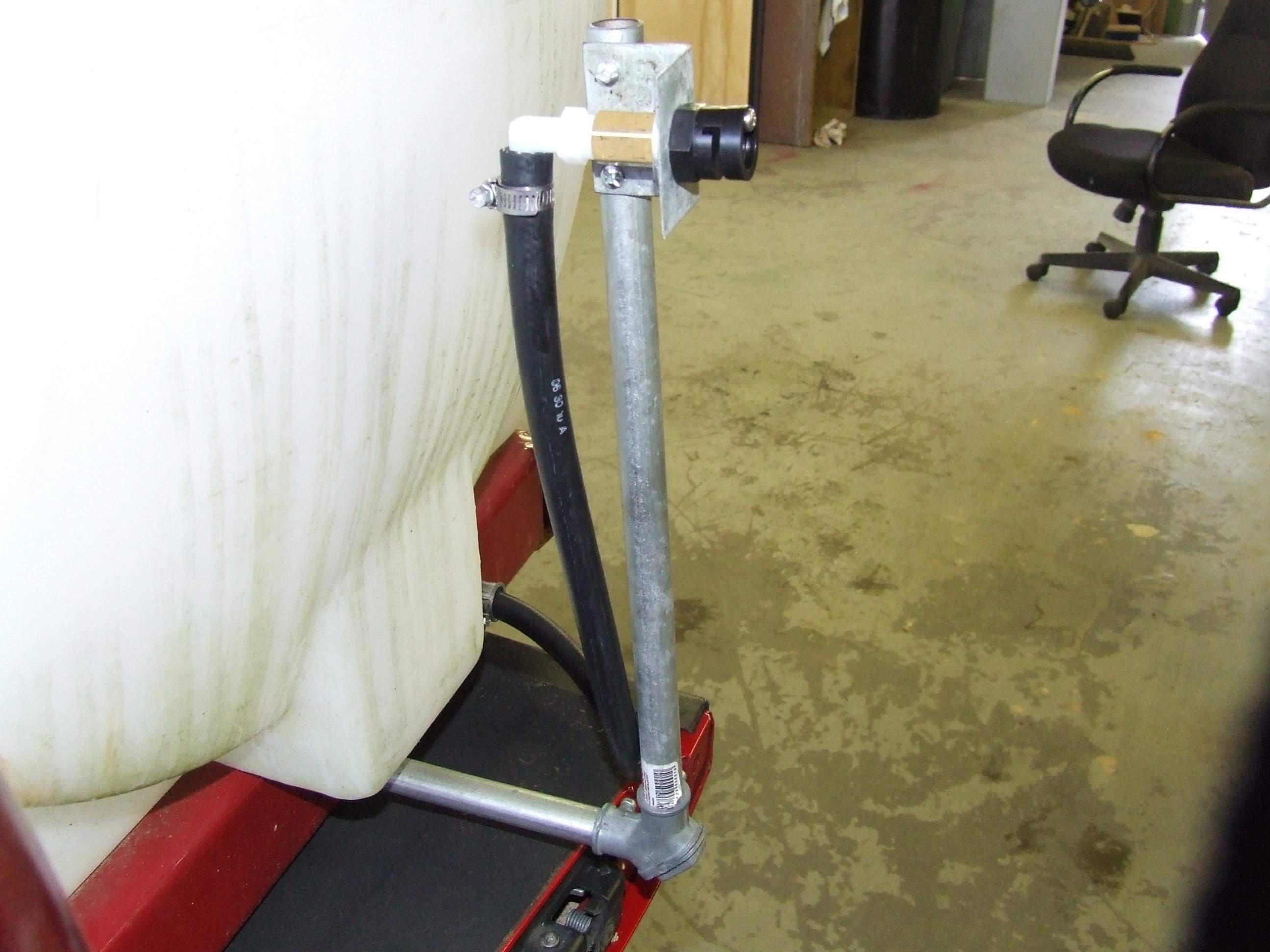

Chris, I am in the process of making a boomless attachment for my new sprayer. Bought a"as advertised" 16' spray nozzle from northern tool, Fabricated a bracket from 1/2" conduit with set screw tightening couplings.
This way I can spray behind or to the side with just a little adjustment. Don't have pix yet.

Chris, sorry I took so long to get the pix. Here is my "as advertised" by northern tool 16' boomless nozzle rig on my skid sprayer. By loosening at the elbow set screw and a little twist of the nozzle the boom can be moved to spray to the sides. Haven't had a chance to try it out in the field, have to build a carry all for it. It is a unused 65 gal rig that I picked up cheap.
The hand sprayer works great.
