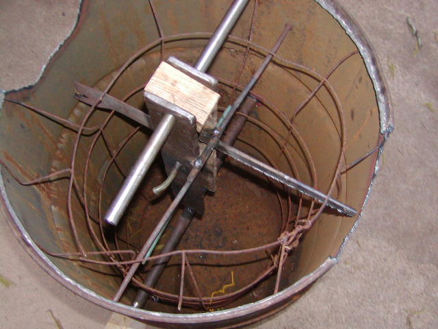

Joshua, things I would do different, after 2 years.. I would put in at least 1 more 2 inch pipe for tools. or maybe a 3 inch. I would put more scrap steel or scrap lead in the bottom for more weight. I have 750 lbs.. I could use 350 more. I like having the room on the top to store things. so the only way to get more in a 55 gal drum is to add steel or better yet lead in the bottom. I added 2 inch gravel in the bottom.. but I wish it would turn to lead:) The pipes are just so handy.. I could add some to the outside and I may do that. I added some 6 inch short pipes on top to corral the chains. keeps them more organized. Overall the barrel is very important to my operation. Helps keep the shiny side up, and is so handy to haul things. I use the 2 inch reciever for my sprayer, and have a 12 volt waterproof connector on the back of the tractor for power. I have other ideas for the 2 inch as well that do not include a trailer (I don't have one). Good luck with your build.
I'm kind of torn on this. On the one hand, I see the advantage. On the other hand, my property is relatively small and I seldom need to tractor around hand tools like that. I just walk up and get them from the barn, or toss them in the bucket. But maybe this is one of those things that once you have it, you don't know how you got along without it. And once the cement is poured, there's no going back to change your mind later.
I haven't got any scrap steel or lead laying around, so I would have to acquire it. I can see, though, that a full 55 gallon drum (without any tool tubes) would get to around 850 lbs (at 15 lbs a gallon for Portland). My manual recommends a rear ballast weight of 880 lbs without loaded tires, but I bet that a little more would be better to take some of that load off the front axle. Where can a guy get scrap lead from easily?
I am contemplating just sticking a ball mount in the back of the barrel, since I have an extra one of those laying around, and it would be nice to drag the trailer around without having to hitch up the big truck. Not sure if I am motivated enough to buy a 2" receiver... although it would be nice to have the variety, and they're only $20 or so.
on the top link connection I took angle Iron scrap and drilled holes to fit the draw-bar I had run thru the barrel and then drilled holes for the toplink pin and used bolts to the draw-bar..
I am not sure I am picturing this correctly. The angle iron scrap went all the way down the barrel and connected to the draw-bar?
The only welding I did on the barrel was some rebar cross braces to the 2 inch receiver I put in the back. to get that welded to the drawbar.. Welding with your head in a barrel is not fun. You might find a way to avoid even that much if you wanted a 2 inch receiver in the back ( I use mine all the time) by using all thread to bolt thru extra holes in the draw-bar.. The key is the premade draw-bar having all those extra holes in it.
I think I see where you are going. Drill an extra hole in the receiver tube and then bolt it to the draw-bar that goes through the barrel, to keep the tube from pulling out.
Thanks for the input, James and everybody else. This is really helpful.
   / Homemade ballast box - NO WELDING REQUIRED? #15
Yes I used 4 inch angle iron because that is what I had, but 2 inch would be fine. It goes all the way to the bottom of the barrel, and bolts to the drawbar, I remember I did weld a couple of little spacers to keep the spacing, but you could drill holes and use a little all thread and some nuts just as well.. If you want the 2 inch you could take it and have someone weld some little brackets you could run allthread thru and bolt the other end to the drawbar and once it all set up in the concrete it would be pretty sturdy.. you can get lead wheelweights from tire shops. They sell them for scrap. so I would think if you would pay a bit over scrap prices.. they would let you have them. or maybe a metalworking shop would have "drops" cut off pieces of steel you could talk someone out of.. Not as good as lead, but would work. It depends on how much room at the top you want to have left or just fill the whole thing with concrete.

We did just a little welding to ours, but found this inside picture, before it was poured. We used just junk we had on hand. We forgot to provide a trailer hitch before pouring & had to add one later to the outside.
Maybe you can get some ideas.
