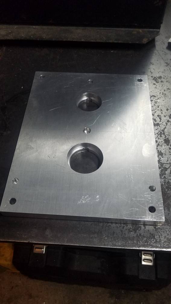

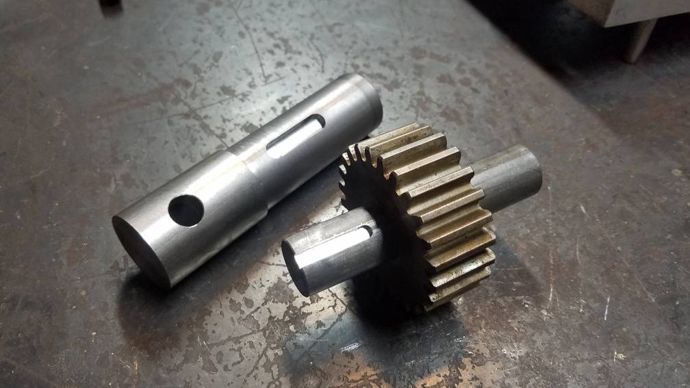

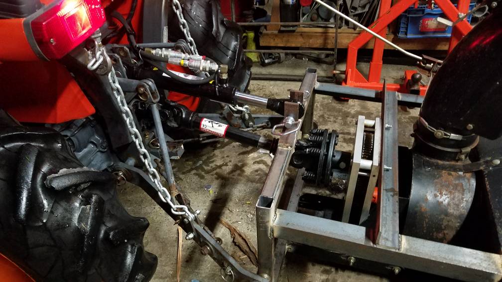

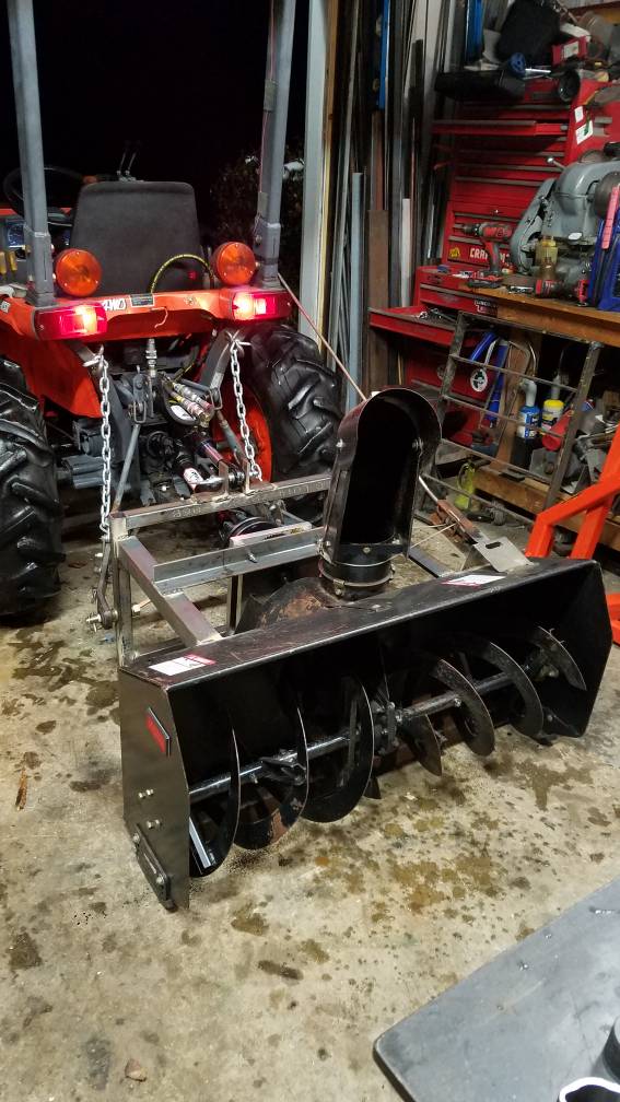

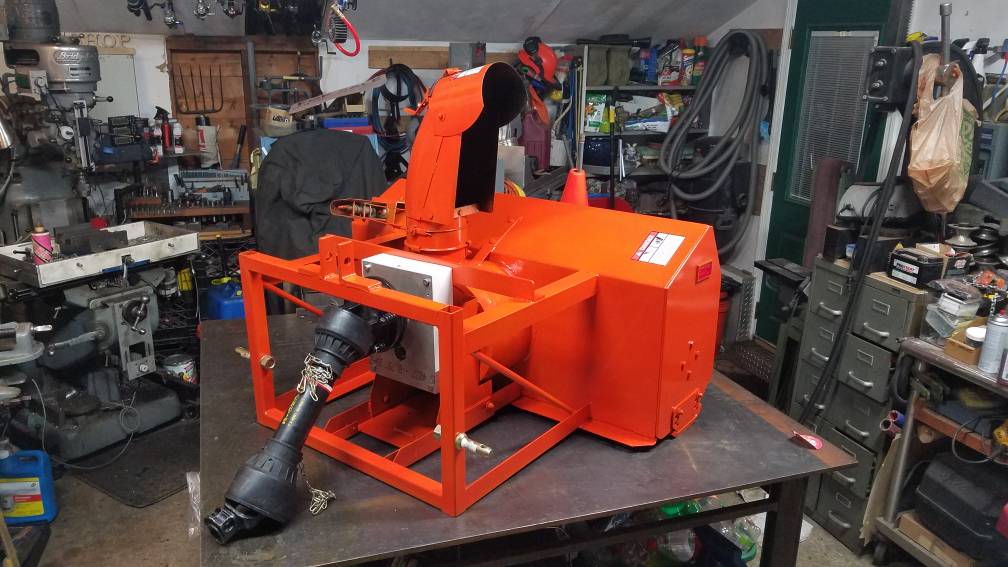

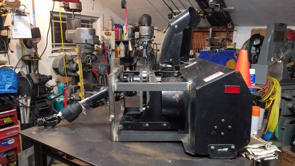

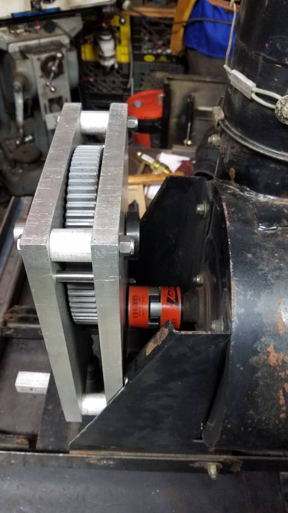

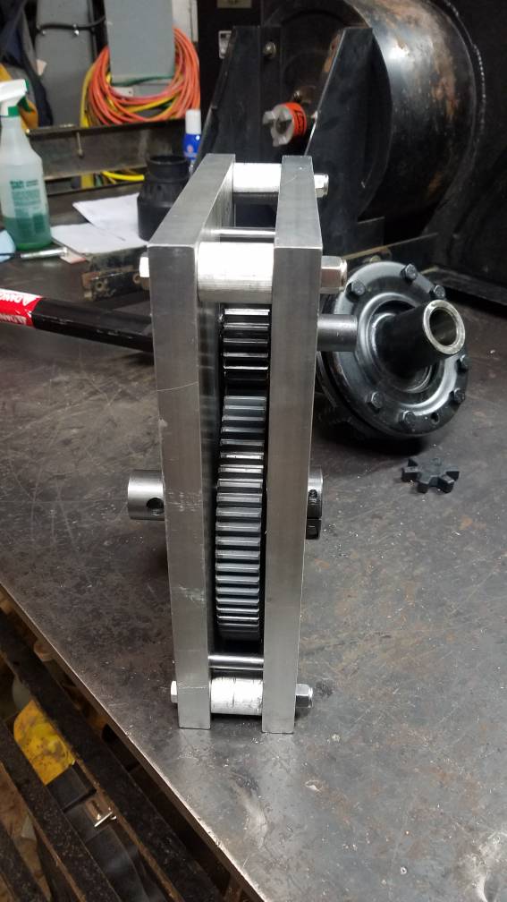

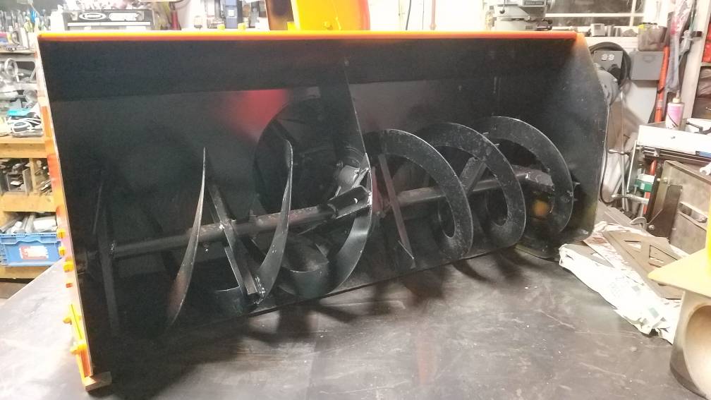

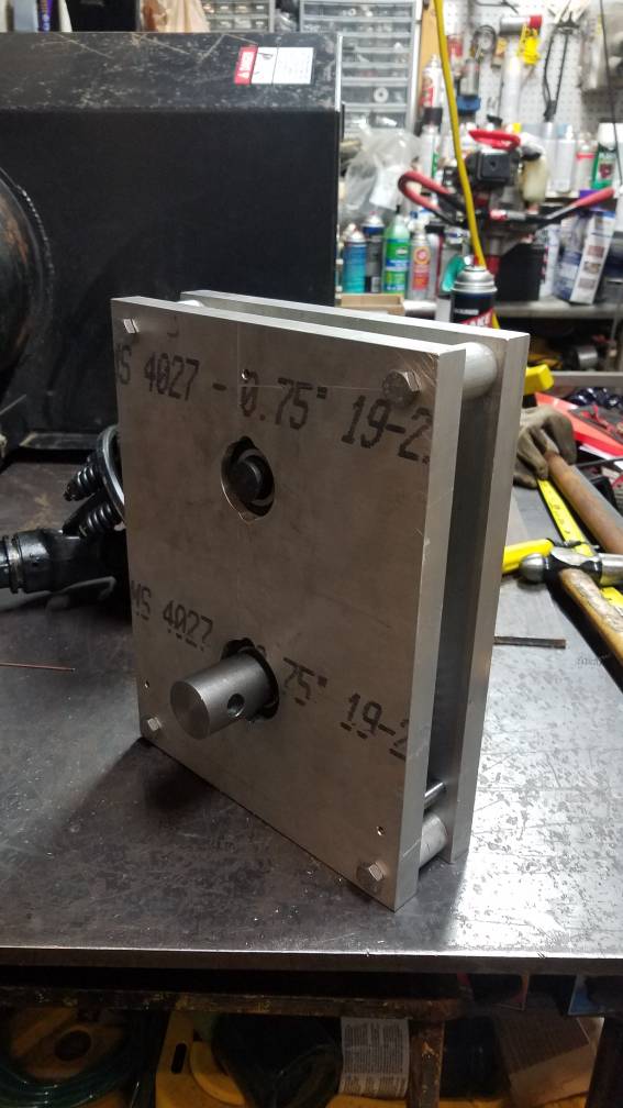

With the availability of cheap (or in my case, free) model specific garden tractor snow blowers I started toying with the idea of modifying one to be a 3pt blower.
I picked up a 42" deere front mount blower. The impeller was designed to turn counter clockwise at apx 1600 rpm. To achieve this I made a 3.25:1 gearbox with some surplus gears from eBay.
With some advisement from fellow TBN members I decided to cut my PTO shaft and tuck the blower as close to the tractor as possible. I welded up the 3pt cage to fit and now I can't wait for snow. 20191214_212108.jpeg20191214_212132.jpeg20191213_171516.jpeg20191213_171521.jpeg20191212_205143.jpeg20191210_211819.jpeg20191210_180322.jpeg20191210_204243.jpeg20191210_204246.jpeg20191208_182000.jpeg

I really like that reversing gear box.
I have a blower that turns "the wrong way" that could use such a device.
I like your shop!

How did you determine the gear ratio you needed?
   / Homemade 3pt Snowblower
Googled snowblower impeller rpm, the average was 1600. Checked my walk behind blower with an optical tach and got 1590rpm so I went with 1600.
1600÷540=2.96
Opted to go with a 3.25:1 so I can run the tractor a little slower or have some extra when the time comes.

The average of 1600 rpm was with what kind of blower? I can see that on a walk behind single stage blower but not on a bigger pto mounted blower. Every pto mounted blower I have been around was 540 rpm. I don't know what your impeller diameter is but following are examples of what your tip speed will be compared to my pto blower with a 27" diameter impeller.
27" diameter = 84.823 inches circumference @ 540 rpm = 45804 Tip speed in IPM
20" diameter = 62.8319 inches circumference @ 1600 rpm = 100531 Tip speed in IPM
16" diameter = 50.2655 inches circumference @ 1600 rpm = 80425 Tip speed in IPM
If you really are running 1600 rpm you will need to make sure the impeller is balanced well or it will shake you and the tractor apart.
Since it was belt drive off a garden tractor mower with little ratio change the the 1600 RPM range is right in the ballpark.
Regardless I tried it last night and it blows snow. Now I just need to tighten up the 1/2" impeller/drum gap.
