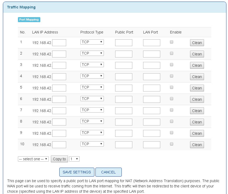

The basic question stands, has anyone had any success with using video doorbells like ring, video systems and home security systems with cameras you can access online with Hughesnet.
First of all, the recurrent theme in your posts is a high degree of anger. Sorry to be blunt, but if you can't corral that you will have no patience for working with technology. I understand how frustrating it can be to work with technology-- especially when it is not working-- but getting upset will make it more difficult, not less difficult.
I don't understand your complaints or issues. I have Hughes net. The administrative interface lets me open it up, access the firewall, open and redirect ports as I want. Perhaps you have an older system but what I can say is that my Hughes system allows about the same configuration control as other systems I've used.
The dynamic dns works great and I believe its all-in cost is $15 per year. If your camera/security systems are not capable of always being reachable behind a dynamic IP address, the dynamic dns is your solution. dyndns.org I believe is the web site.
I am running inexpensive camera systems I bought at Costco to monitor my property. It updates itself so I don't need dyndns. From anywhere in the world, I can open an app on my phone and view the cameras at the property. A ring doorbell is no different-- I don't have one but I am sure it would work fine. If you talk back/forth there might be some latency (delay) but you would have to try it and see.
So, to answer, it seems I am doing most or all of what you want to do. Good luck and I hope you find the solutions you want and need.
Enclosed is a screen shot of my Hughes port forwarding page.
