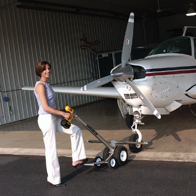

Here's an idea... Use a cordless drill for the power source. Lots of torque there. When you're done, unchuck the drill and use it for something else.
