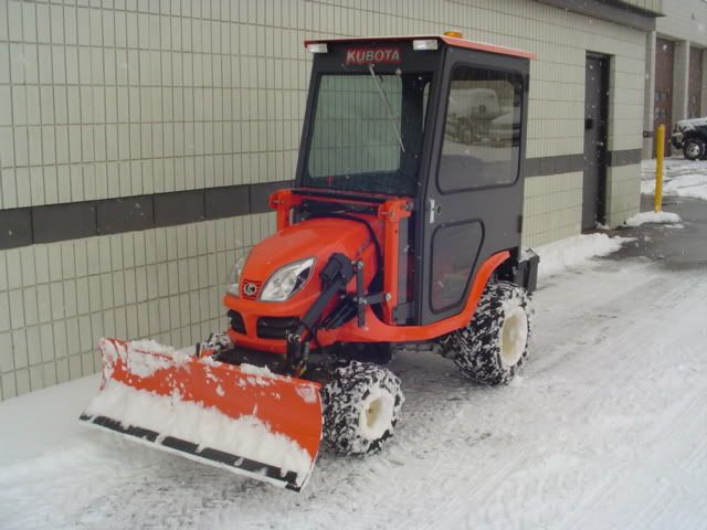

WOW, that is one very NICE cab set up you do very good work. :thumbsup:
   / Home made tractor cab #12
I saw this thread, opened it expecting to see something built out of OSB or plywood, boy, what a surprise. You did a fantastic job!
   / Home made tractor cab #13
Hi Jason
I purchased the wiper motor at Surplus Center and bought the wiper arm from my local auto parts store . The wiper arm is a universal with adjustable length, the shaft on the motor is a common size.
The heater was purchased at https://www.tractorpartsasap.com/Auxiliary_Heater_p/111417.htm yes it has a 2 speed fan. I tapped into the thermostat housing for the supply to the core it is British pipe thread but standard pipe is close in size and works just fine. As for the return to the engine I cut the lower rad hose and made a tee to install in it. Heater works great only takes 5 min to get heat when cold. Hope that helps.
Looks familiar;
Very nice attention to detail. I wonder if the heater will keep up with the radiator fan pulling warm air back out of the cab? Is the roof noisy?
