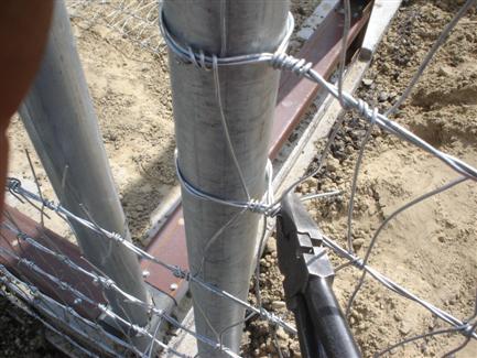

V Mesh installation is hard work if you do it right. Trick tools help. But the rule of thumb is that it's pure hard work.
When I'm terminating the fabric I carry a five gallon bucket for wire clippings. With V Mesh there's a ton of wire clippings.

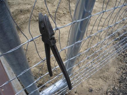

I've found end nippers (side cutters with the blades turned ninety degrees) best for cutting the vertical wires. I cut the wire as close to the twist as possible for the part that's staying and in the middle of the vertical space for the rest of the cut.
I don't wear gloves unless I'm welding or it's cold. The vertical wire ends are like working with needles who've got an attitude. If you're not used to a little blood I strongly suggest gloves. However, letting a little blood is supposedly good for you healthwise I've heard. It also silences the critics. /forums/images/graemlins/grin.gif
The object is to remove the vertical wires from the horizontal ones for the wrapping of the end post.

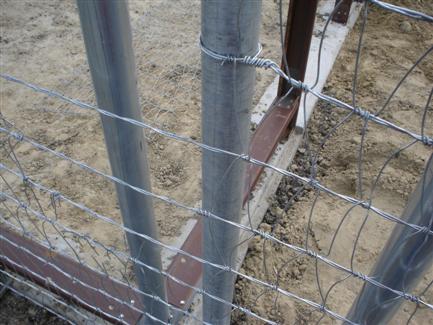

On that last picture I hope you noticed the finished ends. That's important. The same sharp ends of wire that tear your hands up do the same thing to the noses of horses and other livestock.
Bloody noses aren't cute. No matter how you get them.

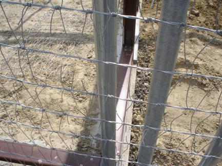

I've found a digging bar works great to help me pull the fabric down to grade. Here I didn't have the butt (dead weight) required to pull it down. But my tractor had that much and more. /forums/images/graemlins/grin.gif
