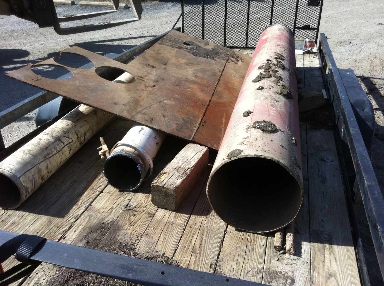

I just registered the other night, and thought I'd post one of my projects. With the cost of heating going through the roof, and my cousin having a few hundred gallons of waste motor oil laying around, i thought I'd make an attempt of building a hot water heating system to beef up the heat in my garage and downdstairs when it gets cold.
The basic idea behind this is to get a large pipe, run some exhaust pipes up through it and cap the top and bottom with water tight welds. There will be two 2" bungs to allow for water circulation through the system...

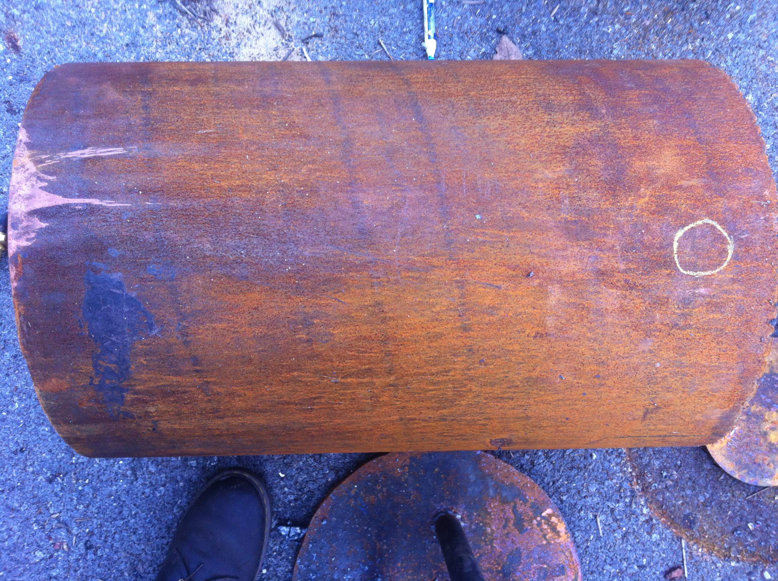

During a salvage yard run, I managed to score some 16" diameter 1/2" wall pipe, and some 1/2" steel plate to serve as both a top & bottom cap of the boiler. The exhaust pipes that will take hot gas from the waste oil burner, up through the boiler is some 1" black iron pipe.

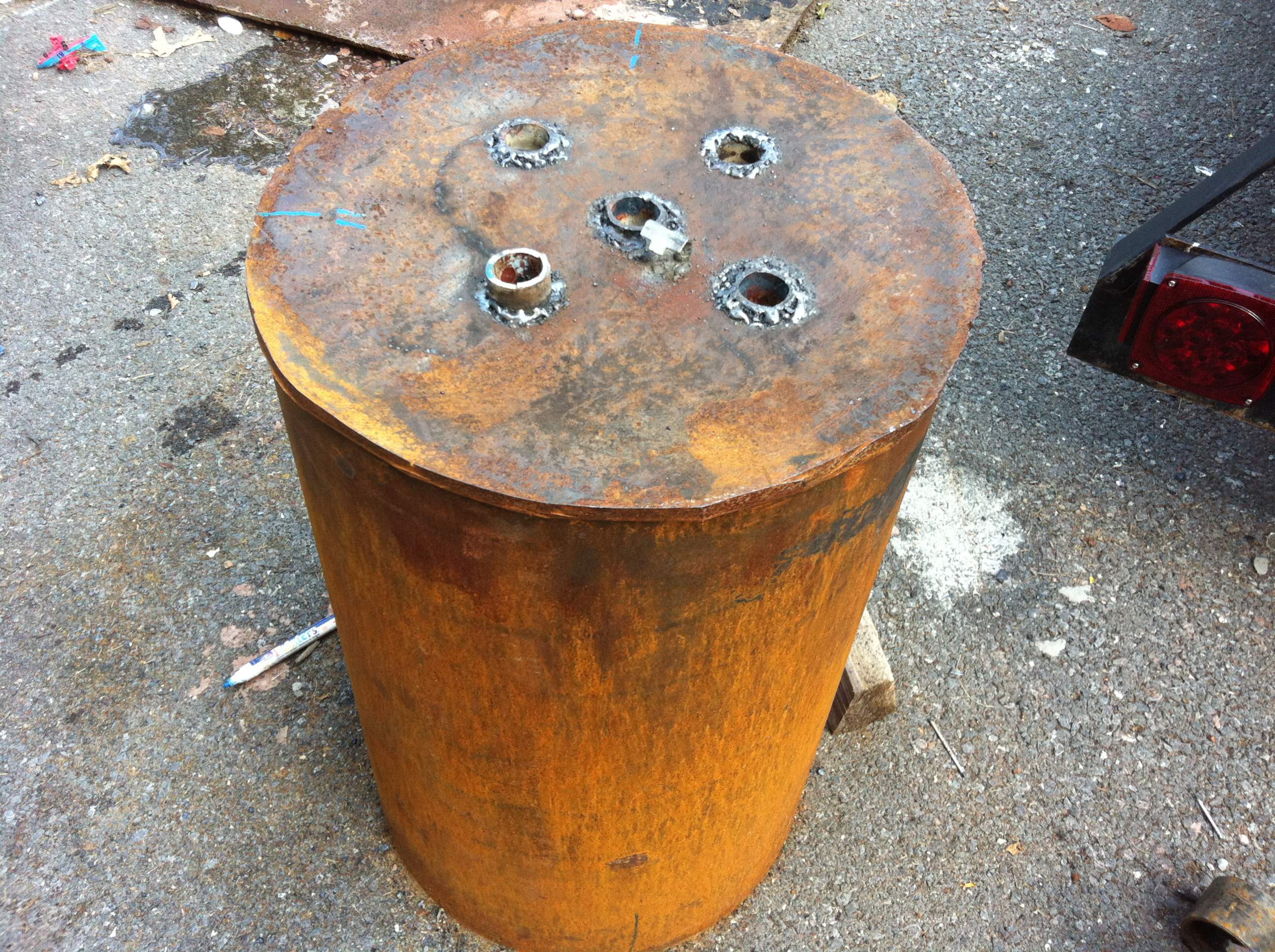

I'll have to upload some pictures later, but so far the top and bottom plates have been cut, and the 5 holes in each side cut out to accommodate the black iron pipe. The pipes have been tack welded in, and just tonight I managed to get an old stick welder out and weld up the pipes in the bottom plate. Keep in mind that this is my second welding project and I've only been welding for a couple months.
In the grand scheme of things, I want to have a cast iron radiator in the garage and setup radiant floor heating in the downstairs of my home. I figure the hard part will be building the boiler and making it water tight. After that I'll focus on an intermediate holding tank for the hot water (since the unit itself will only hold ~ 17 gallons), and running the PEX into the house about 50' away from the burner.
Managed to score pipe for the chimney (8"), and enough 16" diameter pipe to make a few boilers (and a nice piece of 1/2" plate)

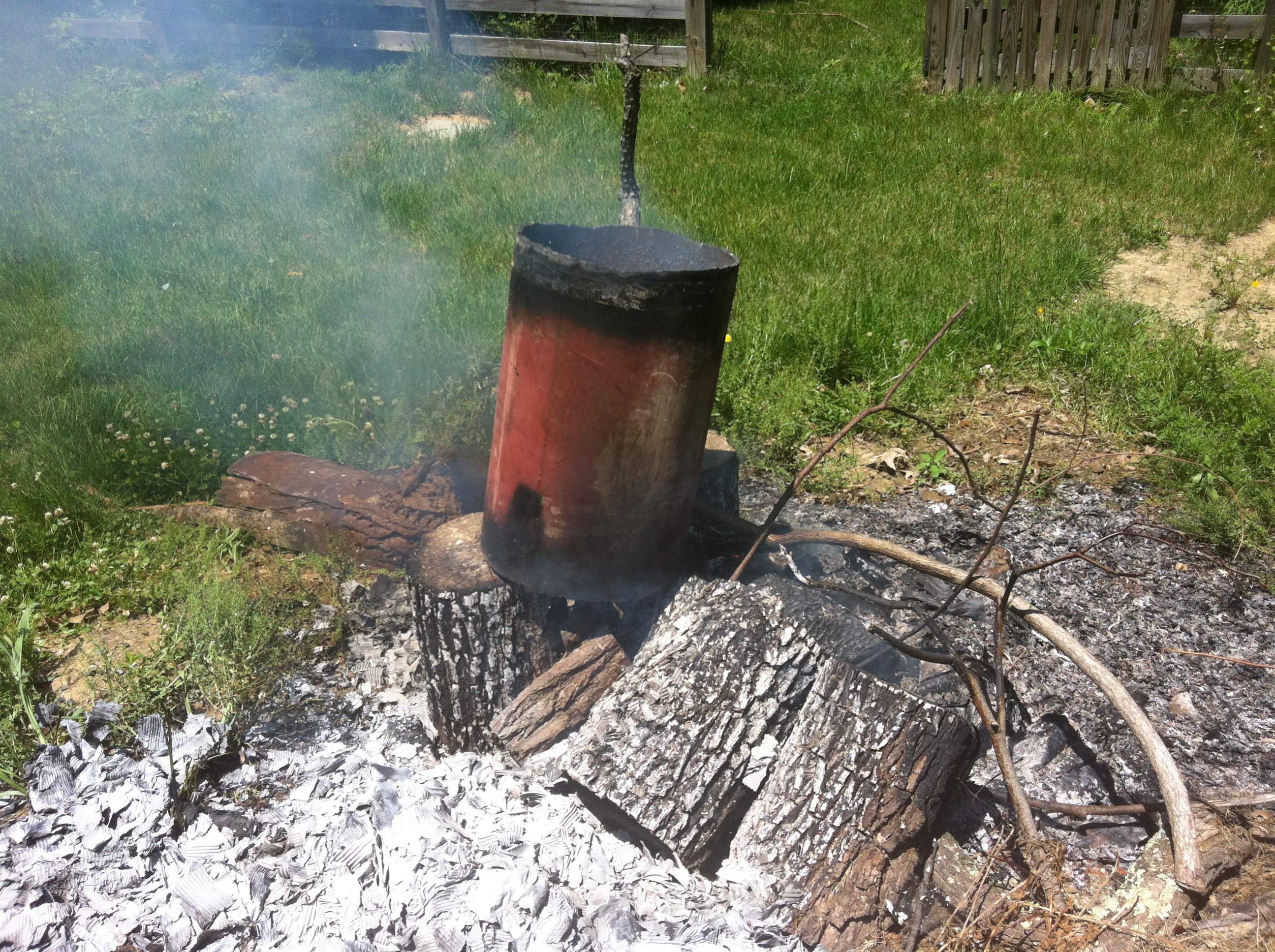

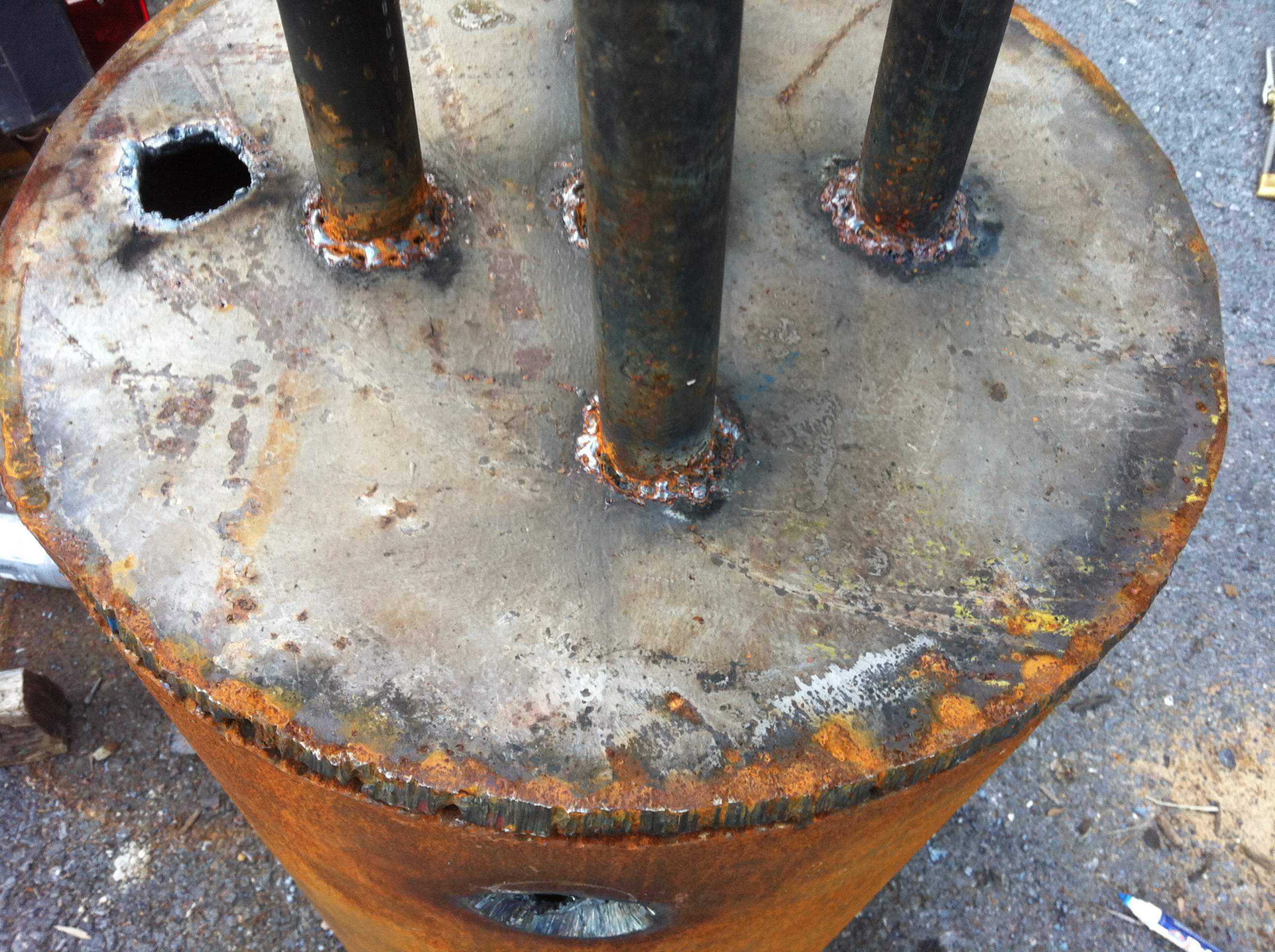

Had to burn the paint/tar off of the casing (24" tall x 16" diameter)

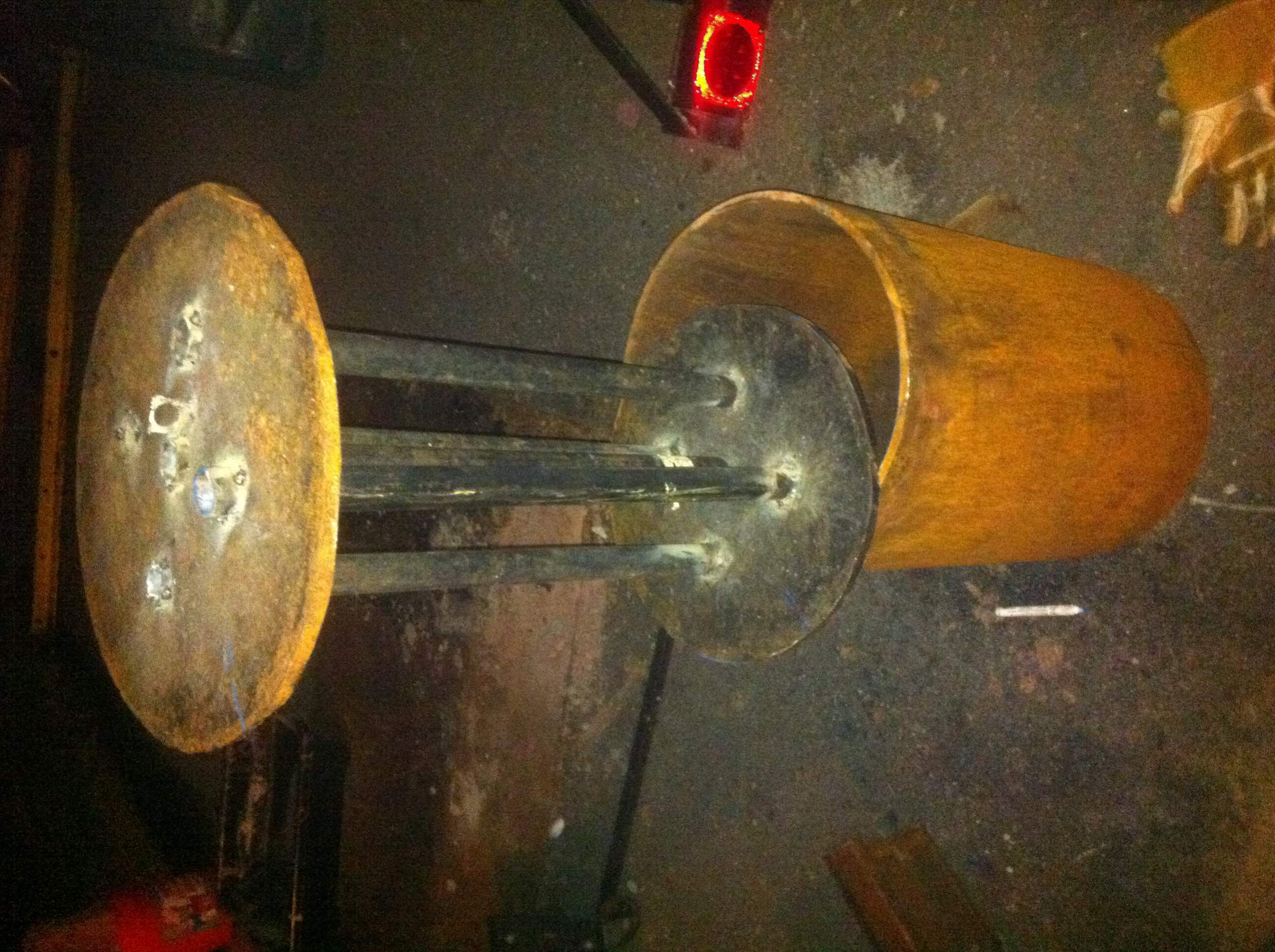

The boiler core with the five 1" diameter exhaust pipes running through it tacked in place. will MMA it with 6011 to hopefully make a water tight seal

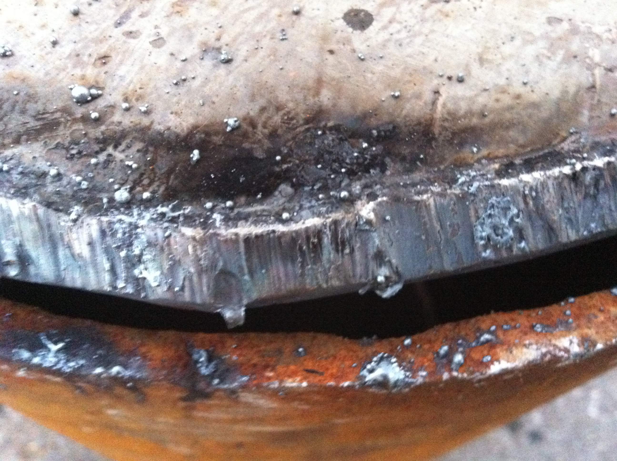

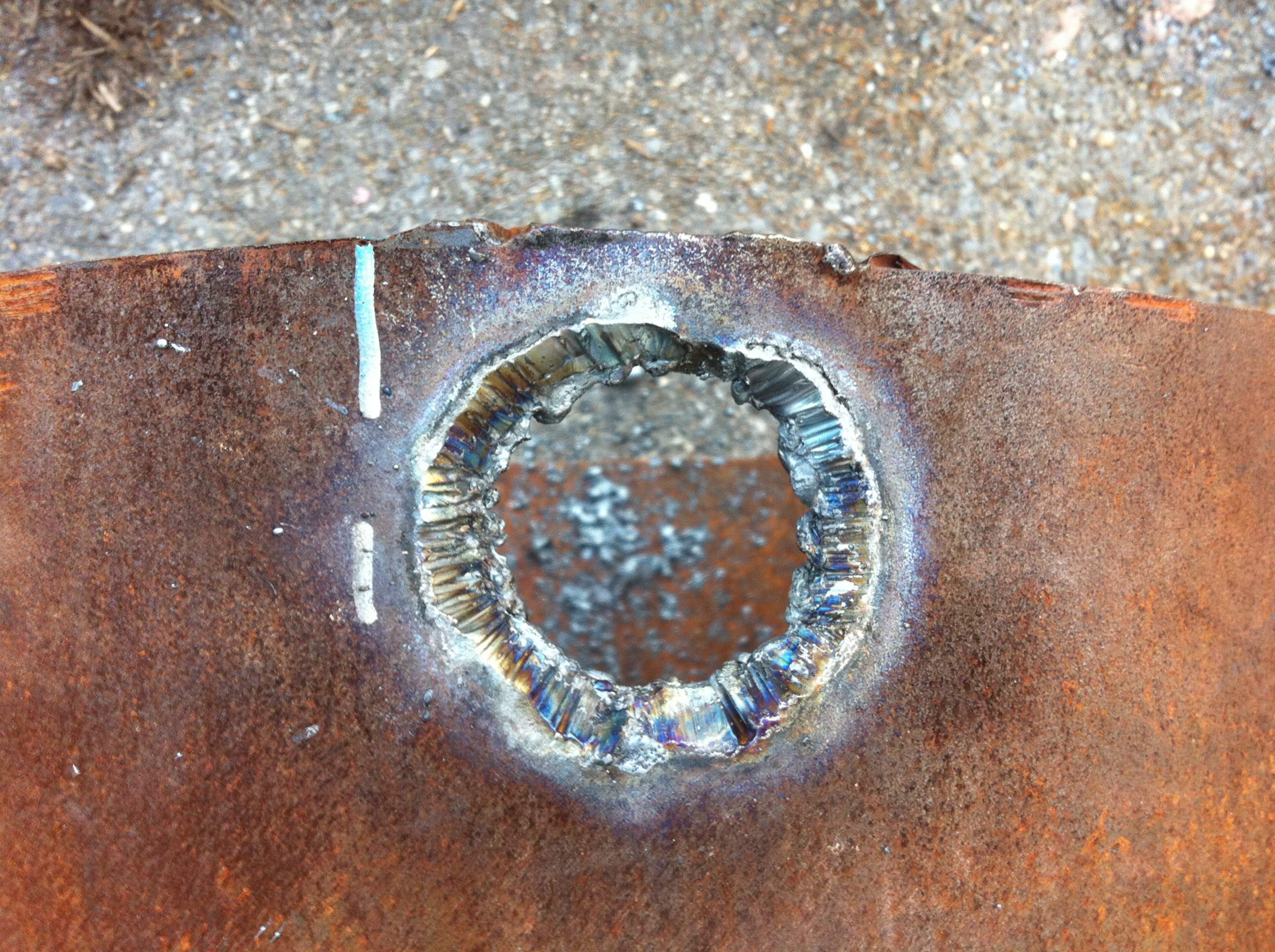

Managed to get a bit more work done on it. In order to ensure that I get a good weld, I took the time to take the oxy torch and attempt to bevel the edges of the various cuts that I made. Two holes are in the side of the tank, one at the top, one at the bottom that will accommodate two threaded 1" couplings.
(top hole - bottom hole not pictured)

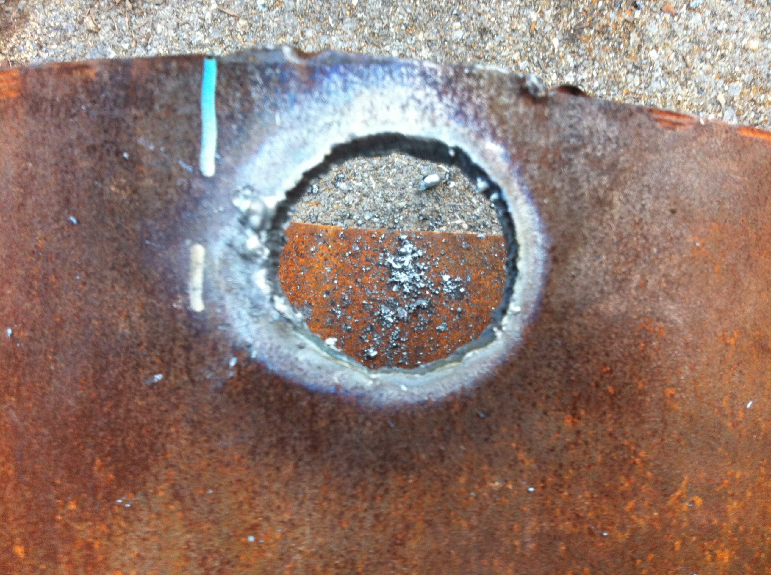

At the top, I cut a hole to allow for a pressure relief valve in the off chance this thing actually produces pressure in an open-system configuration.
And Before I called it a night, I then beveled the edges of the top and bottom plate...
here's some close ups of the beveled edges - i'm planning on hitting them with an angle grinder to clean them up a bit... I'm still new at oxy-acetylene cutting so it's not very clean..
(bottom plate bevel)
(top plate bevel)
When it's all said and done, the piece i was cutting on should slide right into the outer casing something like this:

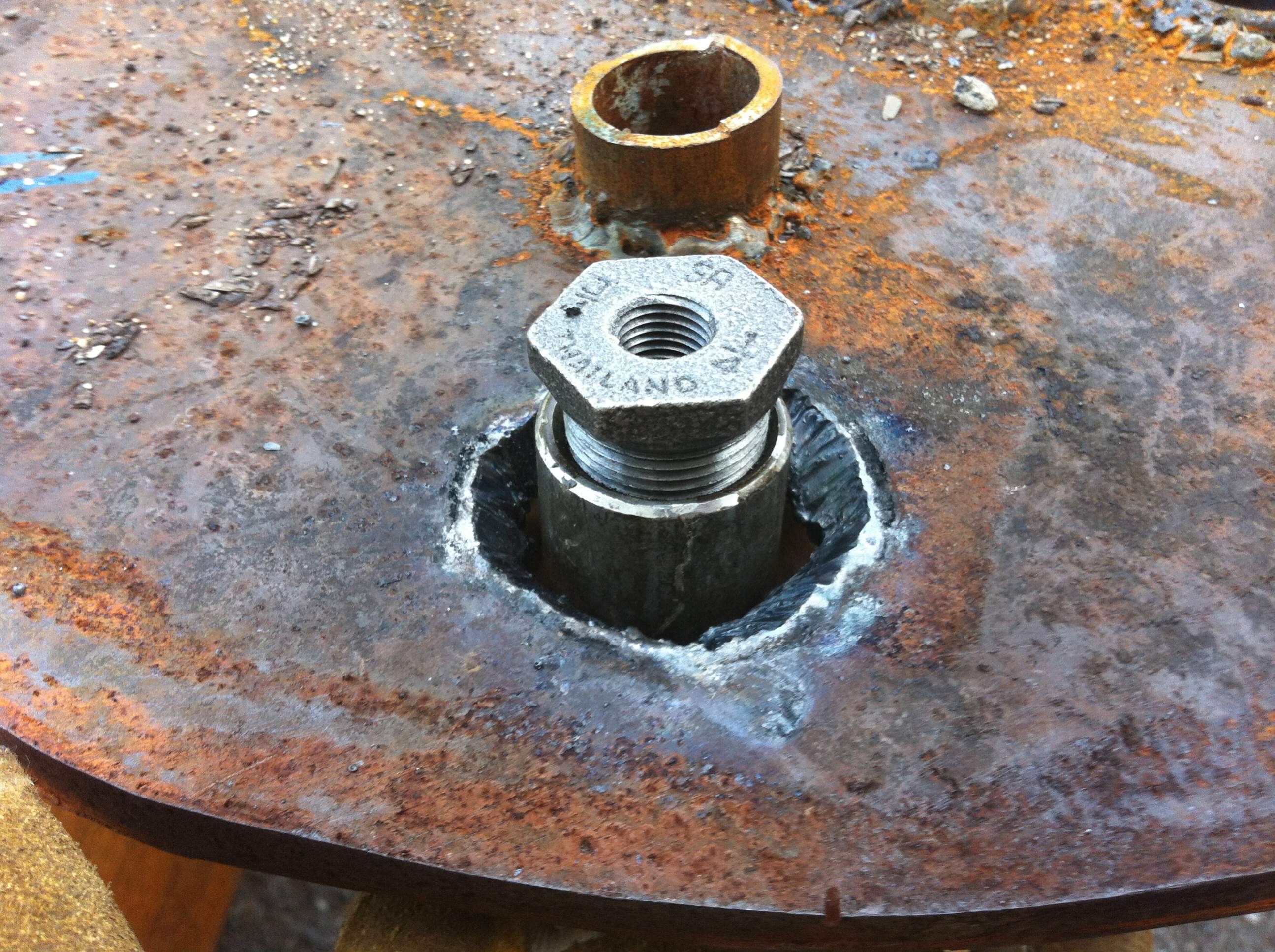

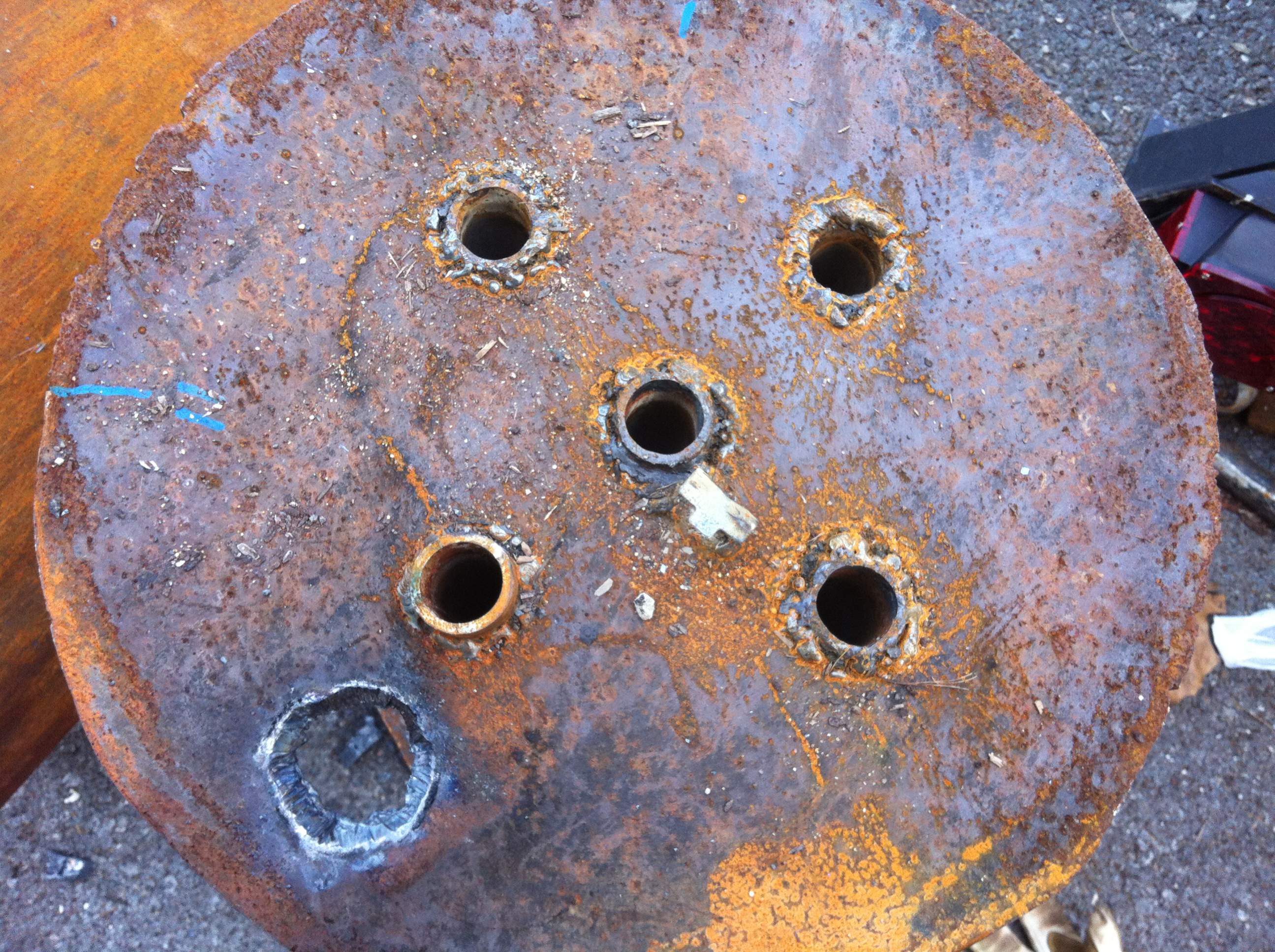

Managed to get some fittings welded into the holes that were cut in the top and sides.
Top bung - 3/4" with 1/4" bushing for pressure testing
Water outlets to circulate the water 1" bungs welded in-place. They are ground flush to allow the center bits to slide in for welding
Tractor supply primer painted on there to prevent rusting. I have a feeling this may cause some problems in the future - but hey, it's the first that may not work anyways :)

As Chim said, the surface area seems really limited. Before you weld it closed, maybe put a baffle of some design to make the water pass back and forth over the tubes and be more turbulent.
At least you probably won't have any condensing problems in the exhaust system and it will be fun to see how it works. Then you can make the next generation and address any weakness.
BE SURE TO USE A PRESSURE RELIEF. A standard hydronic relief is set a 30 PSI, or are you planning on running the system at higher pressure?
