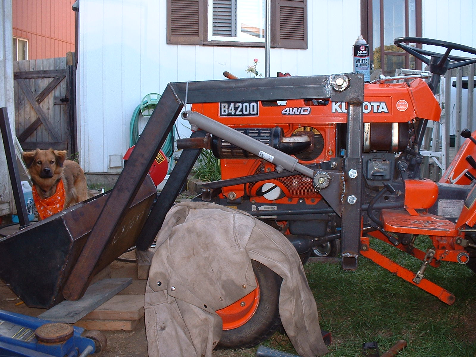

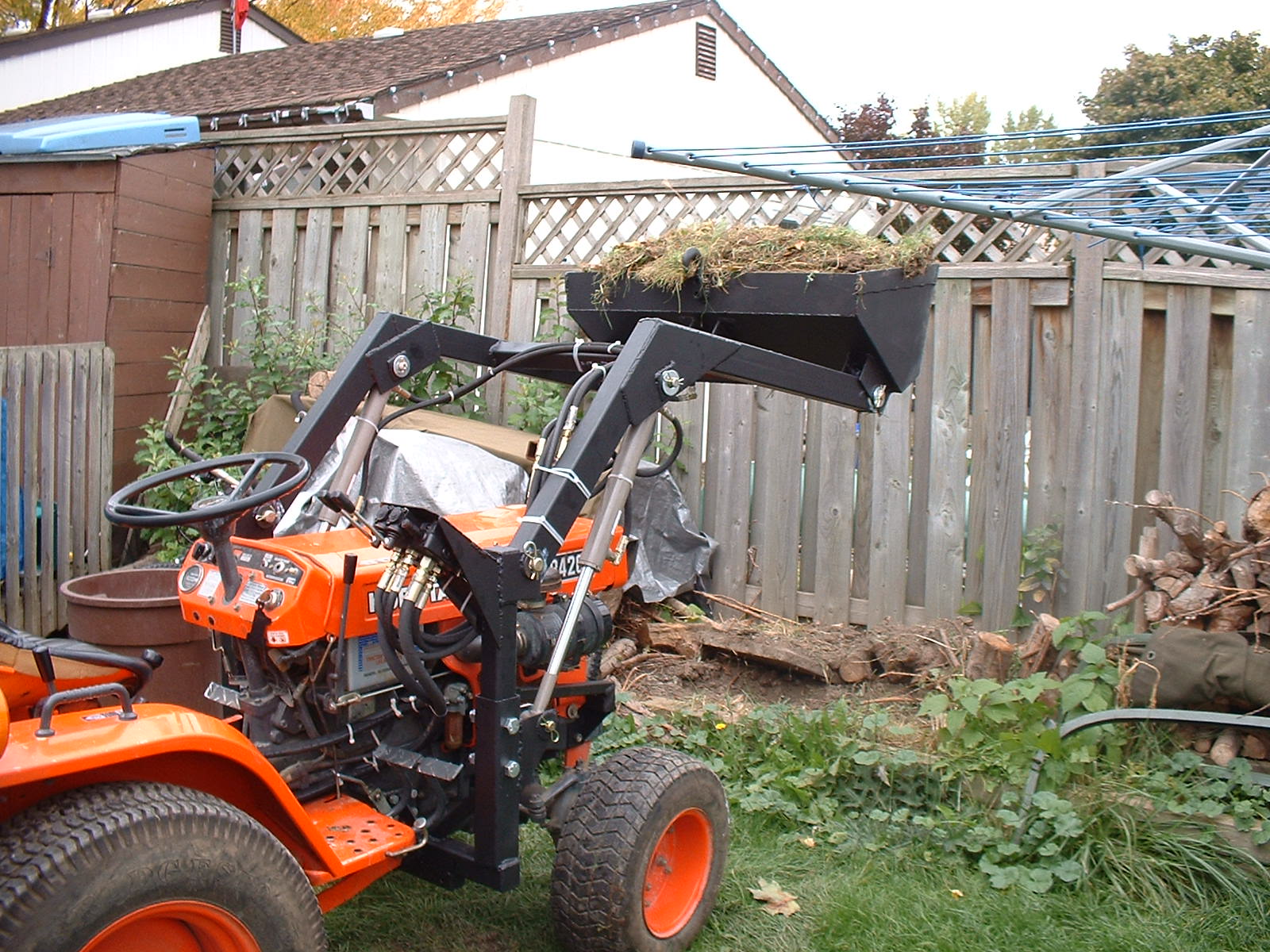

With a 12 hp 3 cyl diesel, my Kubota B4200 is not much bigger then a Lawn tractor. This is my homemade loader with 36 in wide bucket. I have seven hard years on it now.

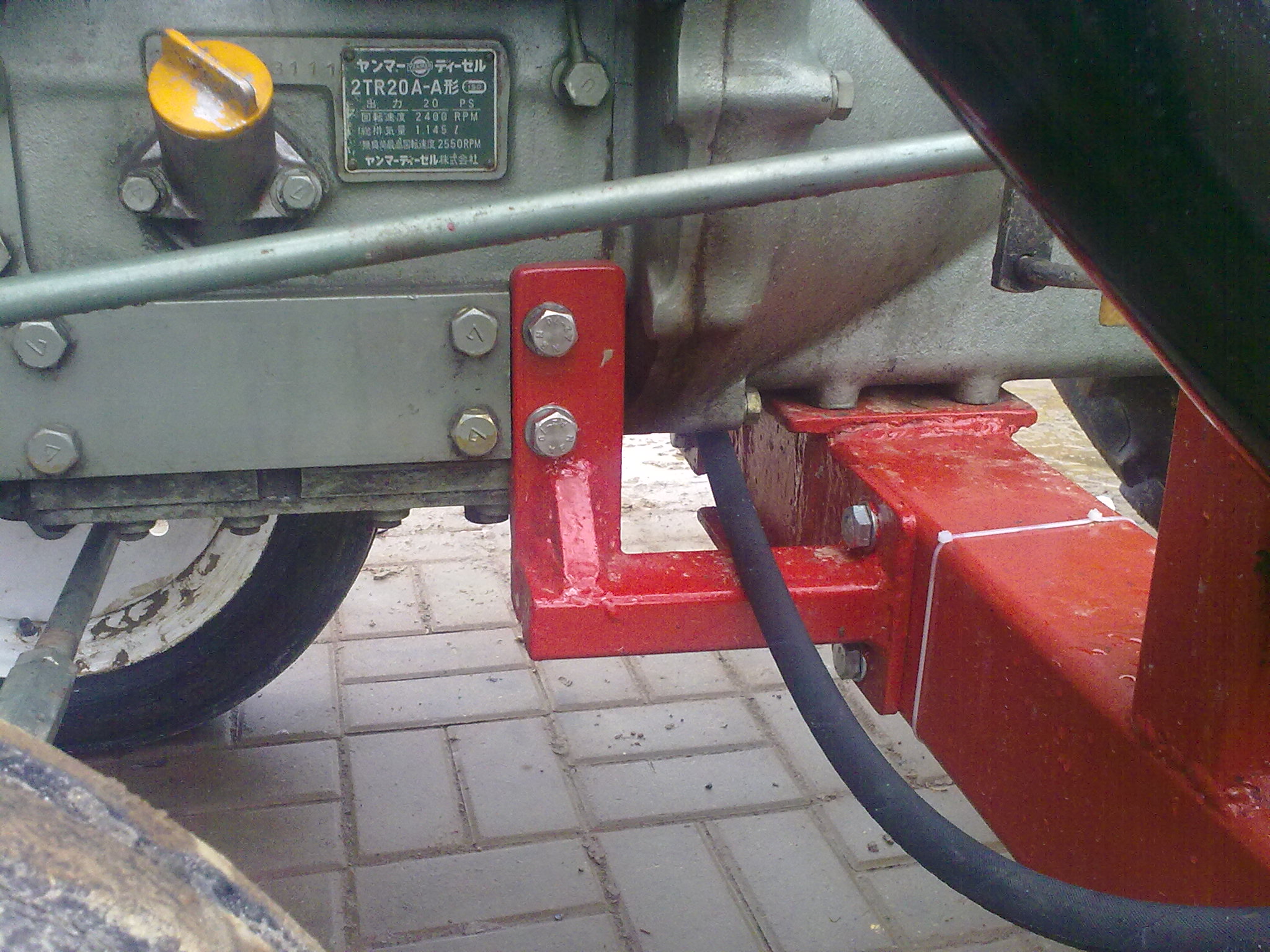

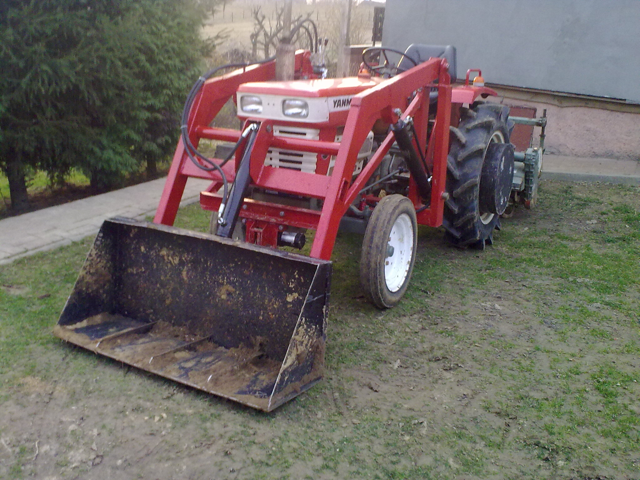

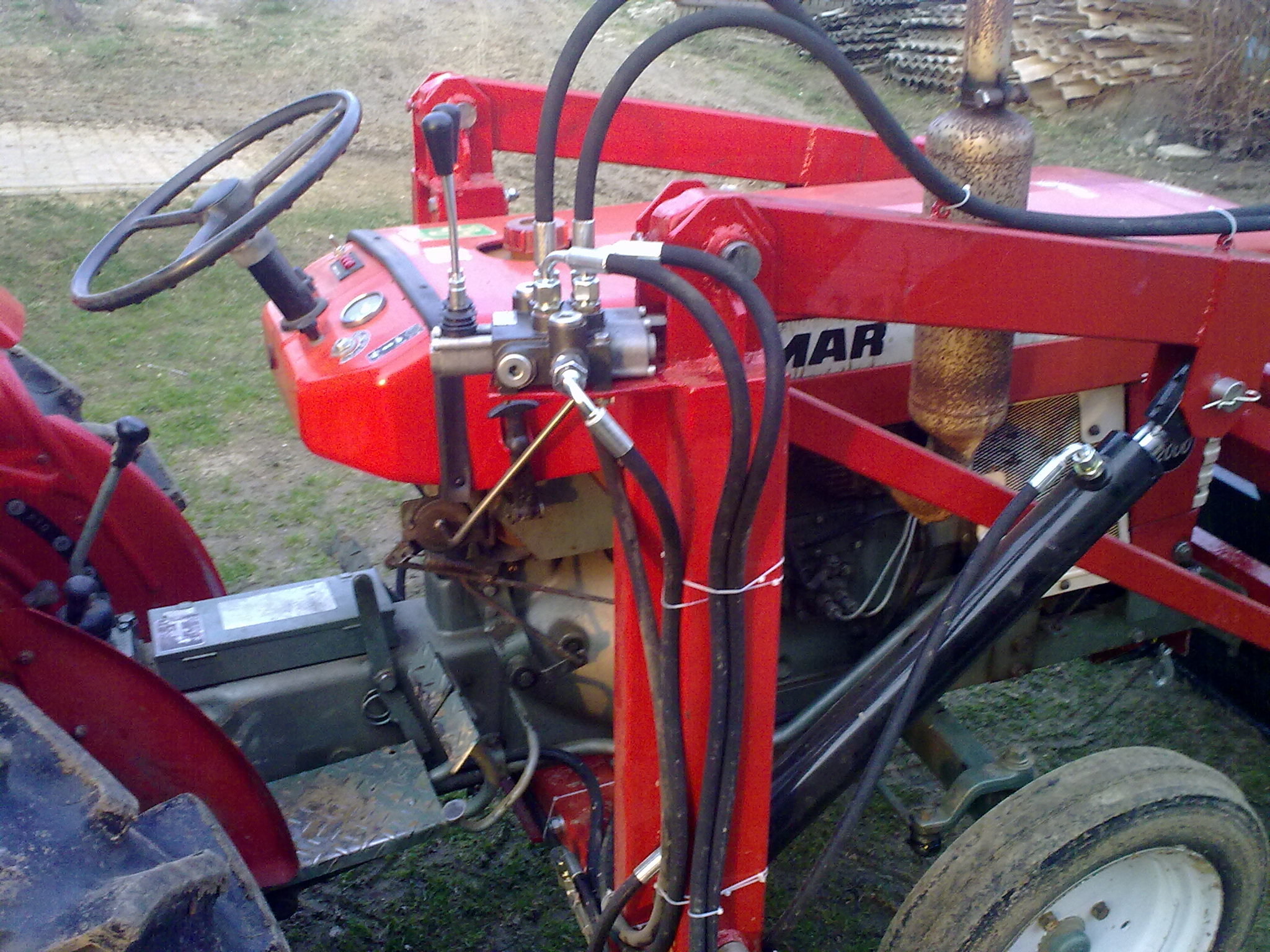

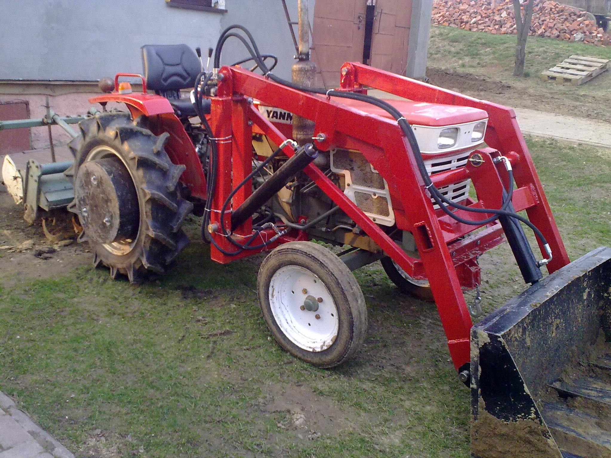

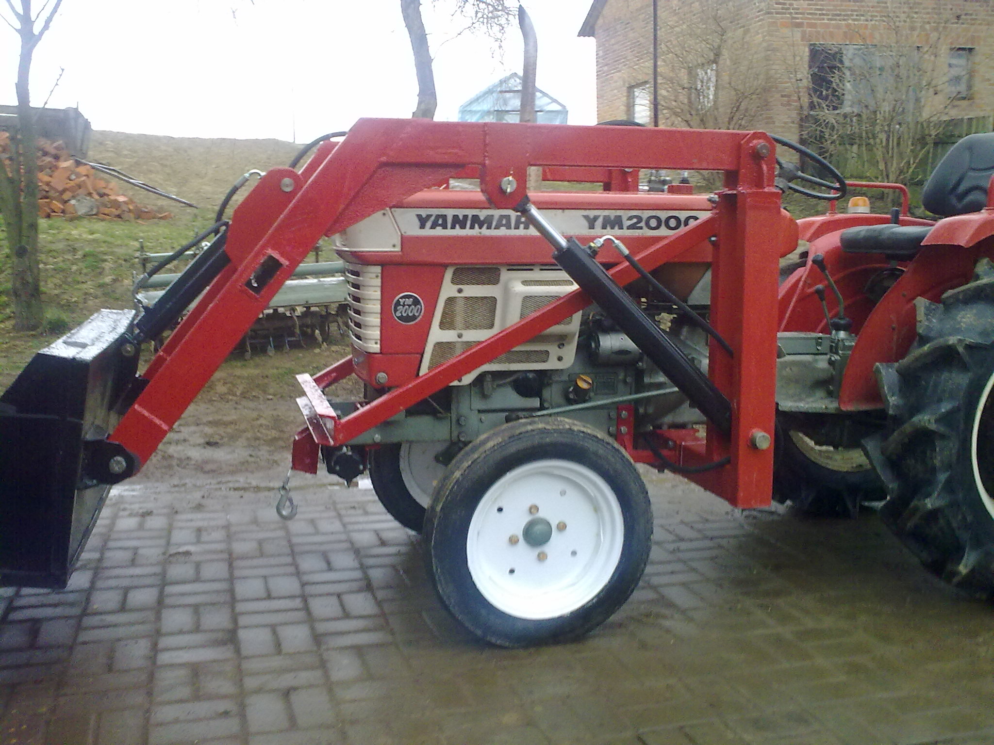

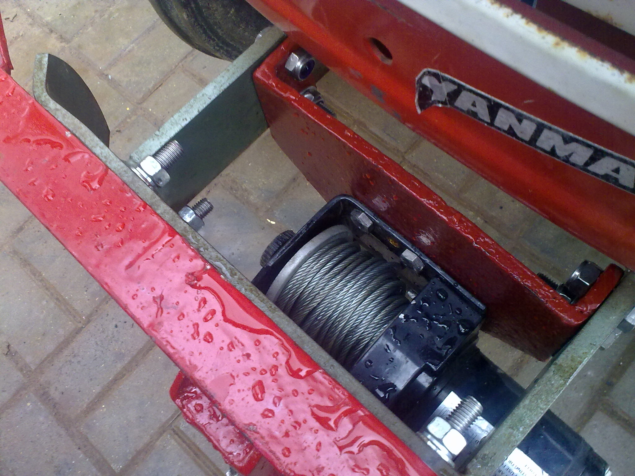

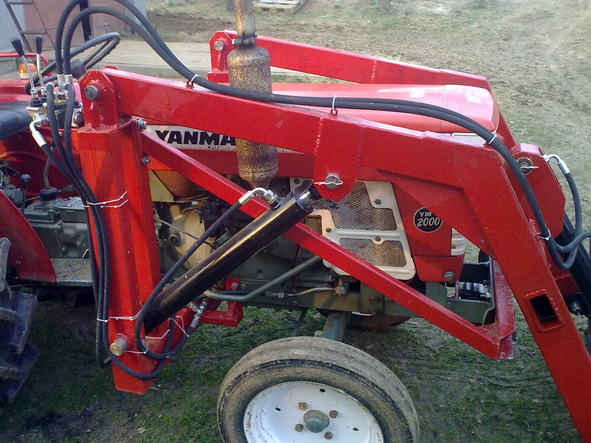

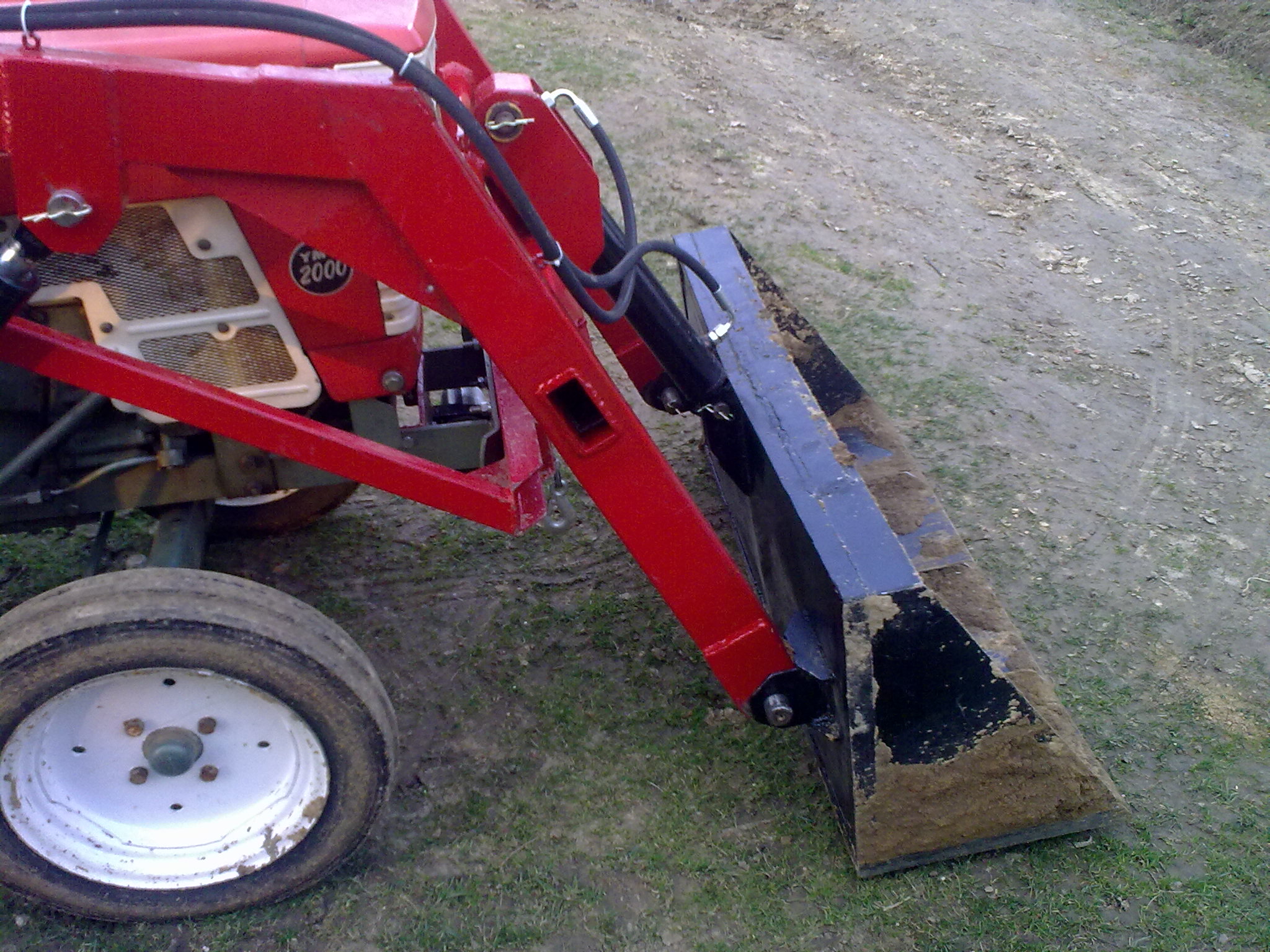

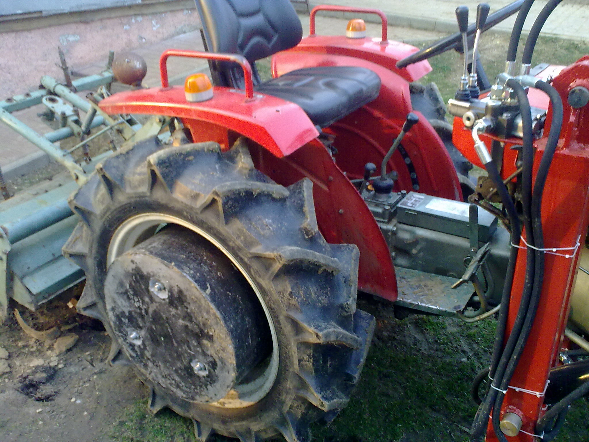

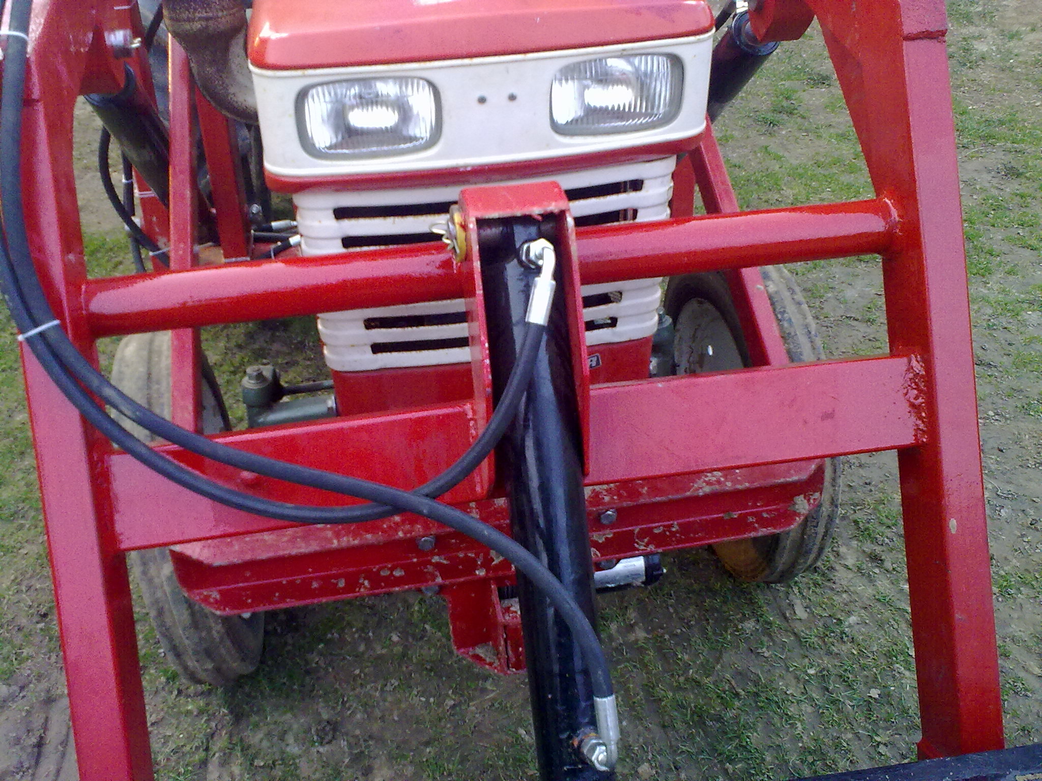

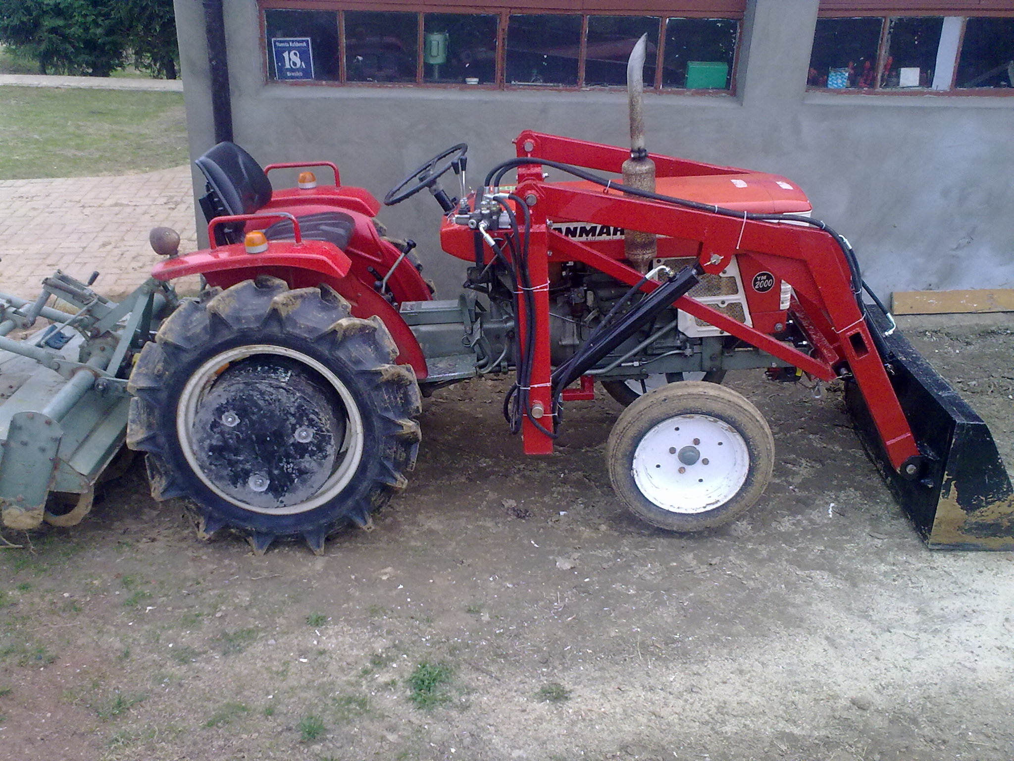

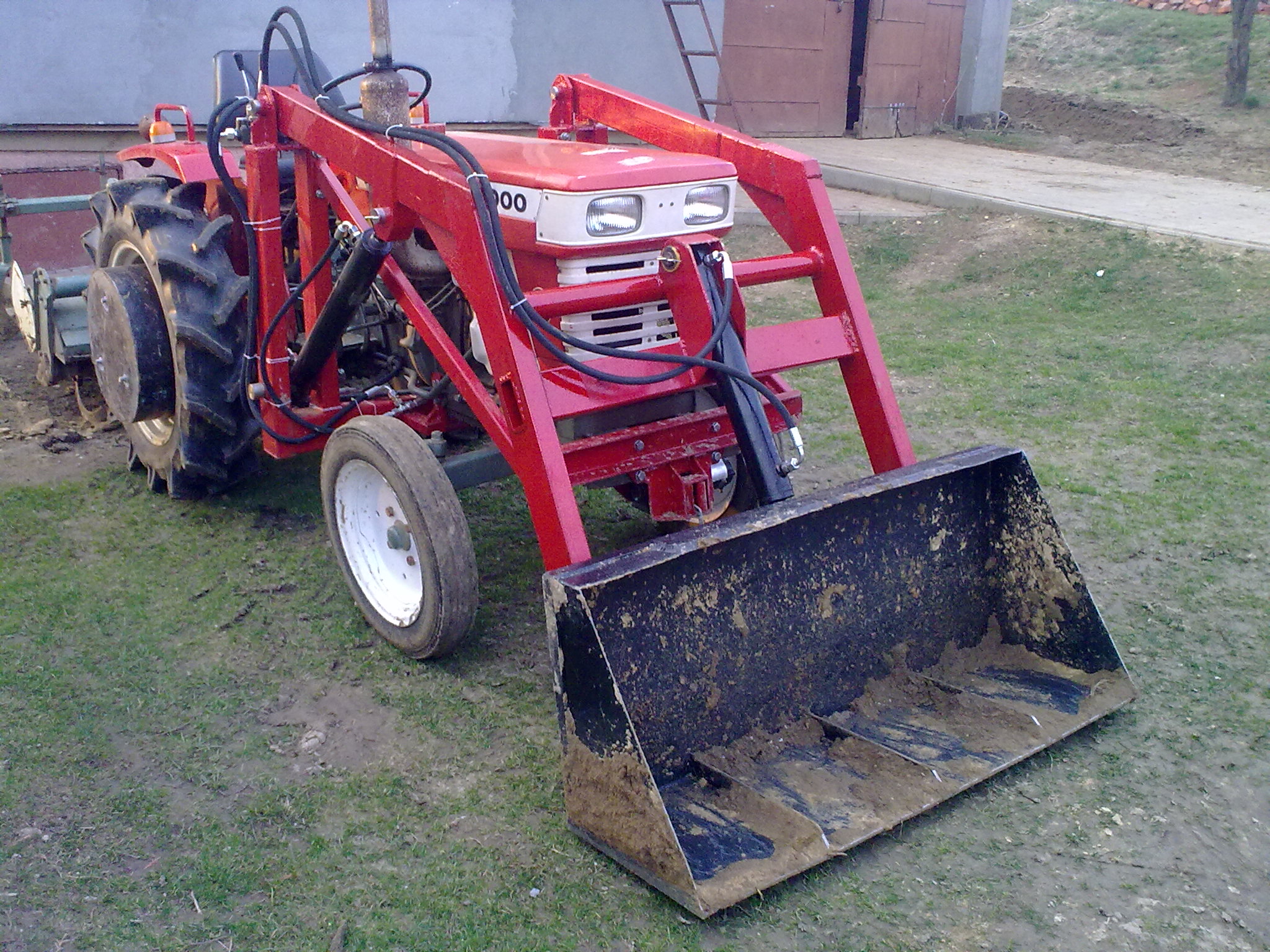

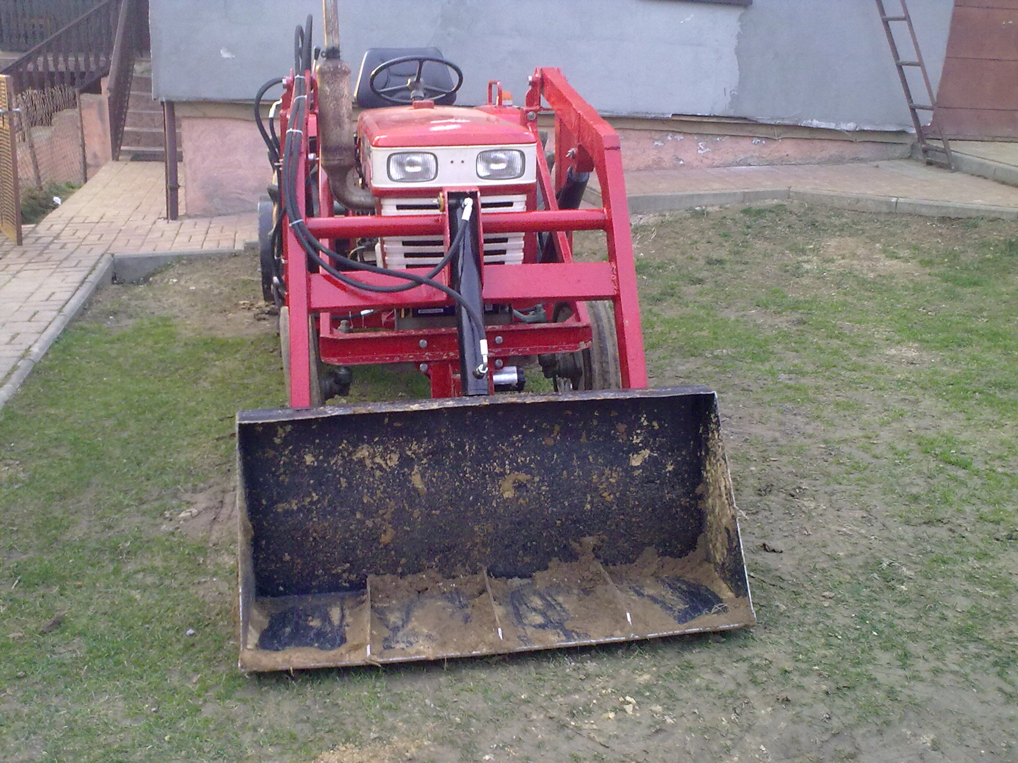

Hi, I present my loader to Yanmar YM2000
This is my first front loader so please bear with us
Drew a little too big motors, for a lengthened time head sadly.
I used a cylinder to the bucket, but unfortunately the frame cross bar connecting the two branches began to bend, then wspawałem additional pipe and was about
I was very pleased with him, I think I made it more robustly than sold to us in Poland Allegro.pl - aukcje internetowe, bezpieczne zakupy for this type of tractor

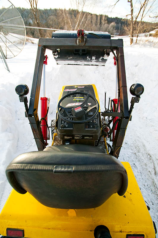

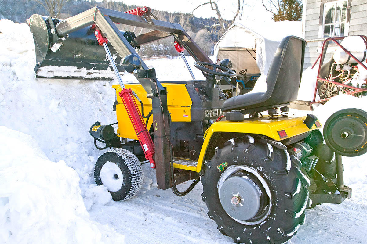

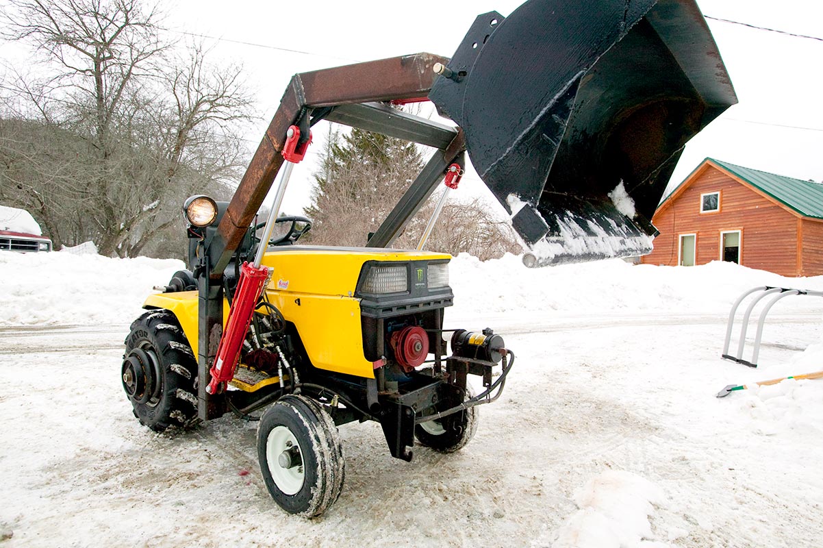

Thought I'd add mine to the mix. Built it in the fall and will be removing, grinding and painting in the spring. Most important part of a GT loader is the subframe. Spread the stress out over the tractor and provide a good connection to the driving axle.
I've been moving mountains of snow and ice all winter and watching for issues with the tractor frame. All seems well with the exception of a few minor fluid leaks which will be addressed on the finishing.
