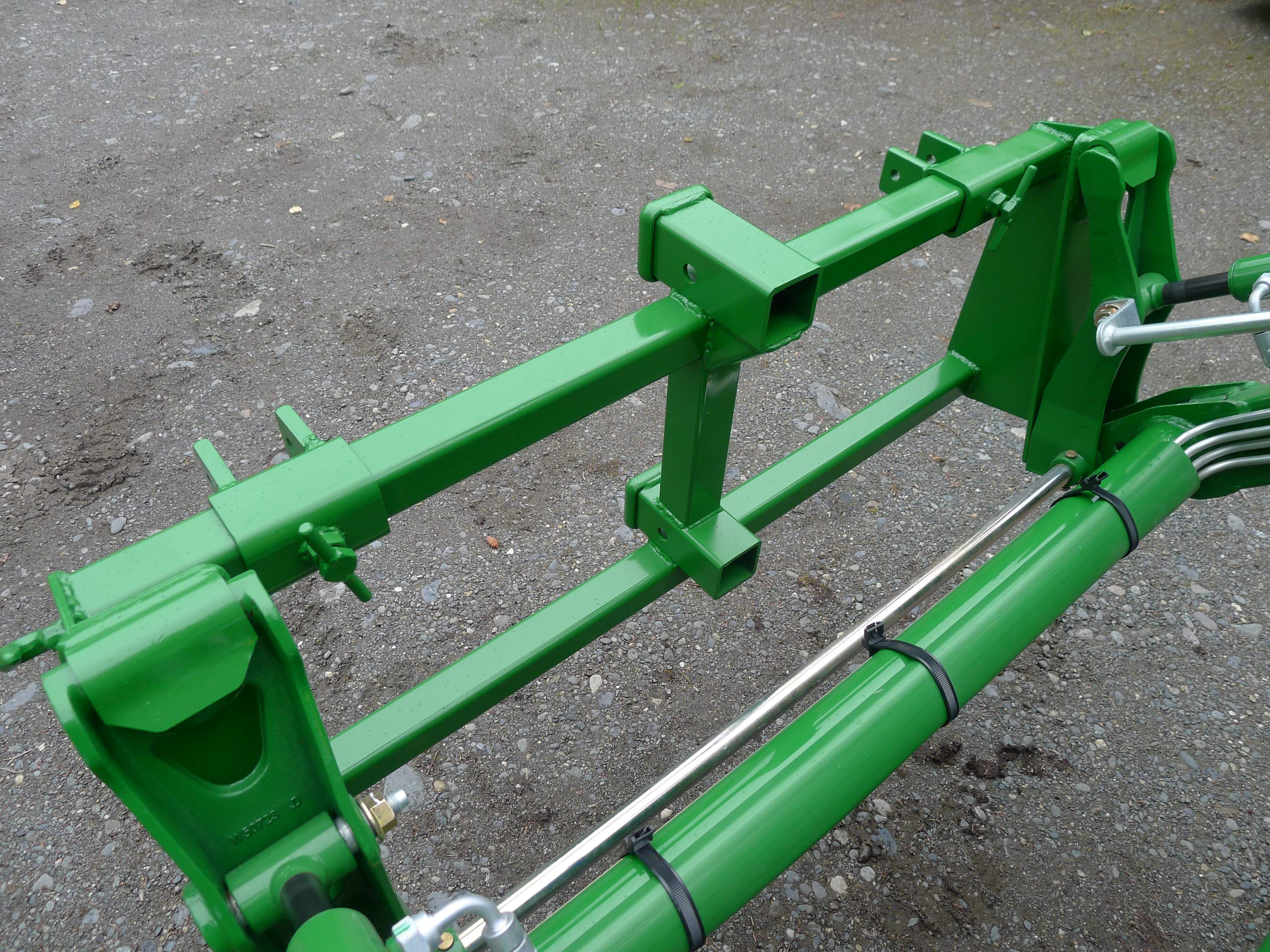

I'm building my FEL mount to mimick JD's quick attach system so I can utilize JD implements. Is there any way you could measure a few things for me? width between the pins on the FEL, height from top of pin to bottom pin? pin diameter, etc. I would greatly appreciate it

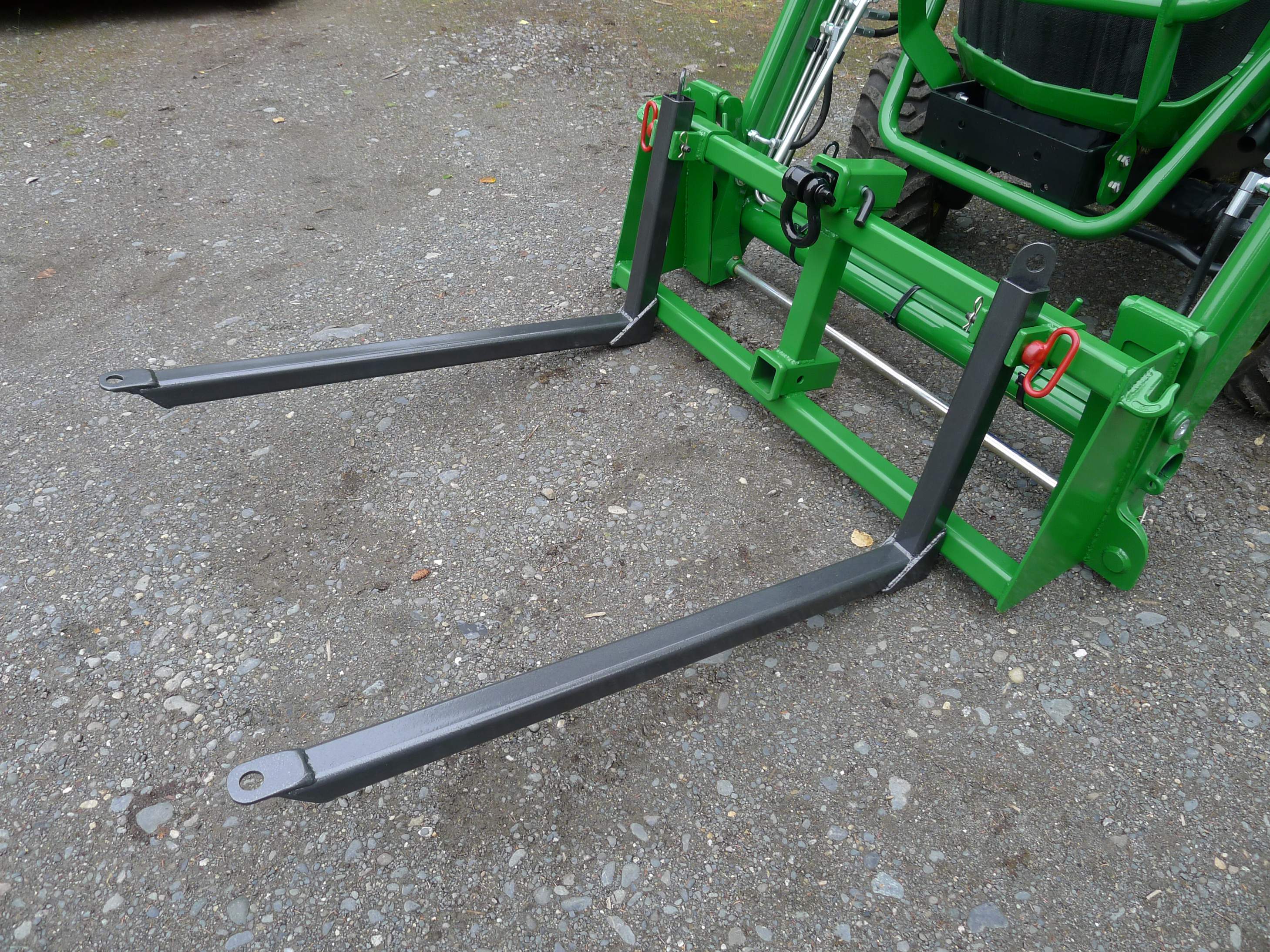

Rockshaft, I'll be interested to see how your fork design works. I take it that since it's hinged (at top??) then the bottom is floating. If so then I think you are on the right track with your logic. My forks are hooked at the top and pinned at the bottom so they won't float.

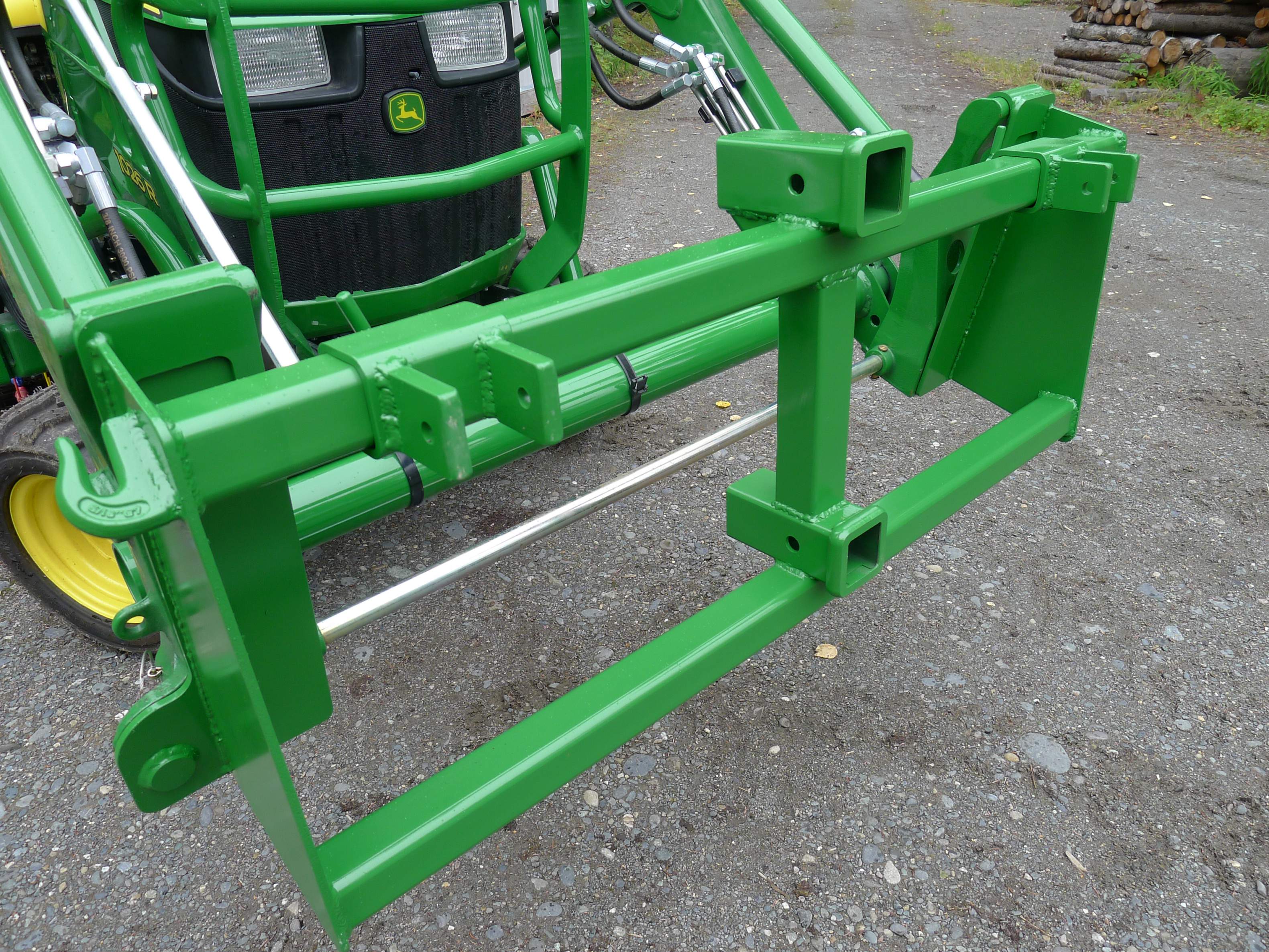

Finally got around to getting the forks project complete. Just thought I would post a couple photos... Let me know what you think Greg.

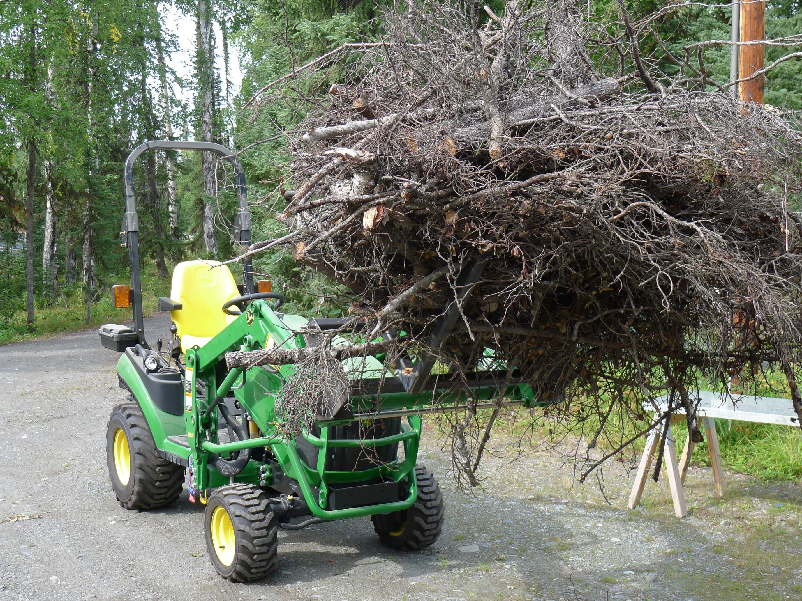

Rockshaft, Very nice fork system. You did a great job building it. I like the versatility of the design. You have given me a few ideas. Like you show in one of your pictures it works nice on brush. I've been using mine constantly. One thing I'm considering is installing a grapple arm to better "grab" brush and logs. Nice work.

Thanks.
I've got a grapple that is 90% finished that plugs into the top receiver- I'm sure a grapple will really help me clean up logs and such around the property.

Sounds like a good project. I'd be glad to provide information. I'm drawing up a cad drawing and will convert to pdf file and send to you. Just give me a few days.
