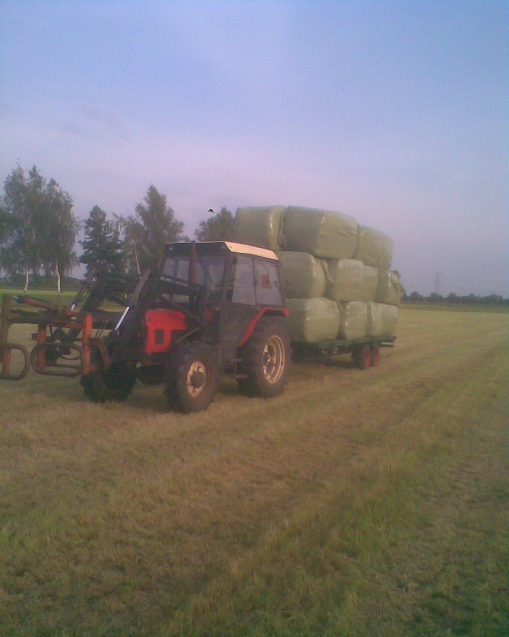

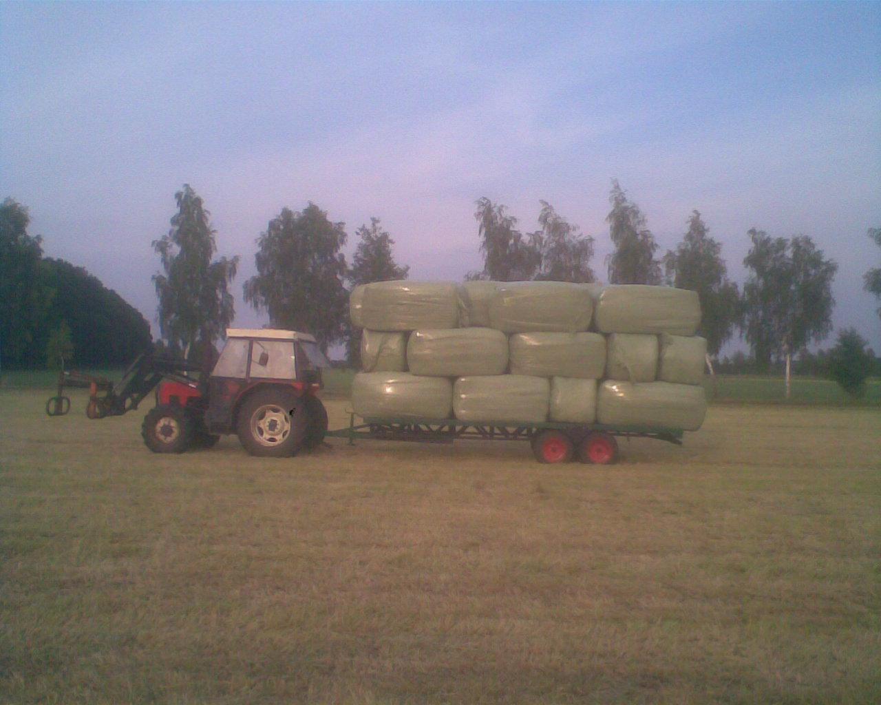

Look what i did yesterday: i put the trailer through the ultimate test :p
We had 23 square bales from 1.3 hectare, it was a quite heavy 2nd cut.
I could do 11 and 12 bales in 2 times, but i wanted to compare my theoretical calculations to everyday farm practice: I took all 20 bales i could load, and then returned for the remaining 3... not very logical, but the trailer held, thats all i wanted to know.
The tires would allmost crack, but the frame didnt budge :)
I guess this is 300 to 350 kg per bale, so 6 or 7 ton load.
Because of the short wheelbase and high CoG, the trailer was very wavy on the road: Lateral movement was non-existent, just as i expected, and the reason why i wanted to go tandem instead of turntable steered. The heavy tongue load makes it track very well. It was just the wavy bounce of the tractors rear axle that was unexpected: But if i stick to loading 2 layers of bales on this trailer, instead of 3, the CoG will be 2 feet lower and the ride much better.

Very nice job :D
The tires look like they are about to split in that last photos with all those bales lol.
How did you place those bales that are going across the bed instead of longways? Like the one second from back on the bottom layer? Can the loader reach in that far or do you have to slide it along with another bale? Or do you just slide it around with the loader?

Hi Jake,
Funny, perhaps i should shout a little louder, when the words have to go to an american webserver and then come back over the ocean to be read in Devon, England... ;)
I can just put the bale there from behind. the rearmost 2 bales are hanging over the rear of the trailer about 30 cm ( a foot) which means that the reach of the loader to place that bale, isnt as big as it seems.

Hi Renze,
I just finished reading your home made bail trailer build. I must say it came out super heavy duty. The welds are professional grade, of course I suppose I should expect nothing less than that from you anyway. And the paint job came out looking just as nice. I see you really put that thing to the test loading it up three layers high like that. I thought the wheels were going to blow. Did your tractor get light in the front end with all that weight? as in did you notice any difference in steering?

Larry,
With tractor/loader weighing in over 4 ton, it doesnt really notice anything on its front axle... All i notice is that the rear wheels belly out during the ride, causing a wave, because of the high center of gravity of this load.
IT is quite a difference compared to old turntable steered trailers: When pulling these, the play between tow eye and pin, plus the general construction play, will make it swerve from left to right, it turns to the right until the mechanical play doesnt give, then the turntable is steered a bit, untill it runs out of play to the left. Because it has a heavy loader on it, and i dont use rear ballast, this towbar play is a plain b*tch because it ticks the rear end aside everytime, so you keep steering.
With the tandem, no such thing. And when i brake, the trailer keeps inline with the tractor, and the tractor can stop the unbraked trailer much safer because of more braking grip.
I'm running on 10-15 tires, all 6 ply. The walking tandem originates from a 3 ton manure spreader, but it has some over capacity: The wheel hubs are rated for 2 ton per axle, though i cannot find a rating for tandem use for this particular axle. Knowing 4 ton on axles and 1 ton tongue, makes it a GVW of 5 ton. I loaded 6, so that made it 7 ton GVW test weight...
I would like a wider, 2.55 meter wide wagon, so i can stack 3 bales next to each other instead of 2 (current trailer is 2 meter wide, bales are 80cm wide) With the same length of 6 meter, i would require 150% of load capacity when it can accomodate 3 instead of 2 next to each other... Then loading 3 high would give 9 ton load, and 11 or 12 ton GVW.
