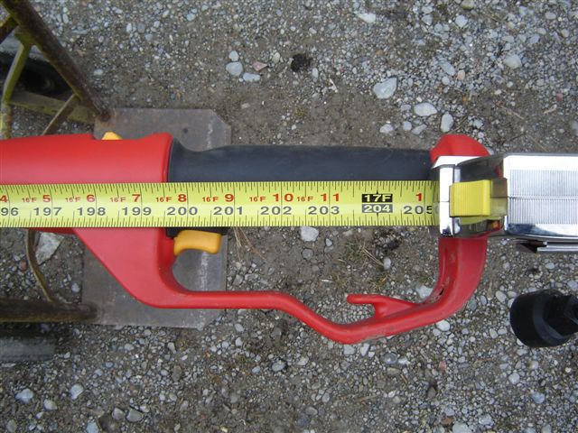

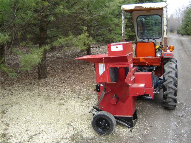

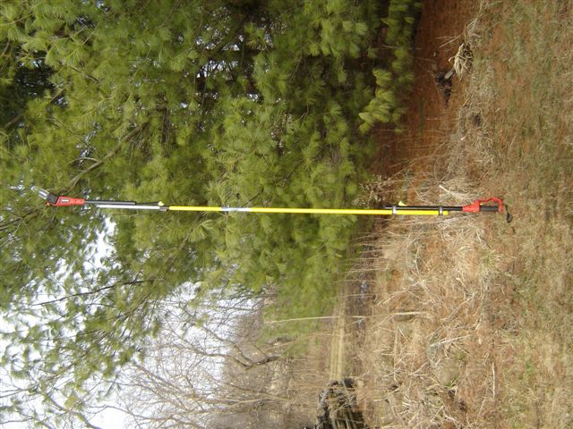

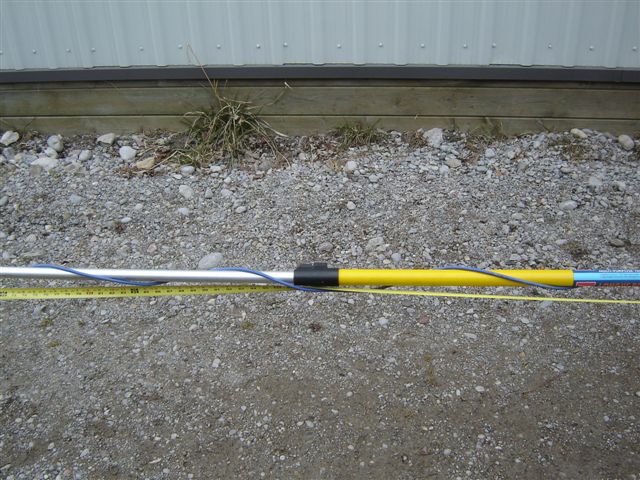

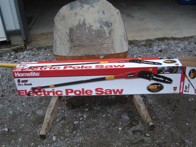

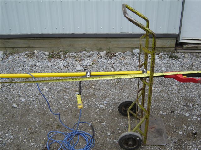

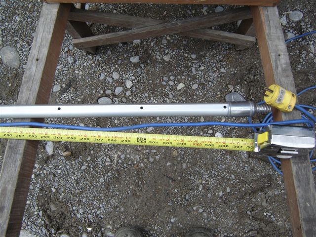

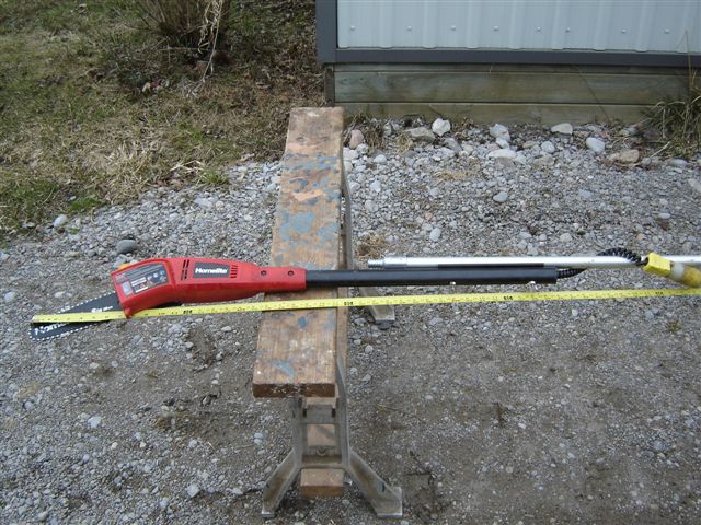

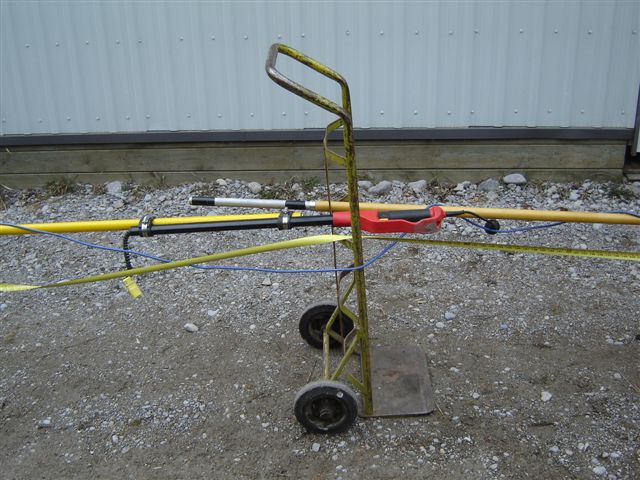

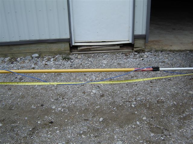

The following are pictures of a electric pole saw that has cut branches at the 24' level. If you are wondering why I have this in a tractor site it is because we all have long drives. This is prototype #3, #1 used the extension pole with a recipating saw but it was too slow. #2 was a 12" electric chain saw on a wooden pole too heavy, and way too much power.
I purchased the Remington pole saw and took it apart to make the single pole trimmer. It works well and the largest limb I have cut was 7" at 17' in the air will standing on the ground. Going to the second pole will let me get to max 26' and that is the limit.I have the post of (5" chipper shredder on garden tractor power) , and now have the chipper back together. I power the pole saw from my portable generator. The prepartation to cut is slow as I need some ground crew. The actual cut is 15 seconds for a 2" limb and the electric saw is very nice for that. The 7" limb I only cut 3/4 the way through as I need to get back and break the limb by grap or rope.
In this way I can keep the drive trimmed back, which helps in the winter with the heavy snow. If there are any questions I will answer.

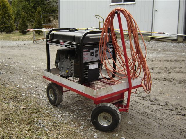

I forgot the saw head picture. The setup to cut is slow but alot of wood comes down. The pictures of the chippings were just the 2" and less junk of one 4" limb and one 7" limb. The generator I ground with the metal rod.

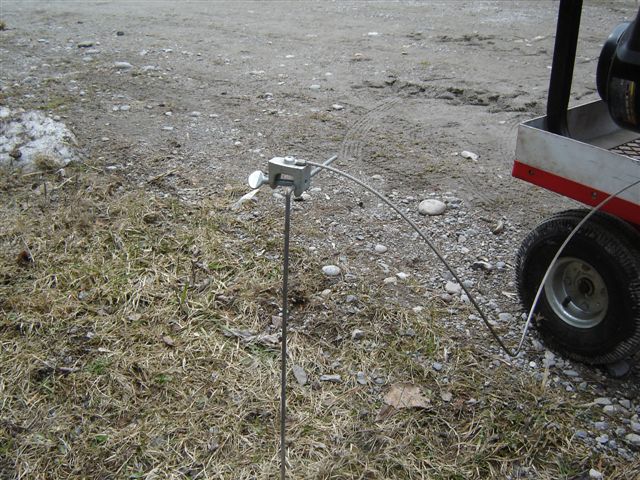

Pretty neat idea!:thumbsup: That must be quite the handful at the full length in a wind! :D Just be careful of any and all overhead lines, some bite back! :laughing:
Why do you ground the generator, btw?
/ Home Designed 12'- 24' POLE SAW
Dear Mace Canute
I am a electrician and some bite big. As the generator is sitting on rubber tires the frame is not referenced to ground. I use a stainlees steel bonding cable on a 3/16" rod as a quick ground. The generator I put about 75' away just so that I can hear the electric saw cutting through the branch. When you are cutting like this I do not even have the ear muffs on my mesh face shield down. There is the chance that the saw may get caught or smashed but it is better it than me. I have the material at home to build a 40' boom lift, now that is going to be fun.

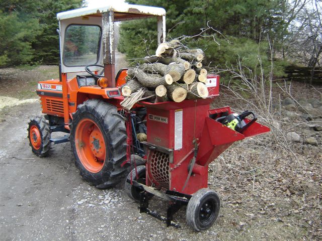

Never thought of the ground for the generator before. I was planning on suspending mine below the bucket on the tractor leaving the bucket available for large limbs (firewood) and using the 3PH for the blue version of your chipper (Goosen). If I add a ground rod to my generator while its attached to the tractor would you envision any adverse affects to the electrical system of the tractor?
BTW my chipper is mounted to a pallet which makes it easy to move around with the FEL when not attached to the tractor and a good place to carry the larger gas saw when it is.

Electric power has effects when you are on wet ground. Your 12 volt tractor system does not have a high enough voltage to hurt people. A generator if it is leaking to ground and sitting on a steel framed tractor and tractors have rubber wheels could have a large enough potential to knock you out. I watched a safety video of a boom truck get into 30,000 volts and the tires were on fire and the landing legs were sparking. The trainer explained in electrical terms why it was possible , and the main power stayed on.
I would think a generator ( 120/240 ) on a tractor needs a safety ground of the tractor. In that way any leakage would prefere to go to ground and not you, as you mount the tractor. In safety training they say if you are in a crane and you touch high volage you jump off a truck and keep your feet together and bunny hop to safety.

The neutral and the ground are bonded together on portable generators. They HAVE to be...if they weren't, there is no way the breaker or fuse would open the circuit if a short from hotleg to case happened in a tool.
Portable generators have no need of a reference to ground to work, they are completely self contained. In the unlikely event that a short between the case of the generator and a hotleg develops, there is no potential to earth...it is all contained within the generator's frame. A ground rod is useless.
If you do have a short in a tool and the case becomes energized, having a higher resistance between you and the case of the generator is better than having a ground driven into earth to lower the resistance. Electricity follows all paths to complete the circuit, with more amps flowing in the paths of least resistance. Parallel circuits, eh?

The neutral on my portable generator is floating. This is stated on the front name plate of the machine. The neutral can be also bonded to the ground on other machines but that should be stated on the front name plate.
I hope I did not imply that a floating neutral generator needs to be grounded to work, because they do not.
When you use a GFI recetpacle from a house based power supply it measures the current leaving hot wire through the power tool and returning on the neutral. If the inbalance exceeds a set valve it trips.
When you use a portable generator with a floating neutral nothing should go wrong, except unless it has leakage. If the generator is sitting on rubber tires it is insulated from ground. If a winding is poor there could be a inbalance and stray voltage generated. If the frame is refereced to ground and you are also standing in wet soil the inbalance should leak off to ground and not be a source of potential to you.

Honda portable generators have a system ground that connects
generator frame components to the ground terminals in the AC output
receptacles. The system ground is not connected to the AC neutral
wire. If the generator is tested by a receptacle tester, it will not show
the same ground circuit condition as for a home receptacle.
Also, on page 14, there is a ground terminal provided on the generator.

I believe we are talking the same language. I read the Honda page 17 and that tells me the neutral is floating,because it is not connected to system ground. On page 14 there is a frame ground. This is what I brought to light in my first post. The ground rod was a frame ground. Because I am pulling the generator around on rubber tires I provided a path to ground if there was any leakage current instead of posssibily through me.
I am a licenced electrician and (no )we do not like shocks.
The hydro supply authority are getting very touchy about back feeds from home generators. They pulled my primary fuse to work on the pole and clamped a ground jumper on. So if I had a home generator wired wrong and it tried to back feed to the grid it would short out. They do not like shocks, and they get very upset when they find generators plugged in backwards.
