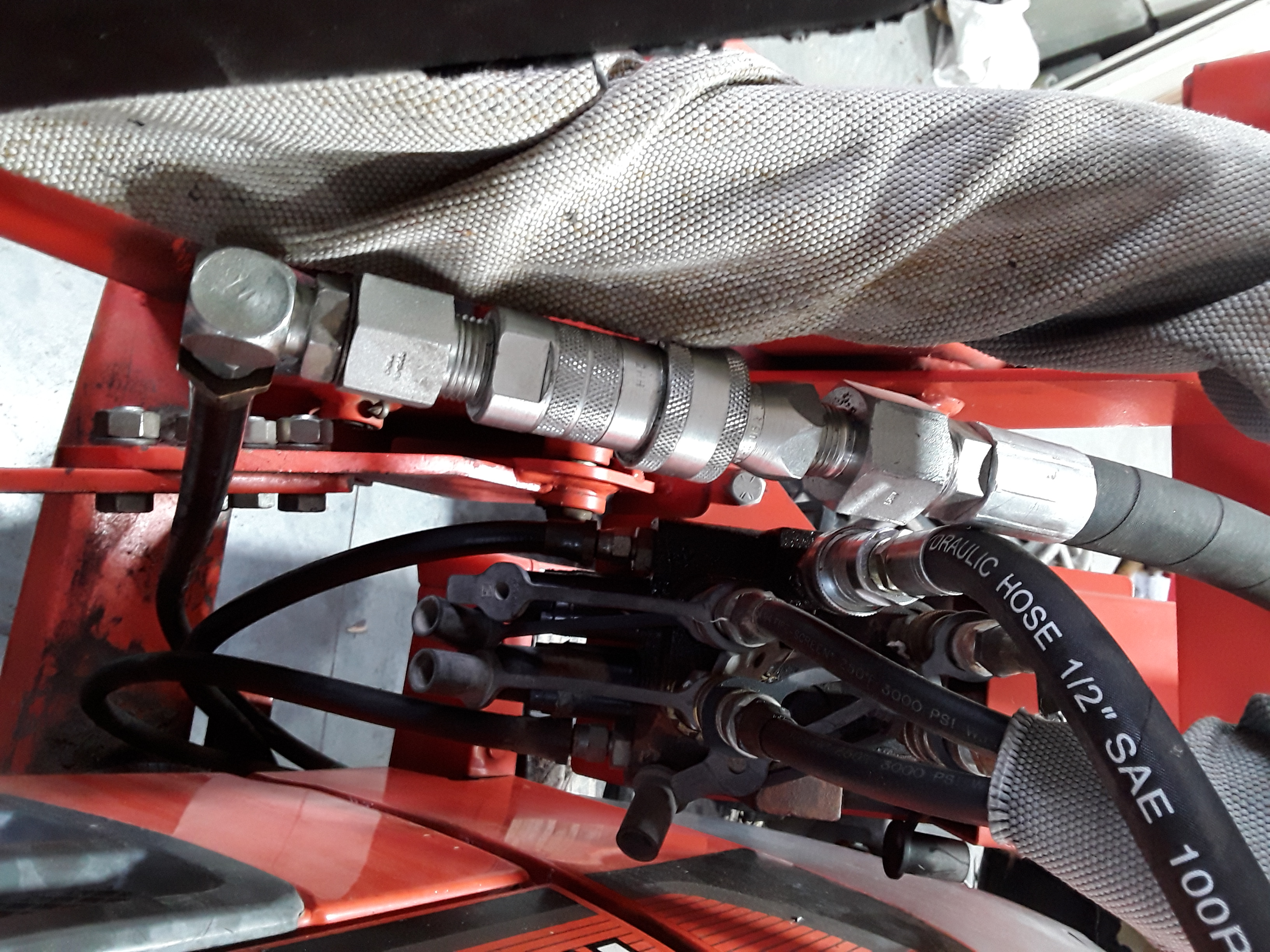

that I have rear remote "hydraulic-enabled" by tapping into the PowerBeyond port on the FrontEndLoader spool valve:

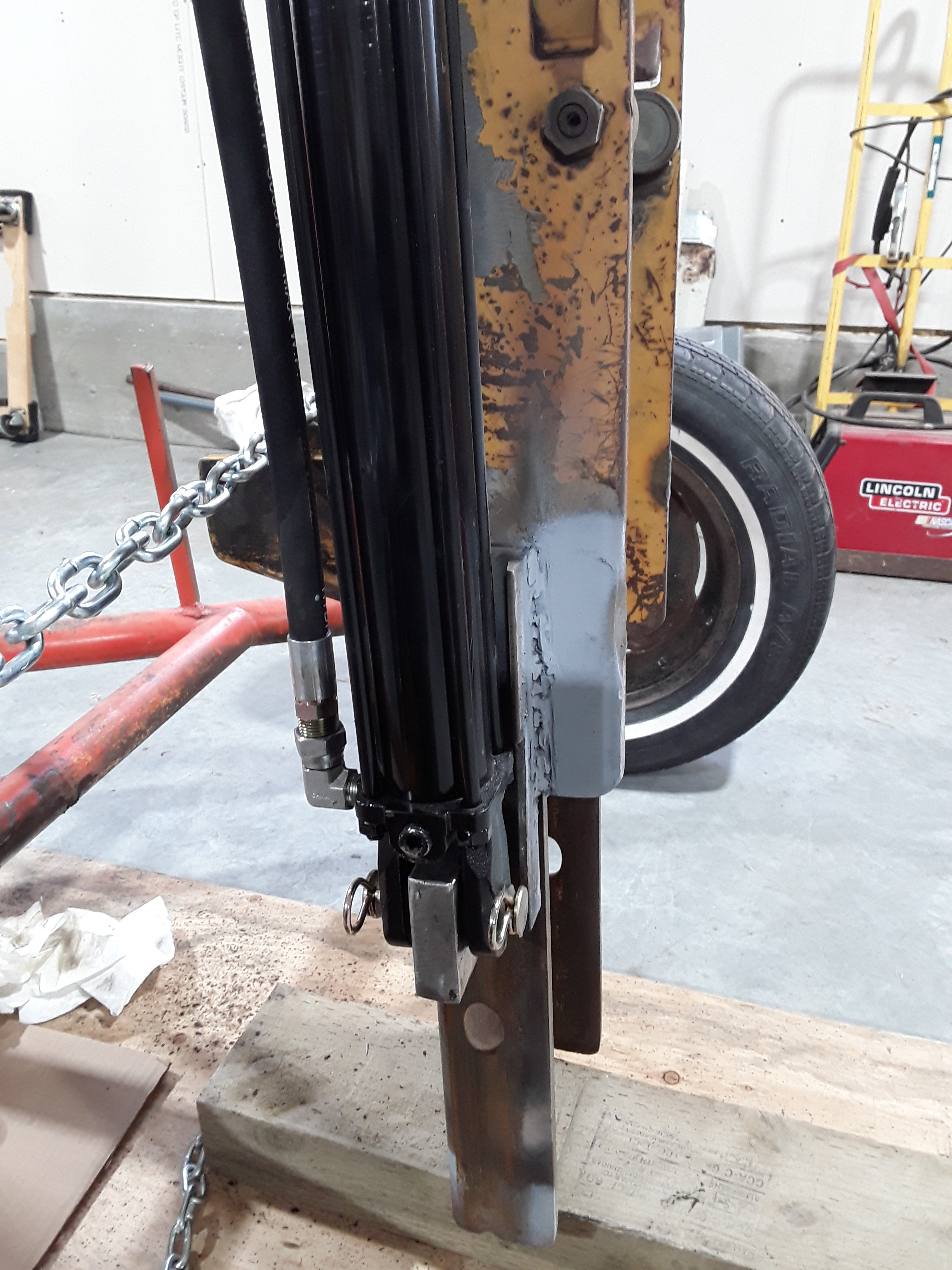

Anyway, I picked up a gem. It was probably in a previous life a 3pt-mounted, PTO-driven DanUser post pounder now mounted on a trailer. It was powered by a small gas engine that thru a rube goldsberg (sp?) set of chains and sprockets drove the DanUser friction wheel. The engine was shot. Instead of fixing the engine I removed it and all the friction-wheel/brake stuff. I installed a hydraulic cylinder, spool valve and hoses.
Here's the whole rig:
Shots of the fabricated hydraulic post pounder. Hey! Don't make fun of my welds. I did it with my eyes closed, well kind of, I have cataracts really bad.
D1HydraulicPostPounderFrontView.jpg E1HydraulicPostPounderRearView.jpg F1HydraulicCylinderTopView.jpg G1HydraulicCylinderBaseView.jpg
The setup of the hydraulic spool valve:
o Port bottom left: From pump (actually the PowerBeyond port on the FEL spool valve)
o Port top right: Return to tank. (actually the one gallon jug for now)
o Port bottom right: Return to tractor. (The other end of the PowerBeyond from the FEL spool valve that goes on to power the 3pt)
o Port top center: B port that goes to the base of the hydraulic cylinder.
o Port bottom center: A port capped. This would ordinarily go to the rod end of the hydraulic cylinder.
So what I've done here is taken a 4-way single bank spool valve and double-action hydraulic cylinder and converted to a 3-way single bank spool valve and single-action hydraulic cylinder. I have a hydraulic line only to the base of the cylinder and nothing but an air vent in the top port of the cylinder. ie I'm depending on the weight of the ram to retract (drop).

Well mostly. The cylinder extends fully. It's not really fast but it is acceptable.
The problem comes in when I retract the cylinder. The cylinder comes down at the same rate that it goes up. It comes down leaving a love-tap ... of course unacceptable for a post pounder.
I'm reaching out to the hydraulics brain trust here. Any suggestions on how to make this freefall?

A friend stopped by today and suggested flipping the cylinder over and try powering the cylinder from the rod-end; the rationale being that since the rod-end of the cylinder holds a smaller amount of fluid, maybe it would purge faster.
The hoses are long enough so I tried it. It didn't work in that it wouldn't lift the weight. Powering the cylinder from the rod-end won't lift the weight.
With the cylinder still inverted, I moved the hydraulic line to the non-rod end of the cylinder, so in effect it would be pushing the whole cylinder assembly and weight up.
I tried that. It worked going up and noticeably faster down. But still not fast enough. An advantage to this setup is that the cylinder port is now physically higher than the spool valve so that should give a slight advantage in draining.
The bottleneck still seems to be the rate that the fluid purges the cylinder -- it's being restricted.
Question to hydraulics pros, can these cylinder ports be safely enlarged? The cylinder port is 3/8", the hose is 1/2" and the spool valve port is 3/4". So technically I could go up to 3/4" on the cylinder port and hose before encountering another bottleneck.
