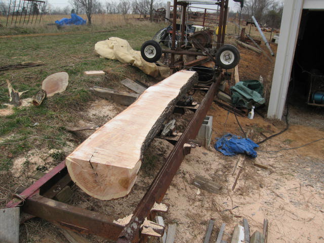

Yep- I know about stressing the blade from poor guide alignment. I broke a blade last year while cutting the third log /forums/images/graemlins/blush.gif
A close inspection showed many cracks. I have since aligned the guides much better to reduce the stress on the blade, but I'm sure better, movable guides would help. I do use a lube after every cut- I have a spray bottle of half kerosene/half chainsaw bar oil. A dribbling system as you suggested would probably be better.

Erik - There are many factors that come into play with a bandsaw versus a circular saw. Adjustable blade guides are essential for keeping the blade supported somewhat to try in avoiding the "wave". A water injector or lubricator system is nothing more than a reservoir, controlled by a valve, above the blade guide and the basic gravity system. This is an important part of the bandsaw in that it not only keeps the blade lubricated and cleaner, but it also serves to cool the blade in a wide cant. Some experts claim that they use kerosene, some use light oil as it reduces friction of the saw blade as it saws. They claim they can reduce blade tension by 1/2, get the same professional results, and no carryover staining or odor in the lumber. Also reduced tension results in longer blade life. I use water, a squirt of Jet Dry, and Ivory dishwashing soap. My own inexpensive creation and I'm very happy with the results. Water injection not only lubricates the blade, but keeps the blade clean, and reduces heat. Keeping a constant tension on the blade is diffiicult due to sawing friction and ambient outside air temps. Normally, the manufactured mills run a hydraulic tensioner and as the sun hits the machine, the fluid expands and increases the tension. For this, you have to adjust and readjust during the day. If the tension increases as you are sawing a board, a little more flow of water brings it back within limits readily. Erik, you mentioned seeing cracks and fractures in your blades after awhile. Too much blade tension and probably the most important is proper sharpening. Woodmizer has an excellent Resharp program or as an alternative - an excellent sharpener and set adjuster. In either sharpening, the grinder follows every profile of the blade and grinds metal away and hopefully the fractures and stress cracks. Thier sharpener for the person who wants to do his own blades is not cheap and it will take a lot of blades to recoup the original purchase. I have a little over 9,000 hours on my mill, on the 3rd engine, and I think I have run across most of the problems one might see in sawing. Feed rate and blade tension are two of your biggest concerns. Naturally, machine setup and alignment are constant issues I address routinely. The deck on my machine is 3 1/2 foot wide and I allow no more than a deviance of .001" from left to right. I can't control cupping or warping once the customer stacks his wood but I do supply him with a 5 page pamphlet that I have paid copy right to the writer for as a guide. Erik, you will receive a lot of good advice in this forum from more knowledgeable people than myself. I will try to help you answer any questions that I think I can at least lead you in the right direction. Best of luck and you made a fine machine - Clyde

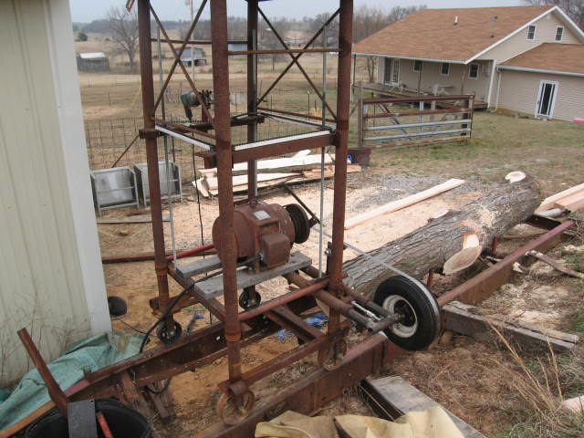

I used rubber tires/wheels because it was the cheapest option with durable tapered roller bearings and I have seen on the internet that others had done it as well. I believe that you will need a rubber strip covering the steel rims if you use them without tires- this strip will protect the edge of the blade from being dulled by riding on the steel rim. I wish that I would have gone with larger tires- they are 16 inches in total diameter (8 inch rims) and this is the minimum diameter- this puts extra strain on the blade as it must bend at a tighter angle.
I inflate the tires to about 40 psi. I honestly don't have a tension guage (I should make one), I just tighten it up until the band "feels" fairly tight.

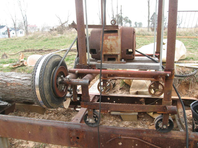

the 40 Psi inflate equals 2.75 bar exactly.. Normal car tires are matched perfectly for it. I could allways mount tires of commercial cars and trailers, which can be inflated to 5 bar (72.5 Psi)
calculating roughly, taken the saw band blade is 3 centimeter wide and the projected bearing surface (equals the wheel diameter) is 55 cm, and the pressure is 2.75 bar (2.75 kg per square centimeter) the max. strain that the tire could put on the saw blade would be 8318 kilogram... I assume /forums/images/graemlins/grin.gif that 8.3 metric tons will do the trick here...
If the saw band was 3 cm wide and 2 mm thick, it would have a surface of 60 mm2, by two is 120 mm2. 8318 kg divided by 120 mm2 is a steel pull strain of 700 N/mm2, which is absolute madness as only special construction steels have these yield strengths.
Anyways this is just a very rough calculation and the practise would turn out different i suppose...
anyways from this simple calculation i can conclude that an air inflated car tire will be more than sufficient to pre-stretch a band saw blade...

Here's the drive wheel. The edge of the pulley is welded to the edge of the steel rim (I was able to do the welding with the tire still on it)
I know I am a very sloppy stick welder- but I am still learning /forums/images/graemlins/smirk.gif

</font><font color="blue" class="small">( calculating roughly, taken the saw band blade is 3 centimeter wide and the projected bearing surface (equals the wheel diameter) is 55 cm, and the pressure is 2.75 bar (2.75 kg per square centimeter) the max. strain that the tire could put on the saw blade would be 8318 kilogram... I assume /forums/images/graemlins/grin.gif that 8.3 metric tons will do the trick here...)</font>
Renze,
I think a lot of that calculated force is soaked up in stretching the sidewalls of the tire and, therefore, never reaches the blade.
Probably, if you ran that same calculation on the total force in 4 car tires that support the weight of the car, the car's weight would be so small in comparison that there should be almost no tire deflection. Yet the tires do compress because most of that pneumatic force is stretching the sidewalls. (I think.)
