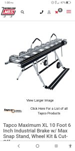

If you had a siding brake and some trim coil, build a Chase to hide it. I have done wonders with my siding brake.
Not sure what a siding brake is, but +1 on adding a chase.

A siding brake is the tool used to bend coil or flat stock trim to the profile needed to install on the house.
It would be a great idea to be able to use the same trim material as used on the house and then build in a way that it can be easily removed and reinstalled to replace the lineset in the future.
The lineset hide kits they sell for mini splits don't seem to match the color or profile of anything.
I have a 10' 6" long sheet metal break brake whatever. It's for bending aluminum trim coil for siding. You can bend metal building sheathing on it too, but that's the biggest task it will handle. It is light enough I can load alone. Have one for steel too, but it is way less portable.
