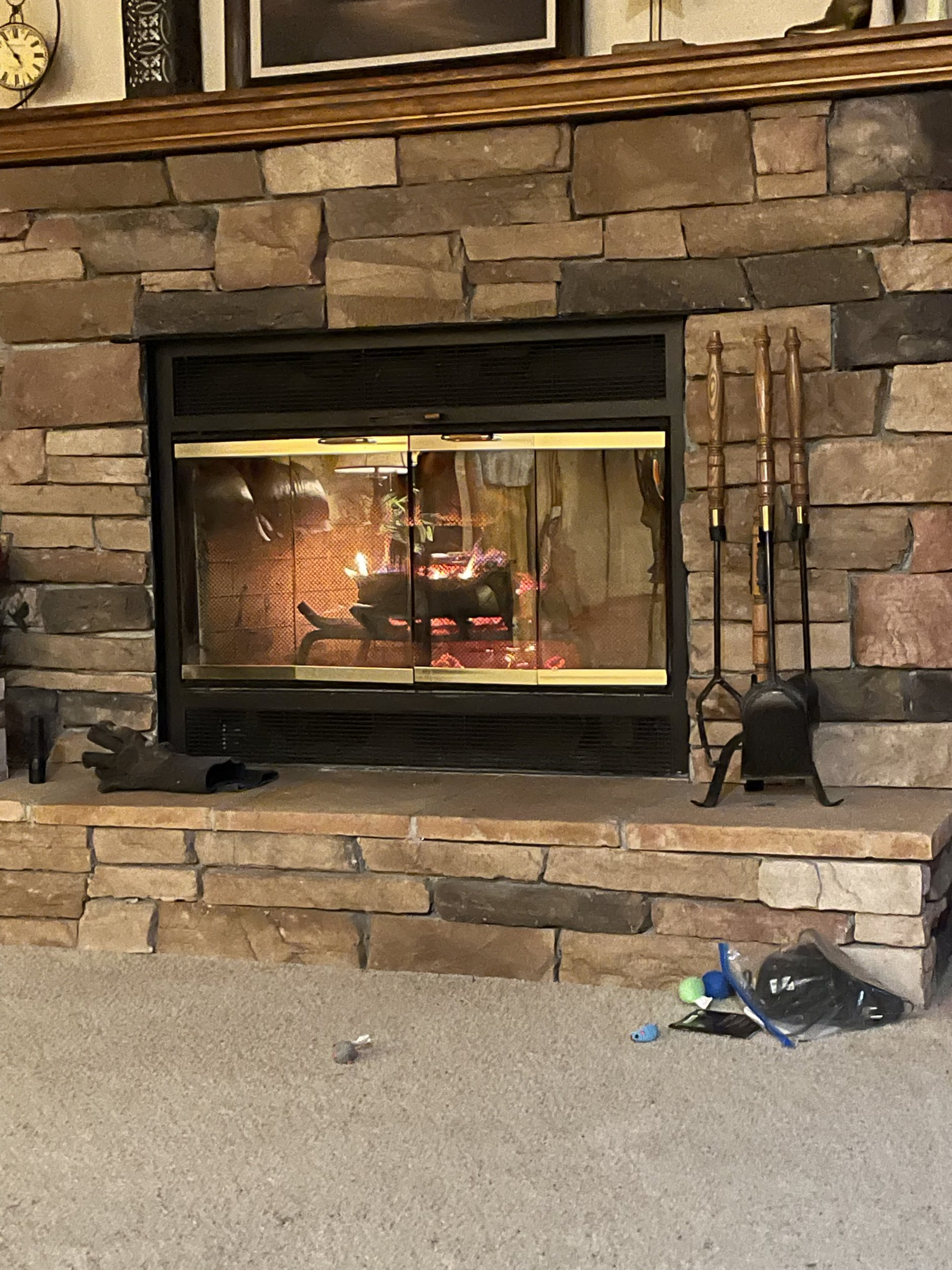

Over 40 years ago while building, we installed a steel fire box that was inside another steel box and used outside air. There are two blowers that direct air into the living room and two other rooms if needed. It is similar to the old "Heatilators". After 40+ years it is still providing much heat that is comfortable and nice to look at. The glass doors keep the inside air from going up the chimney. There may still be similar units available.

A modern fireplace with sealed doors and drawing in outside air is decent for efficiency. A stove is better. Fireplaces do look pretty. You could get a small propane tank for the fireplace too. I have a wood burner that gets used a lot more now that I retired.

I'm not a fan of open fireplaces. Most of the heat goes up the chimney and worse, it sucks a lot of air up the chimney which means that there's cold replacement air leaking in. The cheap prefab wood fireplace we had would make the house colder. Even with the glass doors closed it still drafted a lot of air. It didn't have outside air. Maybe new ones, or propane, suck less so to speak.

I've had all 3 types of units: grew up with propane, had nat gas, and had 100% elec. Since you can't get nat gas, I would suggest to go with a heat pump (high efficientcy, 17 seer or more) and a fireplace stove insert. I've never had a pellet stove, so I can't speak to that, but I have had a fireplace insert stove. Sealed unit, drawing outside air for combustion, thermostat controlled fan for the firebox to turn it off when the fire goes down, so it's not blowing cold air. We had one, and I could get the entire house up to 80° in under an hour after starting the fire. And it would burn all night, keeping us toasty.
We also plumbed the ash chute to the outside, so that the ashes fell to a chamber inside the bottom of the fireplace, with outside door access to easily clean out the ashes, and keep the house clean.
