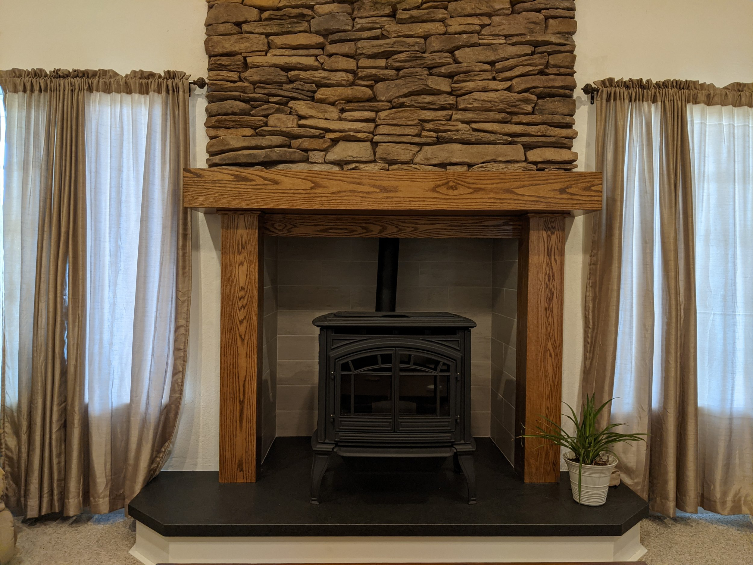

Couple of years ago we ripped out our wood burning fireplace insert and replaced it with a free standing cast iron pellet stove. No regrets. The open wood burning fireplace only seemed good at filling the house with smoke and not much heat. The pellet stove cranks out the heat with the push of a button.
