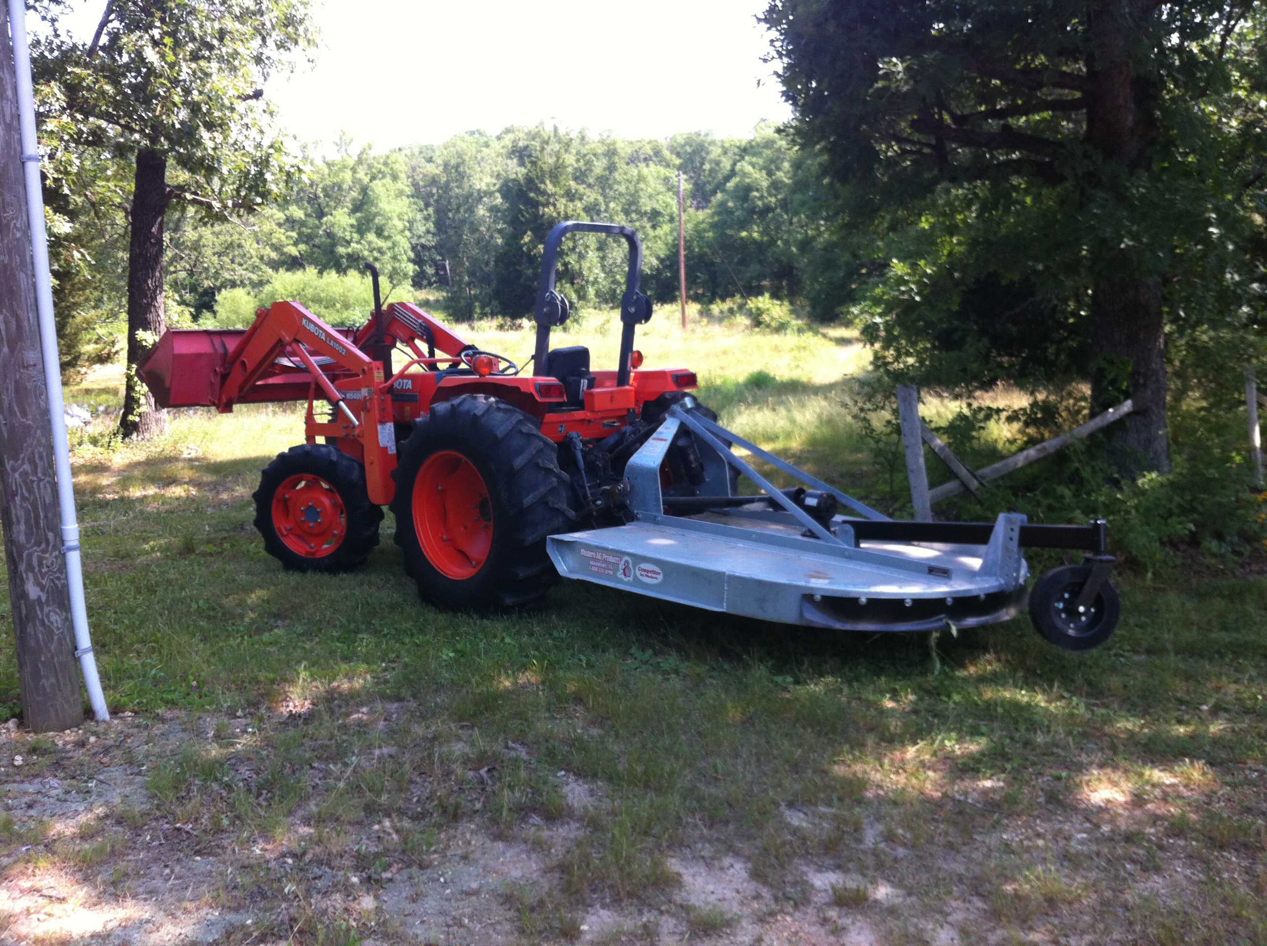

My first 'big' tractor is my 1999 Kubota M5400 4x4.
Most of the hours since I've had it have gone into mowing my rough fields with a 6' Modern Ag rotary cutter. I've learned lots of lessons already, including how to replace a ruptured hydraulic line on the FEL.
I had a muffler shop shorten the exhaust pipe above the muffler by 6 inches, so it would fit in my garage. And after about 30 hours of mowing, and brushing the low hanging tree branches, my rusty muffler is starting to show some rusty cracks in the top, and it's split open. It doesn't seem much louder, but I would like to replace the muffler with something that doesn't cost a fortune. Do TSC Stores (and the like) have mufflers on the shelf I can just pick one that looks like the best fit?
Thanks for your help.

The TSC's and other farm stores in my area have tractor mufflers in stock. You will need to measure the diameter of your current exhaust pipe and select a style and size for your tractor as they come in different sizes and pipe diameters. If you get reasonably close to the pipe diameter and are a little loose you can use a sleeve of thin sheet metal to fill the gap along with a pipe clamp.

I have put on standard mufflers from NAPA on a diesel tractor without issue. But I always selected the largest that would fit.

i tried a gas engine muffler on my Ford 3000 diesel (trying to quiet it down) and it seemed to burn the packing out REAL quick, bought a new factory style replacement and it had no packing, Thinking the diesel exhaust temps and pressure pulses are higher due to the compression these diesels run at

Also a diesel normally has no throttle so the muffler gets a full blast of air at all times. Even more air at full throttle if there is a turbo involved.
/ Holy Muffler M5400 #11
I tried two round tractor mufflers that were too loud so I went with a car muffler with the same inlet and larger outlet than the original muffler. The oval muffler is as quiet as the original, and been on for two or three years.

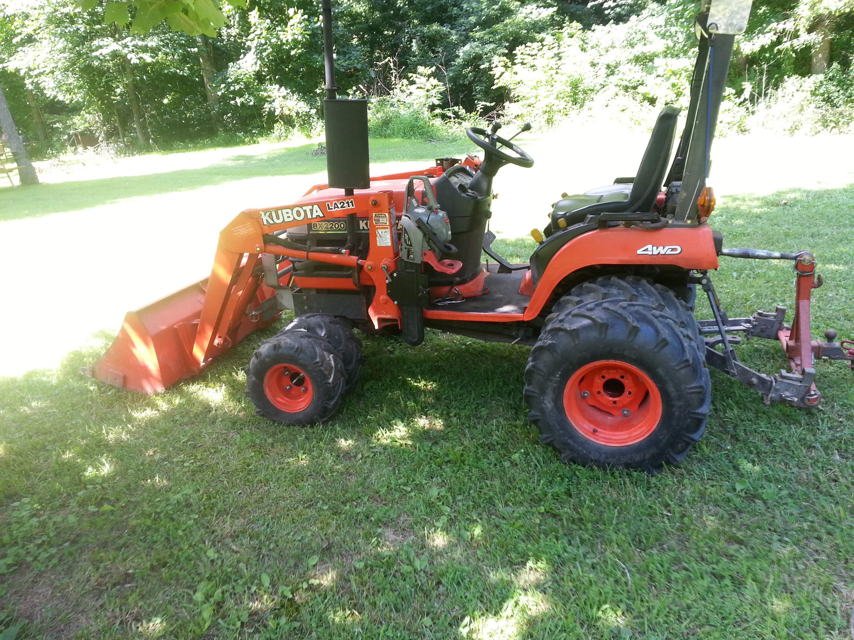

What's the story with the duals all around and is there a thread on it? How did this happen? It really looks great and I'll bet you could float anywhere with those on. Any problems that weren't expected?
