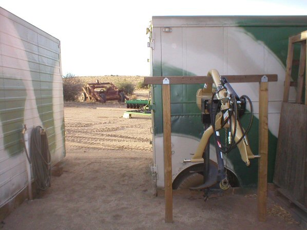

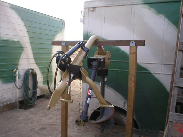

I am only a weekend warrior and after I had 3 of 4 holes that needed soaking, I invested in a hydraulic down pressure kit. I just don't have the time to waste on trying to dig holes. When I need a hole dug, it needs to be dug now, not in a few hours or even the next day.
Tell us where you got your down pressure kit and, if possible, post a picture of your setup. You can't keep good information like this to yourself.:D
/ Hole digger won't dig- ? #35
I have a Land Pride PD35 post hole digger and bought the Land Pride Hydraulic down pressure kit. here's a couple of pictures.

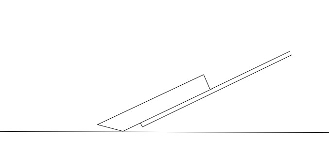

To add to this old but still useful thread, check the angle of the cutting edge.
Here is a diagram of one I examined in a store. The angle was wrong for that auger. This would be a dirt polisher on hard ground.
Bruce
