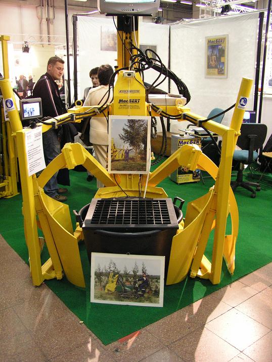

I saw dedicated hoe on agfair a week ago.
Maybe you're looking for this one?
