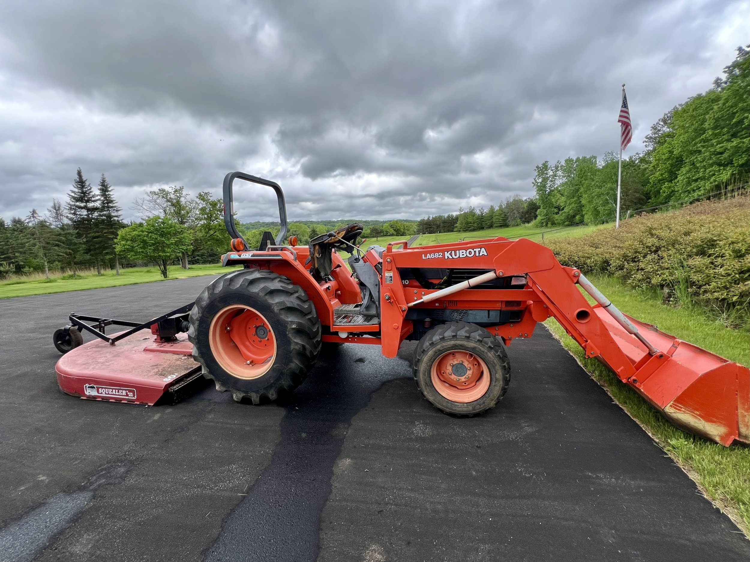

1
Kubota 3710
We are looking to replace an older Kubota 3710 for our 40 acre hobby farm (photo below) with another used tractor. We use the bucket a lot, cultivator and mowing deck attachments (for pastures and gardens), but hooking them up to the PTO is a real pain. Looking for advice on replacement tractor. The mid-mounted permanent mower decks sound great but then you sacrifice ground clearance. I don't pretend to be mechanically gifted and appreciate any advice.

Is the PTO or the 3ph the real issue? I see the L3710 came with and without the extendable 3pt arm ends. Our Ford has a version of them, and it's a big improvement over rigid ones. If I did a lot of changing, I'd check out the Pat's quick connects.
If it's really the PTO, you're pretty much stuck with the collar style or the pin style. Just have to keep everything clean.
I don't think you want a mid-mount mower, and not many L Kubota's have mid-PTO, only the grand L's I think.
If you're looking for a little larger tractor, the MX's look like a good utility size.

Like others wrote, if the hooking up of the PTO is the main problem look at quick hitch solutions.
Buying used tractors is often a "pig in a poke". And if your going same size or larger DEF can be a problem.
I'd suggest look at:
1. Your method/location of implement storage and hook up. If you unhook/hookup with your implement on the ground it's a royal pain.
When I got my B7610 w/ Box Blade (BB) I had to drop the BB in the grass, and moving it was a pain in the ###. And that's a small BB. I learned to drop it on a piece of plywood so I could skid it around. I've since graduated to concrete floors with implements on furniture dollies.
Two $10 HF dollys supporting pallets (gotten free from the lumber yard) on a concrete floor make it easy to slide my 5' bush hog, or my BB, or my tiller around. (I use 3 dollies for my Jinma 800lb chipper and my 900lb backhoe.)
2. How your PTO hooks up tractor to pto shaft
I there are different type types of tractor to PTO shaft hook ups, some have a collar, some have a pin (and the darn shaft seems to get heavier every year since I passed 70). Know the type you have, jury rig something to support the shaft at about the correct height.
AND
There are advancements in PTO hookups like Tractor PTO Link where you hook on an adapter.
Like others mentioned take a look at your 3-pt arms - extendables are a big plus.
There are many you-tube videos to show easier ways to hook up a 3pt, it's a fact of life. Some even goe Euro style.
And while your at it with the money you save over getting another tractor replace the pin-on bucket with a quick attach system and add a grapple and/or pallet forks. :)
If the main problem with the 3710 is that hooking up the mower is a task, consider two used tractors - one with a loader and the other for mowing.
You already have one. The older 3710 is also a preferred pre-emssions vintage, and should be good for a few decades yet.
For example, you could remove the 3710's loader and it woud become the mowing, 3pt, and PTO tractor.
It should last about forever in that duty.
Then for a new - used - tractor, I would look for a new loader tractor - probably something with a backhoe from Kubota's TLB line since you iike their products. Look at models like a B26, L39, or L48 -all TLBs with thumbs on the hoe which are handy for older folks. TLBs tend to be more stable and heavier built than ag tractors - though some used ones get used too hard. But that is true of anything.
We took that route and use the stong little backhoe much more for lifting and placing things than for digging - but it does that nicely too.
When buyng used, it all depends on being willng to pay the price for a good used one. But they are out there, and I remain convinced that people can successfully buy used. You will know it when you see it.

SFW could you explain why you want to sell this tractor? ie PTO connection, want cab, unreliable, ergonomics, etc?
I look at this tractor and see a perfectly good tractor.
If you are having issues with connecting the pto, are you keeping the "thumb button"/"locking collar" lubed up ?
Other members on other threads have had favourable things to say on the "GST" type gearbox, so you are not on a base model tractor.
Are you sure you can't make some upgrades and save a bunch of money? ie 3rd service loader(if not already got), quick hitch for 3ph, more rear SCVs if needed, possibley a rops canopy, etc
What is your budget?
