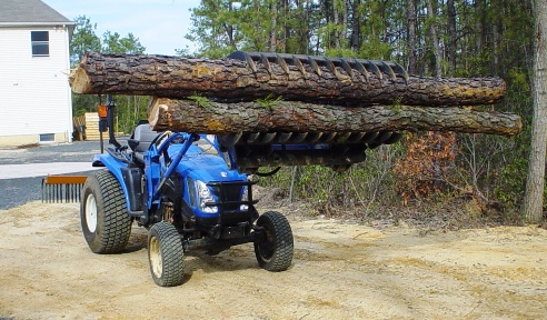

I have the same tractor you do and my turf tires have always worked well for me unless I overloaded the bucket and then they flexed a lot. However, last summer I was moving a lot of 3-4" trap rock and with the bucket fully loaded, it really beat up those poor turf tires.
So I called my dealer and he checked and said exactly what dealer #2 had suggested to you. Replace the Titan Trac C/S 24x8.50-14 turf tires with Titan Trac loader 25x8.50-14 R4's.
He said they would'nt make a difference in the real world and I completely agree, I keep the tractor in auto 4wd and it drives as normal. No difference either plowing this past winter. However, they really made a big difference driving over that trap rock...very sturdy and no flex. Also, they don't clog with mud the way turf's do.
I ended up mounting them on new rims so I could keep the turfs as spares or if I want to switch back if I ever mow.
Obviously, the pic is b4 I switched, as you can see there is no flex in the turf's even with some pretty big weight up front. Imagine how tough the r4's are. Don't have filled rear's either but always been stable.
Rich

Rich,
Glad to here the Titan Trac Loader tires work well for you. I load my bucket pretty well, not heaped but full and since the dirt has high clay content it’s probably on the heavy side. I want to reduce the flex and the R4’s are the ticket.
I am surprised to see so little flex in the attached picture. What air pressure did you keep in the turfs? How about the R4’s?
Before I had my rears filled there were times that I would teeter on uneven ground since the rear was light. Big pucker factor there. Filling the rears and using a 500# box blade has eliminated that. Now to stiffen the front.
Thanks…Derek

I generally keep the tires at their max pressure. The R4's run at 50 psi but I don't remember off hand what the turf's are rated for.
