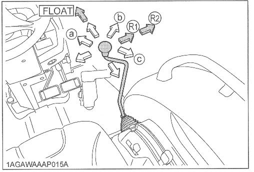

I'll be trying to verify this tomorrow morning, but I may have discovered the slow lift/ lower FEL "issue" (with no rollback/ un-curl speed issues); I more thoroughly read the loader's manual while here at work today & found: "This control valve has two dump stage positions. The first dump position by moving the lever to the right features greater speed for dumping. The second dump position (to further right) is the "Regular" dump position. It has good power and control for dumping precisely. This position should be used when operating another implement with this control valve. These two positions are separated by a "Feel" position for your convenience."
Next page: "When taking off hydraulic power from port [D], the flow rate can be adjusted in two stages with the lever. The flow rate is high at position (R1) (which of course is the loader control's un-curl direction) and low at position (R2) (same direction, to the right, just further). Move the lever to position (R1) or (R2) depending on the attachment in use."
In my OP I said "curling" and/ or "un-curling" seemed to fix the slowness problem ... I bet I was unknowingly/ unintentionally putting it back into the higher speed mode when doing that.
Diagram from loader manual:
attachment.php
Yes I am a tractor noob :eek: ... Hopefully this will help somebody else.

As I understand it, one position (I think the R1, but forget) is the re-generative position and it uses the oil flowing out of the curl cylinder to be routed back to the "in" side of the cylinder to some degree giving more precision for the dump function. The second position (R2) opens the circuit and lets the escaping fluid flow back to the tank resulting in a fast dump function. At least that's what I recall the difference between the two positions to be. I'm sure someone more expert in hydraulic circuits could explain it better. Glad you found your problem and it's not a defect in your new tractor.

No luck after all. My post above did not turn out to solve the problem.
That whole description only results in the dump speed of the bucket going fast when pushing the controller lightly to the right, & slower when you push it further.
