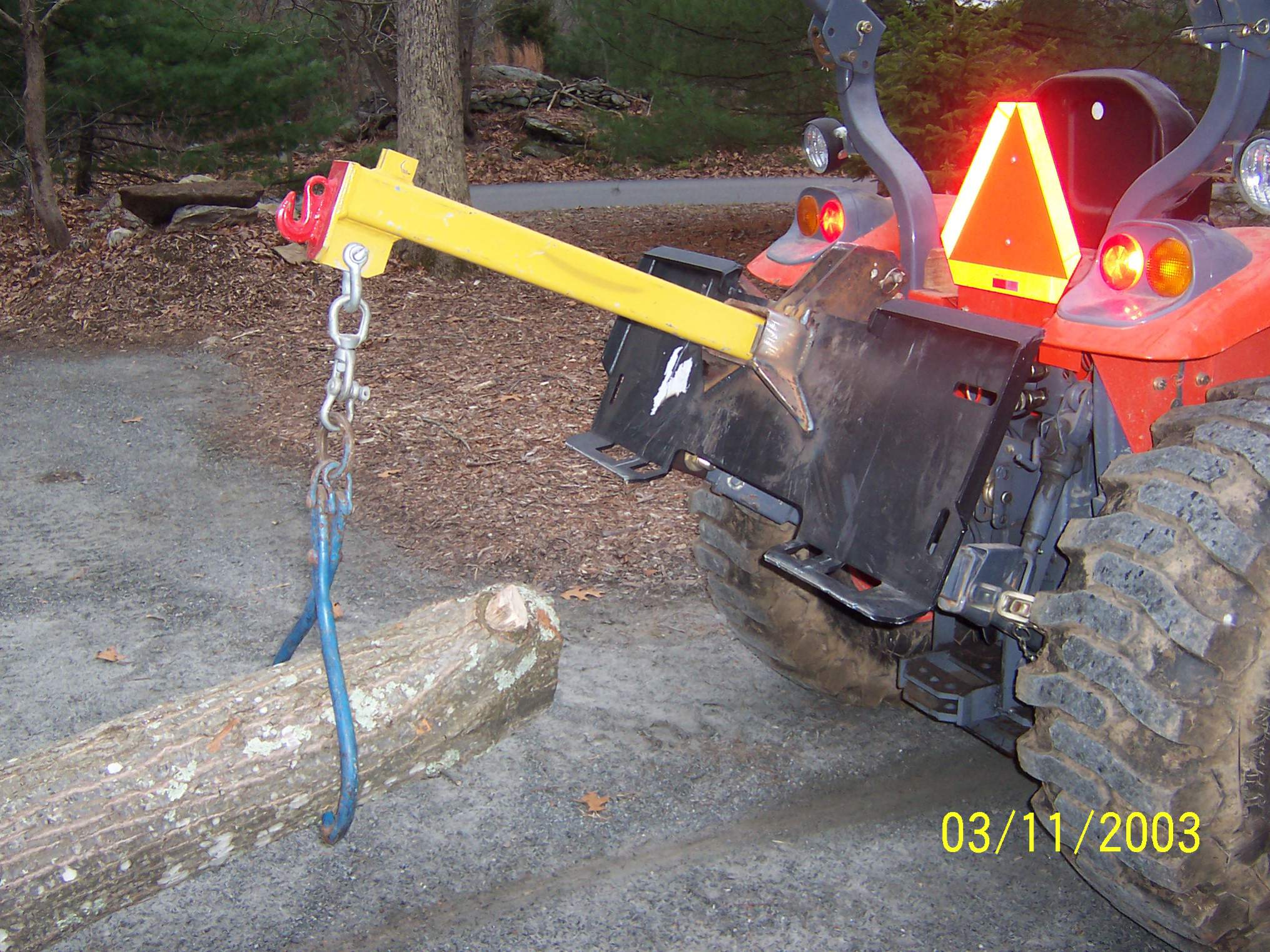

When we bought our Kioti it didn't have the quick attach and we used it for 3 years with clamp on forks on the bucket. This year we decided to switch it over to the quick attach and it is soooo much easier to switch back and forth from bucket to forks (we bought a real set of forks). It takes about 1 minute to do it plus we bought a quick attach plate and made an attachment for a boom & tongs to skid logs that can be used with the front bucket or the 3 pt hitch. Here's a picture of it in the 3 pt hitch position.

kiotijoe
That is one neat set up for skidding logs. Was that a regular Q A plate or one just for the rear arms? looks like clearance could be an issue in some cases. :thumbsup:
/ Hitches What Do You Think? #6
Yes Short Kid, it is a regular rectangular QA plate that we adapted to be able to be hooked on the 3 pt hitch. The boom is pinned so you can mount it on the front loader arms with the plate and re-pin the boom facing front. What do you think is going to cause a clearance issue?
